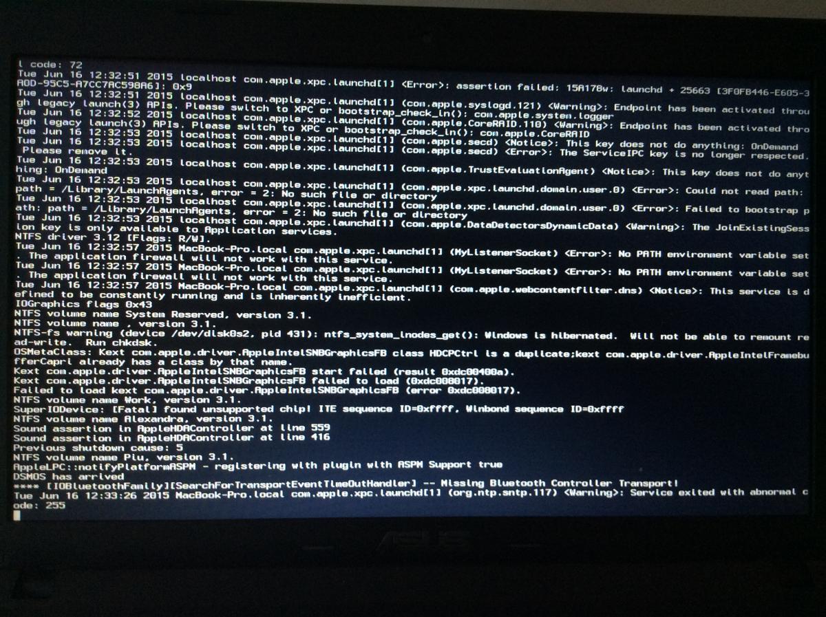

Kaya80 Posted June 16, 2015 Author Share Posted June 16, 2015 What kind of installation method do u use?how do you prepare usb and what version of Yosemite are you trying to install? I use a retail 10.10.3 without anyproblem....at first boot for installation, try to add bootflag npci=0x3000 -v PCIRootUID=1, for me this works and let me reach the installation menu Link to comment https://www.insanelymac.com/forum/topic/306336-from-chameleon-to-clover-on-asus-x55c/page/2/#findComment-2145562 Share on other sites More sharing options...
rvxtm Posted June 16, 2015 Share Posted June 16, 2015 I format usb as guid HFS+ , restore the sharedsupport SystemBase.dmg inside InstallESD.dmg image to the stick, remove the Packages shortcut from System/Install on the USB, and paste in the folder real folder from the root of InstallESD.dmg, on the root of the usb i also paste the SystemBase.dmg and chunklist file. After this, i install clover with uefi only on the stick, paste the FakeSMC in 10.10 folder kexts and use a config for macbook pro (your config actually last time) , i did not use npci=0x3000 amd PCIRootUID=1. I will try agian. Thank you. I've been doing this ever since 10.8 - 10.9, on my main PC it is working great. Update, tried with 10.11, stick works on PC, on laptop with MacBook config, i get graphics errors. Link to comment https://www.insanelymac.com/forum/topic/306336-from-chameleon-to-clover-on-asus-x55c/page/2/#findComment-2145570 Share on other sites More sharing options...
