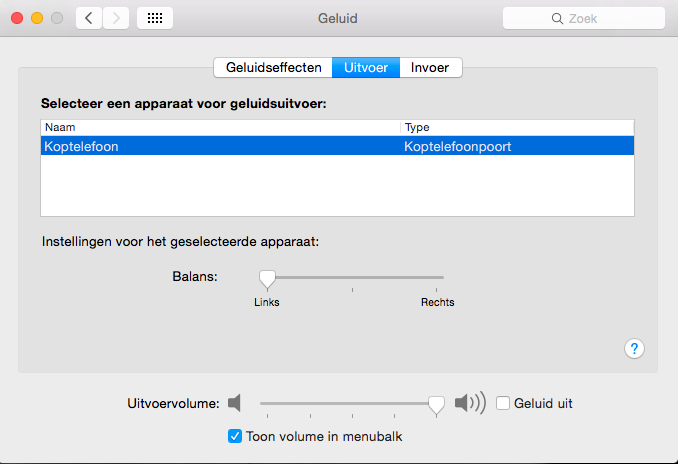

WaldMeister Posted May 12, 2015 Share Posted May 12, 2015 Hi, On the Toshiba in the signature, i have a patched AppleHDA for the Conexant CX20751/2. I used Mirone's AppleHDA patcher with the following files: CX20751.zip In the patcher application itself, i have replaced the AppleHDA with the version from 10.10.3, and installed the created kext from the desktop. Now everything is working correctly, except today i noticed that when i plug in my headset the sound is malformed. I need to set the slider to either left or right in the system preferences, to get correct sound output on both headset speakers. (The sound will not change to the left or right speaker, it's just corrected.) As seen in the picture: Anyone any idea how to fix this? Does it have something to do with the lay-out or pinconfig, or can this be fixed an easy way? Link to comment https://www.insanelymac.com/forum/topic/306132-headset-sound-output-malformed/ Share on other sites More sharing options...
WaldMeister Posted May 13, 2015 Author Share Posted May 13, 2015 Problem is also present in Windows and Ubuntu, tested today. Going to replace the 3,5 jack cable. Topic can be closed. Link to comment https://www.insanelymac.com/forum/topic/306132-headset-sound-output-malformed/#findComment-2135142 Share on other sites More sharing options...
