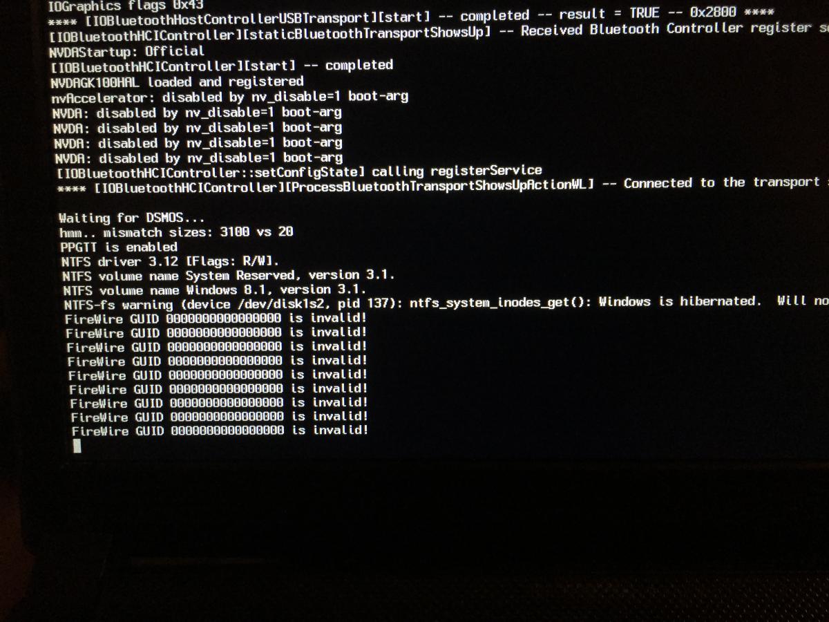

heathbm Posted April 11, 2015 Share Posted April 11, 2015 Just installed Clover followed instructions and have done it many times before however I have never seen this, why is it getting stuck when talking about my windows drive? (It's on a separate SSD). Link to comment https://www.insanelymac.com/forum/topic/305613-cant-boot-anymore-help/ Share on other sites More sharing options...
Gringo Vermelho Posted April 11, 2015 Share Posted April 11, 2015 It's saying that it won't mount the Windows drive because Windows is hibernated, which of course makes perfect sense. That's not a problem unless of course you need something on that drive. Un-hibernate Windows and reboot. There are fixes for the Firewire GUID message, for now just disable Firewire in the BIOS to see if that message is blocking some other error message. But just like the other message, it shouldn't prevent you from booting though. I think the important one is the "mismatch" message after Waiting for DSMOS. I've never seen that before. Make sure you have a reasonably new version of fakesmc.kext. Link to comment https://www.insanelymac.com/forum/topic/305613-cant-boot-anymore-help/#findComment-2127225 Share on other sites More sharing options...
