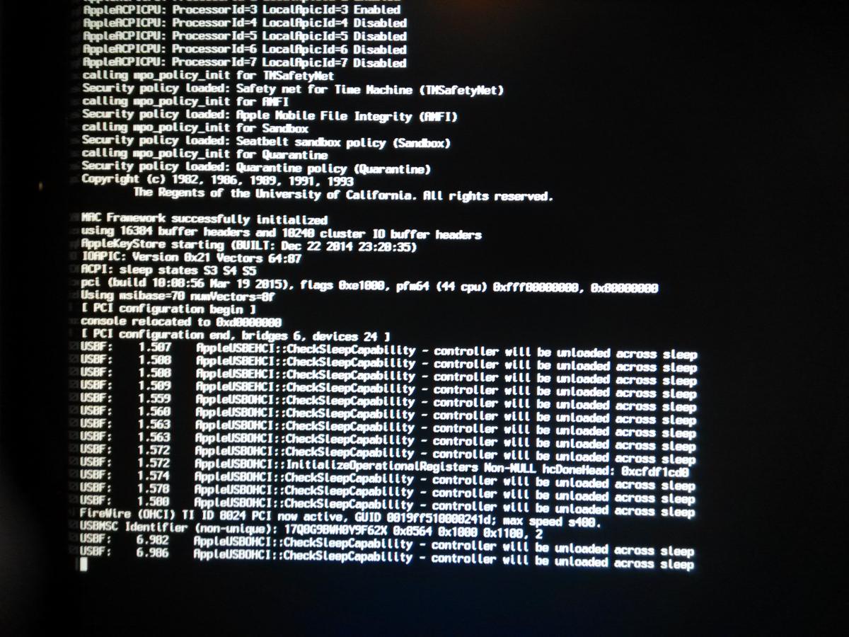

-Tex- Posted March 29, 2015 Author Share Posted March 29, 2015 I can't boot with RTC_legacy stuck on USBF: I found patch that disables all cmos writes from AppleRTC for mac os x 10.9 This works for me on 10.9 Mavericks: perl -pi -e 's|\x41\x89\xd7\x41\x89\xf4|\xe9\xb8\x00\x00\x00\x90|;' /System/Library/Extensions/AppleRTC.kext/Contents/MacOS/AppleRTC Verify your source file before patching: md5 AppleRTC MD5 (AppleRTC) = 4b1d28ac48a2a7b35ed6b2034e0fd912 This patch completely disables all CMOS writes from AppleRTC Look for analogue for yosemite Link to comment https://www.insanelymac.com/forum/topic/305360-no-sound-and-cmos-issues/#findComment-2124133 Share on other sites More sharing options...
