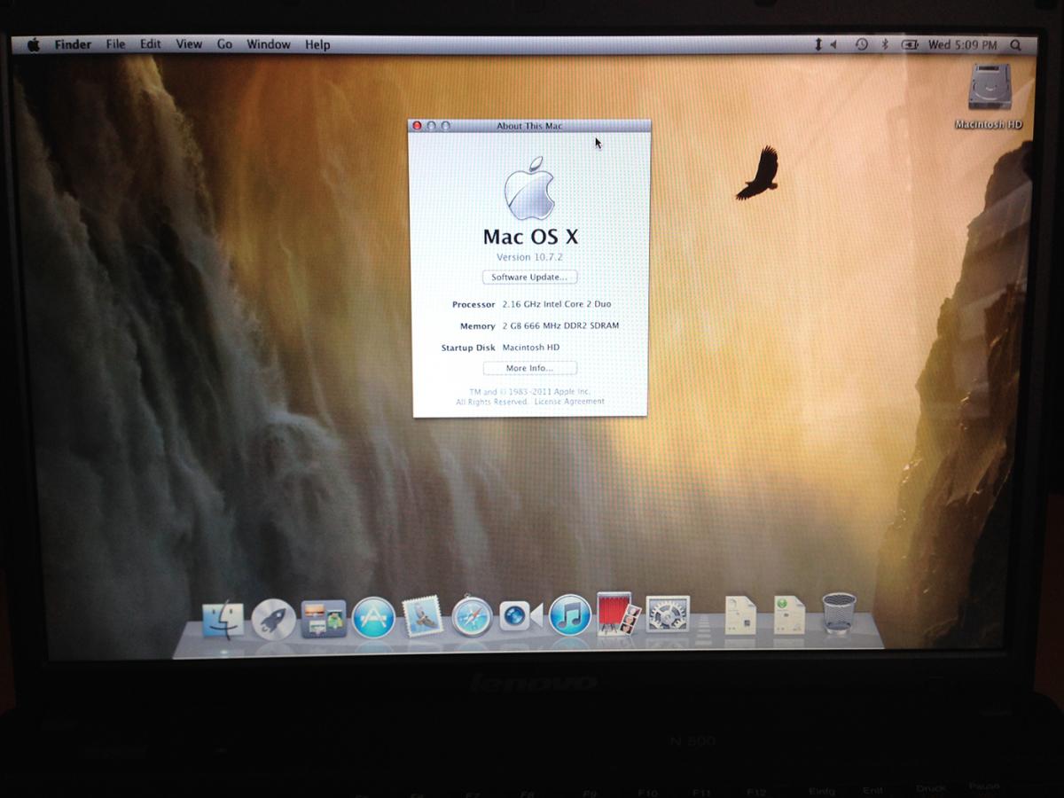

GordenFreemant Posted March 25, 2015 Share Posted March 25, 2015 I just successfully installed 10.7.2 on my trusty old Lenovo N500, but I can't get OS X to play nice with the laptop's components. After an hour of fiddling with kexts, I got the keyboard and trackpad working mostly, but things like sound, microphone, Wi-Fi, Bluetooth, and proper trackpad support are still not working. I used iATKOS L2 from this site (http://www.uphuck.org/viewtopic.php?f=73&t=18827) after burning it to a DVD. The hardware specs of my laptop are, as far as I can tell, as follows: a 2.16 GHz Intel Core 2 Duo CPU (as seen in the photo) 2 GB of slow-ass RAM (also in the photo) Some Broadcom Bluetooth thingy. System Information.app displays a bunch of info but I still can't toggle BT in the system. An SD card reader in the front that OS X doesn't recognize An Intel GMA X3100 graphics chip that OS X apparently doesn't utilize, I get horrible screen tearing here An ethernet port, even though OS X denies that this laptop has any ethernet cards installed (I might be wrong, but the ethernet port is still there) The Wi-Fi thingy in the laptop is an "Intel WiFi Link 5100". If there's no way of getting this to work, I also have a Broadcom Wi-Fi USB dongle I could use. I still have the iATKOS L2 DVD here, is there anything I missed during the installation? And what do I need to do after the installation to make all the aforementioned things work? Link to comment https://www.insanelymac.com/forum/topic/305305-installed-1072-on-lenovo-n500-need-help-making-it-work-correctly/ Share on other sites More sharing options...
HUSABER Posted March 25, 2015 Share Posted March 25, 2015 I just successfully installed 10.7.2 on my trusty old Lenovo N500, but I can't get OS X to play nice with the laptop's components. After an hour of fiddling with kexts, I got the keyboard and trackpad working mostly, but things like sound, microphone, Wi-Fi, Bluetooth, and proper trackpad support are still not working. I used iATKOS L2 from this site (http://www.uphuck.org/viewtopic.php?f=73&t=18827) after burning it to a DVD. The hardware specs of my laptop are, as far as I can tell, as follows: a 2.16 GHz Intel Core 2 Duo CPU (as seen in the photo) 2 GB of slow-ass RAM (also in the photo) Some Broadcom Bluetooth thingy. System Information.app displays a bunch of info but I still can't toggle BT in the system. An SD card reader in the front that OS X doesn't recognize An Intel GMA X3100 graphics chip that OS X apparently doesn't utilize, I get horrible screen tearing here An ethernet port, even though OS X denies that this laptop has any ethernet cards installed (I might be wrong, but the ethernet port is still there) The Wi-Fi thingy in the laptop is an "Intel WiFi Link 5100". If there's no way of getting this to work, I also have a Broadcom Wi-Fi USB dongle I could use. I still have the iATKOS L2 DVD here, is there anything I missed during the installation? And what do I need to do after the installation to make all the aforementioned things work? 1 cpu is ok 2 ram is ok(2GB) 3 Search for bluetooth driver later 4 Search for SD card driver later 5 Intel GMA X3100 work only on 32bit Lion(me use verry well on T61) 6 Etherneth work perfectly with Intel82566MM.kext 7 WiFi intel 5100 newer work,you need to patch your BIOS without whitelist,and replace WIFI card with Atheros or Broadcom WELCOME HERE Link to comment https://www.insanelymac.com/forum/topic/305305-installed-1072-on-lenovo-n500-need-help-making-it-work-correctly/#findComment-2123006 Share on other sites More sharing options...
