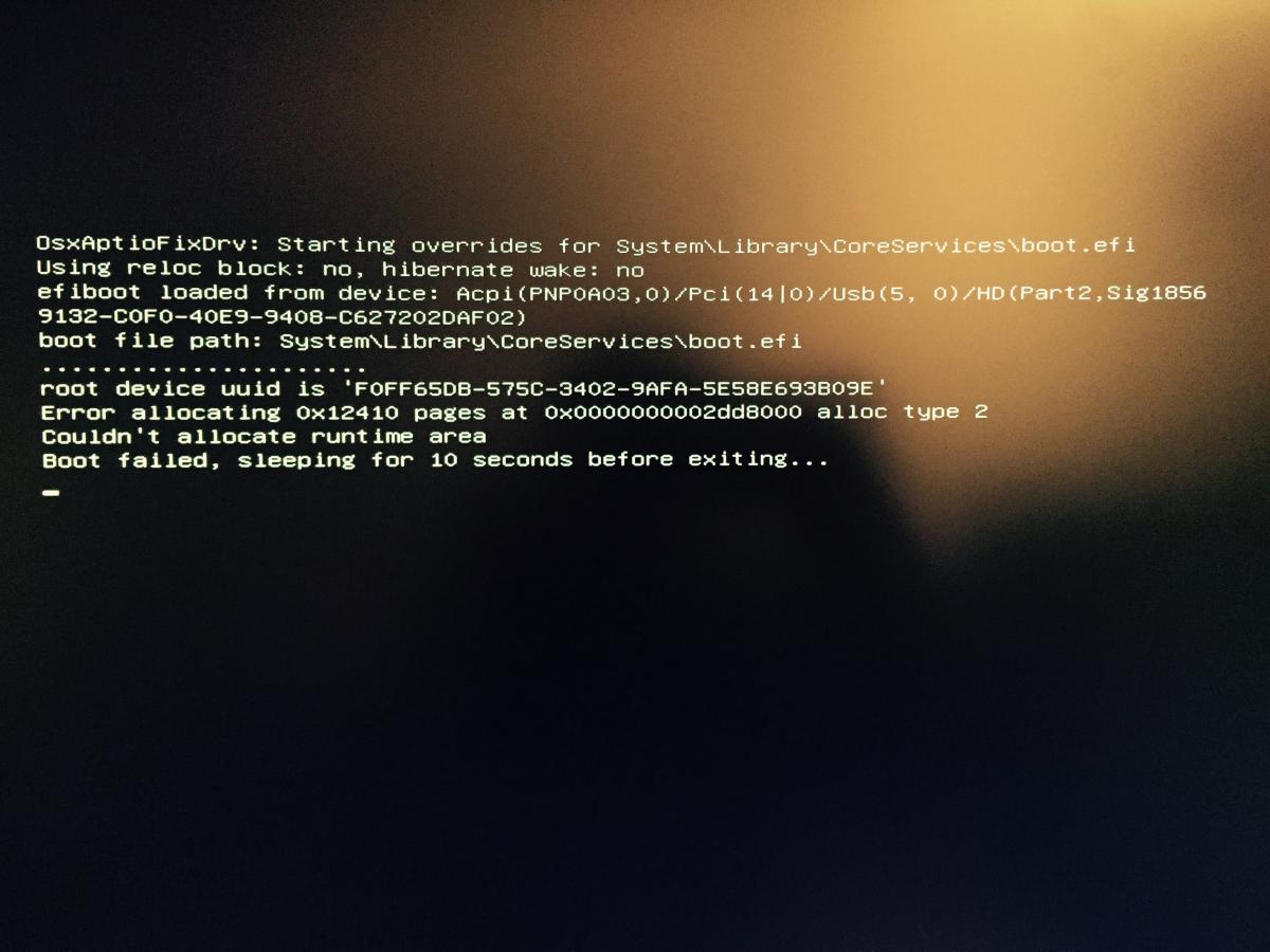

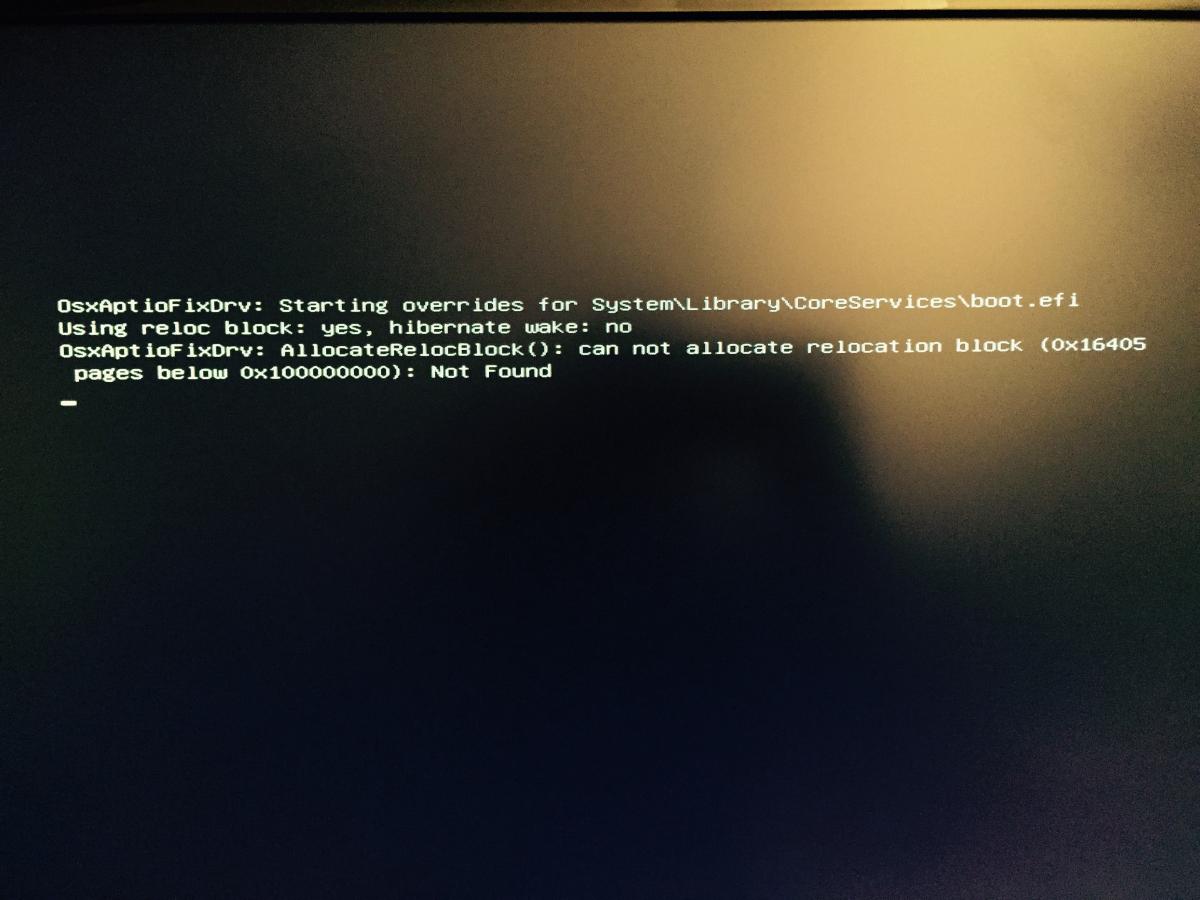

cool_recep Posted January 2, 2015 Share Posted January 2, 2015 Hi, I am trying to install Yosemite on a Haswell-E System with following specs: 5960X Rampage V Extreme 16 GB RAM GTX 980 6 TB HDD RevoDrive PCIe SSD (Won't use for install) 4K panel via DP I could not get past the OsxAptioFix memory allocation part. I have tried: slide=0 Disabling CSM Using latest Clover Using OsxAptioFix2 Patched kernel Safe Mode cpus=1 Rampagedev Kexts Rampagedev Config BIOS: 0901 Legacy mode: Stuck at root device UUID Nothing worked. Errors: Thank you for your help. Link to comment https://www.insanelymac.com/forum/topic/303709-5960x-rampage-v-extreme-osxaptiofix-problem/ Share on other sites More sharing options...

jamiethemorris Posted January 3, 2015 Share Posted January 3, 2015 To clarify, he is referring to the error you get using legacy mode. It sounds like you need to use legacy mode. The other error is from using uefi. Link to comment https://www.insanelymac.com/forum/topic/303709-5960x-rampage-v-extreme-osxaptiofix-problem/#findComment-2100044 Share on other sites More sharing options...
cool_recep Posted January 3, 2015 Author Share Posted January 3, 2015 I guess you missed the introduction to my Installation Guide: Well, my hackintosh supports UEFI Booting. And I have diabled CSM completely. But yet again, I was stuck at OsxAptioFix. To clarify, he is referring to the error you get using legacy mode. It sounds like you need to use legacy mode. The other error is from using uefi. I have already told that I have used legacy mode and got stuck at root device UUID... Link to comment https://www.insanelymac.com/forum/topic/303709-5960x-rampage-v-extreme-osxaptiofix-problem/#findComment-2100107 Share on other sites More sharing options...

jamiethemorris Posted January 4, 2015 Share Posted January 4, 2015 Clover has never had an option to patch kernels on the fly, aside from the built-in options such as the kernelpm (early reboot) patch. Root Device UUID errror = can't load the kernel AptioFixDrv error = need to use legacy boot. Even though your system supports UEFI, Clover is having trouble with UEFI installations on some X99 boards. This is my understanding of it (Rampage Dev, correct me if I'm wrong): Booting a patched kernel with an installation USB vs. an existing installation is different. The problem is that you can't boot the Yosemite installer on a computer that requires a patched kernel to boot (unless it is one of the built-in options). In previous versions of OS X, you could simply replace the kernel in the installer with a patched one. With Yosemite, it is now only possible to replace the kernel once the system is installed. The obvious solution would be to just "inject" the kernel, meaning load the patched kernel from say, the root of the drive or something. This isn't currently working in Yosemite. So the only way to install it is from another computer, and then afterwards replace the kernel with the patched one. If you don't have a real Mac, my suggestion is to either borrow a friend's for the installation process or stick with Mavericks until this is resolved (EDIT: sorry, I see you have a GTX 980 so I guess Mavericks is not an option). Disappointing to hear the RVE is only working with Legacy Clover, this is the board I was looking into for my next build. Link to comment https://www.insanelymac.com/forum/topic/303709-5960x-rampage-v-extreme-osxaptiofix-problem/#findComment-2100430 Share on other sites More sharing options...
Rampage Dev Posted January 4, 2015 Share Posted January 4, 2015 Here is the issue with 10.10: With Apples changes to compression and where and how the Kernel is used. The issue is the prelinked kernel that can not be changed. That said you can install 10.9 with a modded kernel without issues. More technical information can be found here: http://sourceforge.net/p/cloverefiboot/tickets/97/ Link to comment https://www.insanelymac.com/forum/topic/303709-5960x-rampage-v-extreme-osxaptiofix-problem/#findComment-2100457 Share on other sites More sharing options...

garry__ Posted January 5, 2015 Share Posted January 5, 2015 I had this issue and I solved it by going into my EFI partition and navigating to "/EFI/EFI/CLOVER/drivers64UEFI/" and deleting (or just save it in case this doesn't help you) "OsxAptioFix.efi" and replacing it with "OsxAptioFix2Drv.efi". I've attached it for you to try out. You'll need a way to access the EFI partition and modify the files. I used a Macbook Air and connected my SSD via USB. AptioFix2Test3.zip Link to comment https://www.insanelymac.com/forum/topic/303709-5960x-rampage-v-extreme-osxaptiofix-problem/#findComment-2100755 Share on other sites More sharing options...
