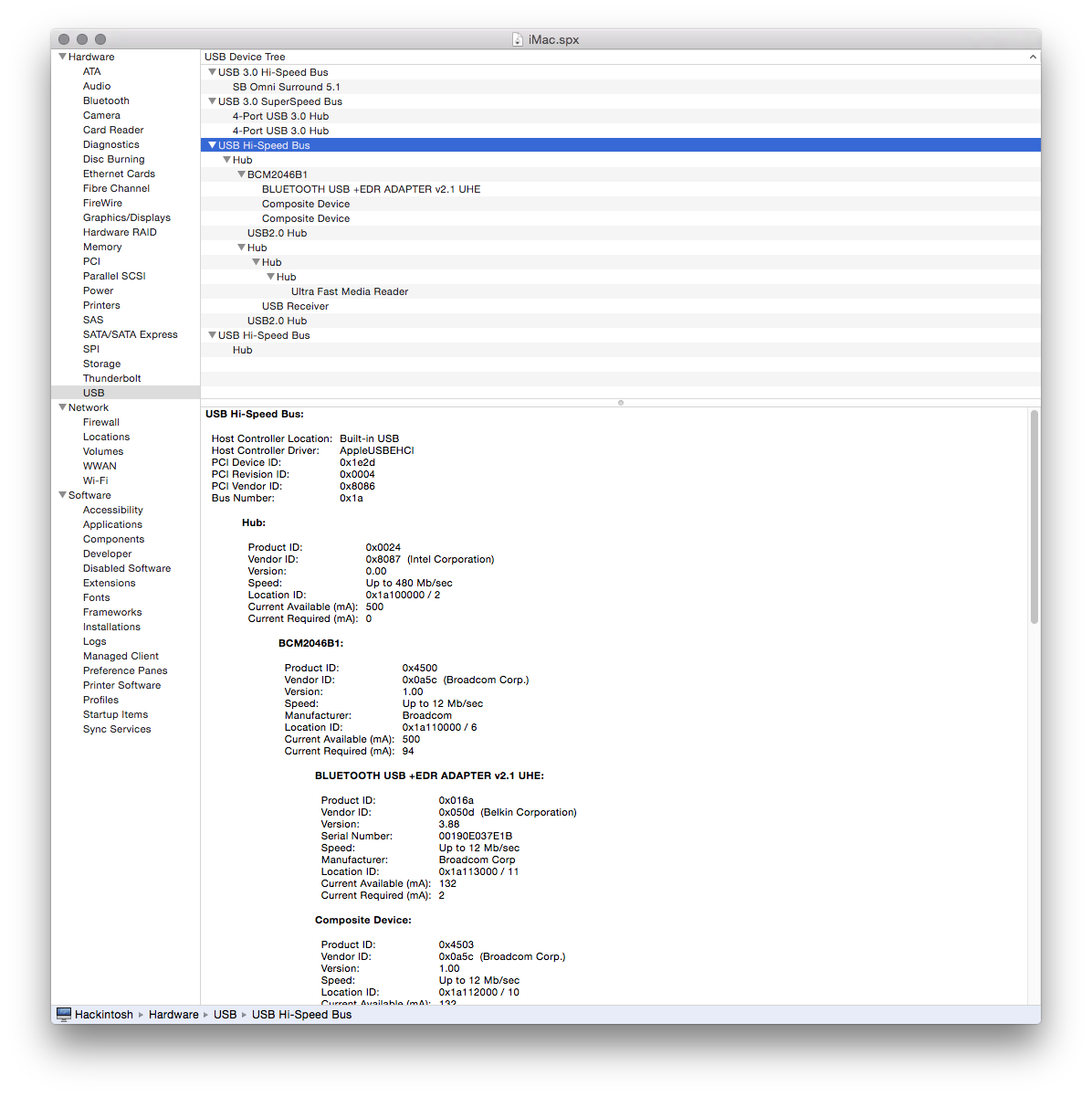

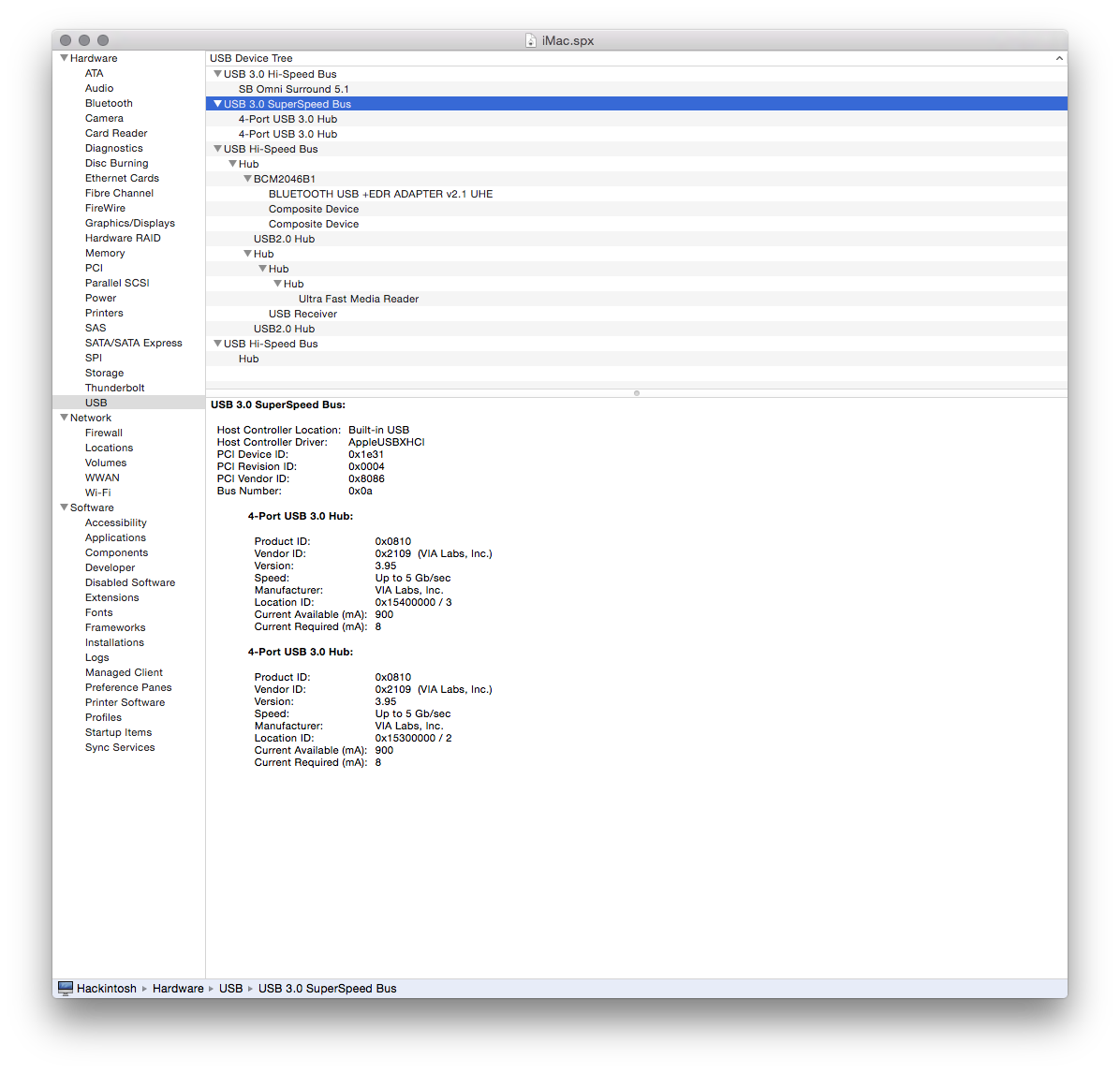

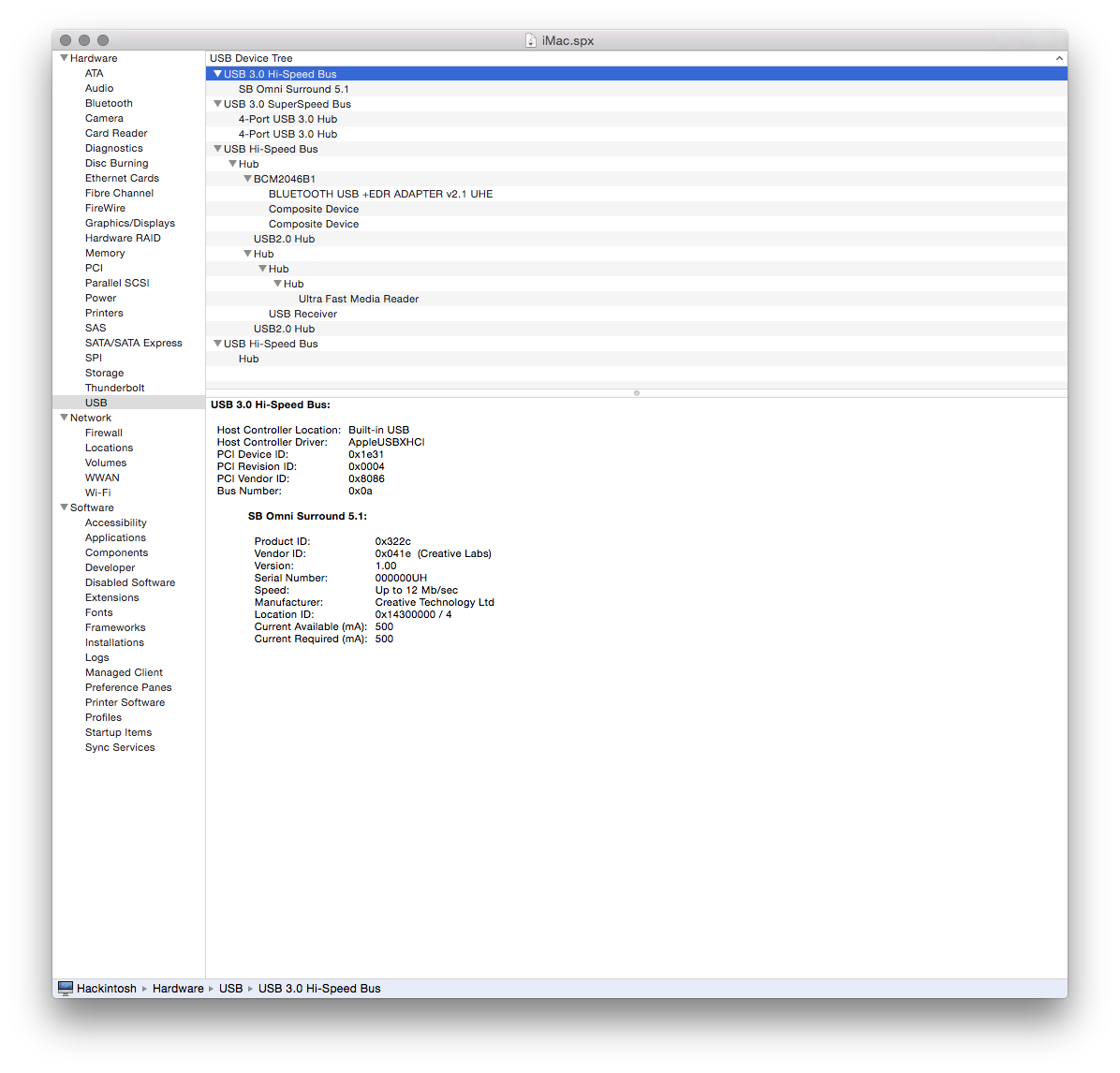

Included is a zip file with my Clover bootlog.log.txt, Clover config.plist, DSDT and SSDT.  Also attached are 4 screen shots of the 4 USB root device trees.
Please note: at the time these files were generated, I did not have the DSDT file loaded.
