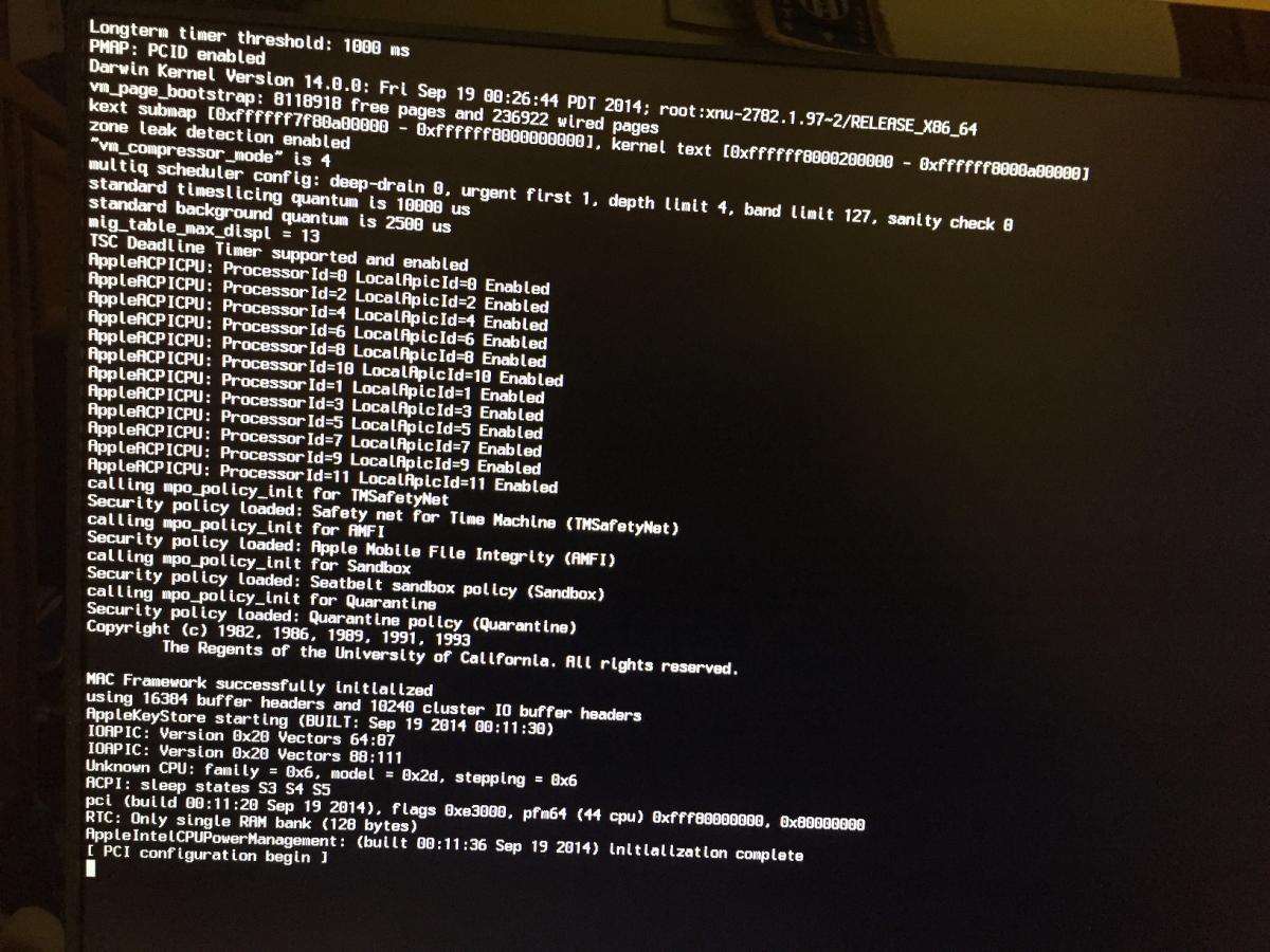

klaus1636 Posted December 10, 2014 Author Share Posted December 10, 2014 non so se l'ha caricata ma basta trascinarla dentro? l'ho fatta con l'iphone Link to comment https://www.insanelymac.com/forum/topic/303228-aiuto-yosemite-su-asus-sabertooth-x79/#findComment-2093775 Share on other sites More sharing options...

klaus1636 Posted December 10, 2014 Author Share Posted December 10, 2014 ok credo sia leggibile Link to comment https://www.insanelymac.com/forum/topic/303228-aiuto-yosemite-su-asus-sabertooth-x79/#findComment-2093786 Share on other sites More sharing options...
carbo178 Posted December 10, 2014 Share Posted December 10, 2014 Bene, ora al boot vai sull'icona ingranaggio (options), premi enter, scegli boot-args, premi enter e scrivi -v npci=0x2000 poi premi enter, scendi fino a return, scegli pandora installer e di nuovo enter Link to comment https://www.insanelymac.com/forum/topic/303228-aiuto-yosemite-su-asus-sabertooth-x79/#findComment-2093790 Share on other sites More sharing options...
