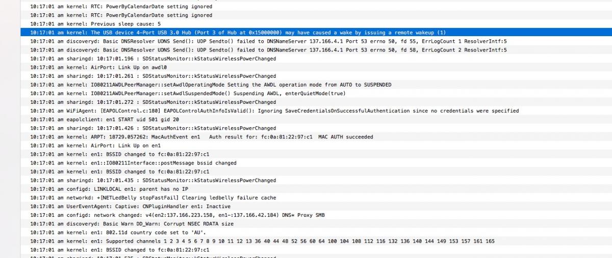

wolfie81 Posted October 7, 2014 Share Posted October 7, 2014 I have had this problem for weeks. Just don't know what to do as Im new to Clover and trying to read and experiment with settings. My computer sleep/wakes great with through bluetooth keyboard IF left to sleep for a few short hours. Anything longer than a few hours of sleep (like every night while I'm sleeping) the computer wakes itself (but not the screen) then about a minute later goes back to sleep. The issue is when this happens, the next morning I can't activate/wake my computer with bluetooth and I have to switch off the computer and reboot. Ive found a common pattern emerging in my console which also says APPLE RTC (wake alarm) and specifically a note about bluetooth (pleas see attached console file). Please tell me what to do, my sig is below (my bluetooth module is the latest Apple BCM94360. As its native it shouldn't be a issue. Note: In energy saver I have 'wake for network access' UNCHECKED. Link to comment https://www.insanelymac.com/forum/topic/301343-my-final-achillies-heel-problem-computer-wakes-up-in-middle-of-night-console-included/ Share on other sites More sharing options...

wolfie81 Posted October 10, 2014 Author Share Posted October 10, 2014 Last night the computer was going pretty crazy around 240am. It kept sleeping and waking up minutes apart.Ive included a full log for anyone that can really work it out. At 840am I woke it up by recycling power through the PC. All Messages.txt Link to comment https://www.insanelymac.com/forum/topic/301343-my-final-achillies-heel-problem-computer-wakes-up-in-middle-of-night-console-included/#findComment-2068215 Share on other sites More sharing options...
wolfie81 Posted October 16, 2014 Author Share Posted October 16, 2014 Ok, I'm slowly starting to narrow this down somehow. During the day.... my computer sleeps and wakes up fine (even after sleep has occurred for most of the day). However, ONLY at 220am every night does my machine wakeup, do something then go back to sleep only to wake up again immediately after. Sessionally it sleeps/wakes every minute from 220am onwards. Really strange behaviour. Link to comment https://www.insanelymac.com/forum/topic/301343-my-final-achillies-heel-problem-computer-wakes-up-in-middle-of-night-console-included/#findComment-2069956 Share on other sites More sharing options...
