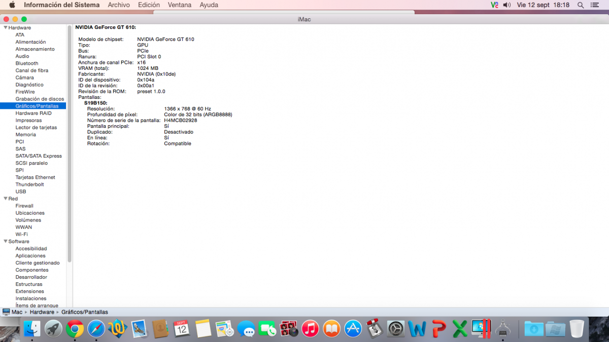

Derek12 Posted September 12, 2014 Author Share Posted September 12, 2014 Finally I will get the GT610, still low end but more powerful than the 5450. Does it work on Hackintosh OOTB? I answer myself, yes it works OOTB lol Link to comment https://www.insanelymac.com/forum/topic/300563-asus-r7-240/#findComment-2060069 Share on other sites More sharing options...
vusun123 Posted September 12, 2014 Share Posted September 12, 2014 Too bad you can't stick to Radeon GPU. It's fun although it can be bitter sometimes Link to comment https://www.insanelymac.com/forum/topic/300563-asus-r7-240/#findComment-2060071 Share on other sites More sharing options...
Derek12 Posted September 12, 2014 Author Share Posted September 12, 2014 Too bad you can't stick to Radeon GPU. It's fun although it can be bitter sometimes Yeah I planned to buy it later this year but my 5450 died, my IGP doesn't work with OSX, and I had to buy a "emergency" card (the GT610), still it's way better than my previous 5450. I can finally play Wolfenstein the New Order without watching a slideshow lol . Fortunately it worked OOTB but I am detecting some issues on OSX (low performance, memory underclocked to 270MHz even on load, etc). I will post it later on Yos forum! Link to comment https://www.insanelymac.com/forum/topic/300563-asus-r7-240/#findComment-2060085 Share on other sites More sharing options...
vusun123 Posted September 13, 2014 Share Posted September 13, 2014 Low performance is AGPM's issue. See rampage dev's site for more 1 Link to comment https://www.insanelymac.com/forum/topic/300563-asus-r7-240/#findComment-2060209 Share on other sites More sharing options...
Derek12 Posted September 13, 2014 Author Share Posted September 13, 2014 Low performance is AGPM's issue. See rampage dev's site for more Thank you, I will check,In OSX, the GPU core clock scales correctly between low and high performance depending on load but Memory clock is stuck at 270 MHz (maybe sensor issue?), in Windows, it scales between 400 and 667. Link to comment https://www.insanelymac.com/forum/topic/300563-asus-r7-240/#findComment-2060265 Share on other sites More sharing options...
