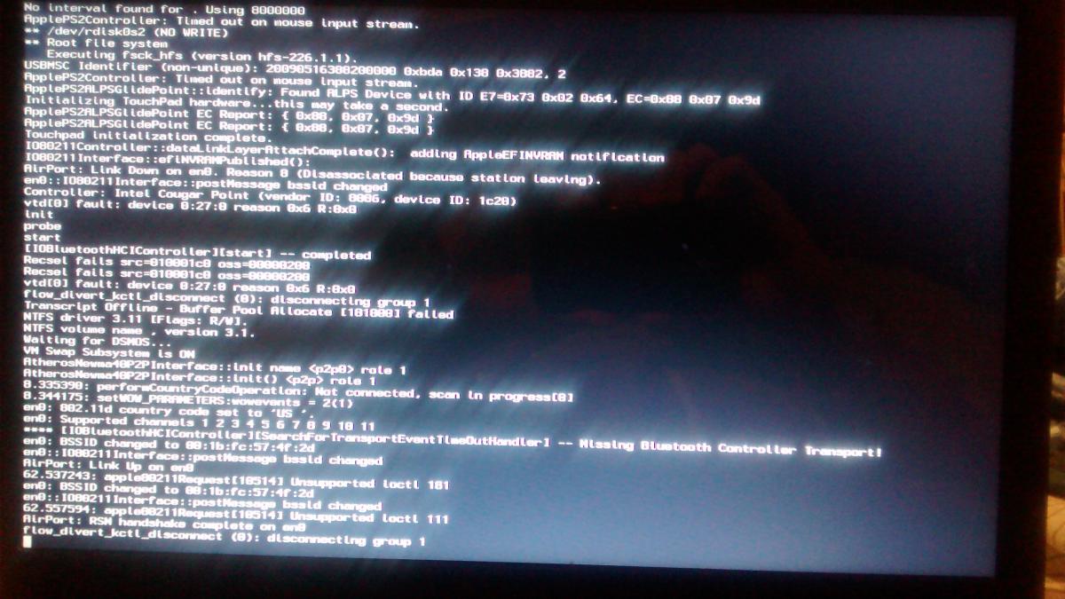

hydra1ysk Posted August 6, 2014 Share Posted August 6, 2014 Hi I have a problem after install mavericks. When i boot, the system freeze in the mac logo (after choose the SO). I try with a lot of flags -v -f -x ncpi=3000 GraphicsEnabler=no but always get the same error: flow_divert_kctl_disconnect (0) disconnecting group 1 Can you help me? Link to comment https://www.insanelymac.com/forum/topic/300095-flow_divert_kctl_disconnect-0/ Share on other sites More sharing options...
mendietinha Posted August 7, 2014 Share Posted August 7, 2014 something wrong with your fakesmc. Link to comment https://www.insanelymac.com/forum/topic/300095-flow_divert_kctl_disconnect-0/#findComment-2049231 Share on other sites More sharing options...

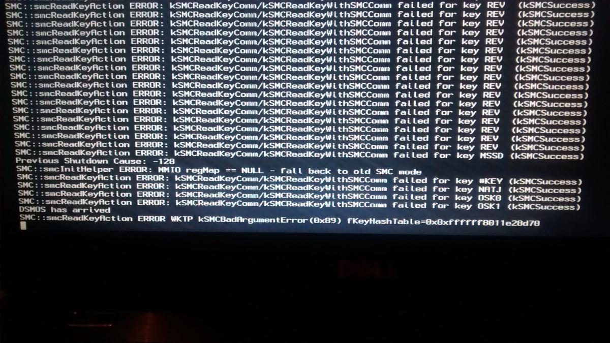

hydra1ysk Posted August 8, 2014 Author Share Posted August 8, 2014 something wrong with your fakesmc. Thanks for your reply. I install fakesmc, but now i get this KP. Maybe the problem is with my CPU, because is a ES (engineer sample). This could be the problem? Link to comment https://www.insanelymac.com/forum/topic/300095-flow_divert_kctl_disconnect-0/#findComment-2049826 Share on other sites More sharing options...
aphex6b Posted August 12, 2014 Share Posted August 12, 2014 looks like graphics card is unsupported or incorrectly configured. I see no KP in your screenshot above. At the stage the system is in at that point, the initialization is almost done, except for graphics. Link to comment https://www.insanelymac.com/forum/topic/300095-flow_divert_kctl_disconnect-0/#findComment-2051097 Share on other sites More sharing options...
RehabMan Posted August 12, 2014 Share Posted August 12, 2014 Thanks for your reply. I install fakesmc, but now i get this KP. Maybe the problem is with my CPU, because is a ES (engineer sample). This could be the problem? OS X does not support ES/QS chips. Link to comment https://www.insanelymac.com/forum/topic/300095-flow_divert_kctl_disconnect-0/#findComment-2051106 Share on other sites More sharing options...
