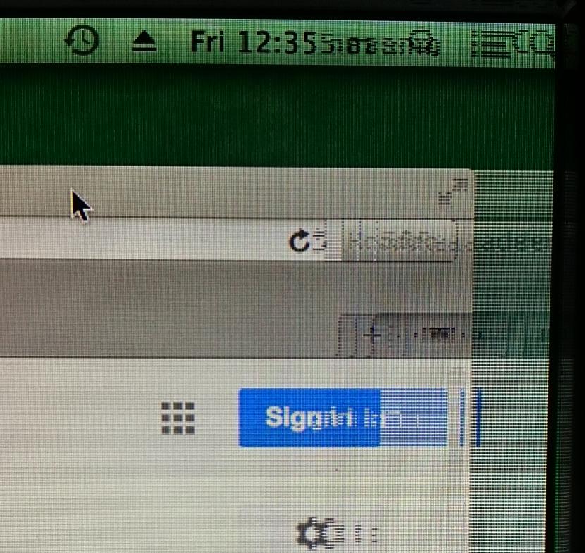

ismithers Posted July 31, 2014 Share Posted July 31, 2014 Hi all, I have the issue shown in the image where the right 10% or so of my screen has this graphical garbage. My system is: Z68 Extreme4 Gen3Gigabyte R9 280X 3GB GPUIntel Core i7 26008 GB G Skill DDR RAMSamsung U28D590D MonitorOS X 10.9Connecting via Display Port and running at 3200x1800 Hackintosh works fine, other than this issue. What causes this, and what must I do to resolve it? I've already tried a lot but not had any joy thus far. Thanks in advance. Link to comment https://www.insanelymac.com/forum/topic/299947-gigabyte-radeon-r9-280x-overclocked-3gb-windforce-what-causes-this-issue/ Share on other sites More sharing options...
ismithers Posted August 1, 2014 Author Share Posted August 1, 2014 Turns out this issue is related to the pixel frequency that is set for the monitor. So I used SwitchResX to manually configure a resolution and played around with the settings. A pixel frequency that is around 400Hz to 500Hz will cause this issue to manifest. This is a little problematic as high resolutions require a high pixel frequency to push them. For the moment I am running below the native resolution of my monitor. In Win 8.1 I can run at the native resolution which is 3840x2160 with refresh rates (V/H) of 133.3Hz x 60Hz but for some reason OS X 10.9 doesn't like this. Not sure where to go from here. Any information would be helpful. Link to comment https://www.insanelymac.com/forum/topic/299947-gigabyte-radeon-r9-280x-overclocked-3gb-windforce-what-causes-this-issue/#findComment-2047142 Share on other sites More sharing options...
