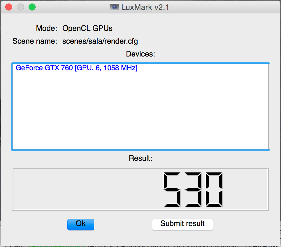

StephanCA Posted July 29, 2014 Author Share Posted July 29, 2014 This is my OpenCL benchmark, something feels wrong because MacBook Pro with Iris graphics scores 2600 and has 40 computing units. Link to comment https://www.insanelymac.com/forum/topic/299890-poor-performance/#findComment-2045876 Share on other sites More sharing options...

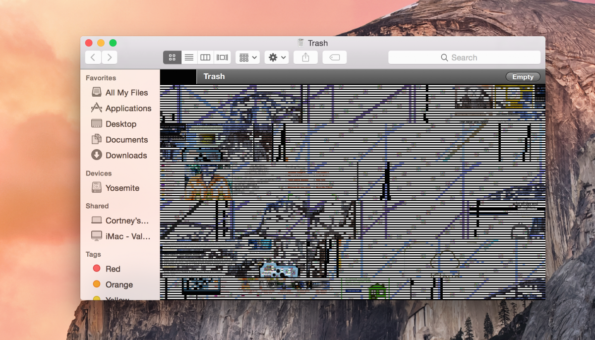

StephanCA Posted August 2, 2014 Author Share Posted August 2, 2014 I don't know if it's vesa mode because it works a lot faster than in safe mode, I think safe mode uses VESA graphics mode. I installed a clean copy of Yosemite and I no longer have any performance issues (I think), but I do get some artifacts when resizing windows or sometimes when scrolling. Also every ~10 seconds some black lines flash on screen. I attached example of artifacts I get. Wonder if thats like it for everyone with yosemite beta? On macbook pro it works fine. I had HD5870 before with DSDT edits and it worked a lot better, for GTX 760 I deleted all the edits because I don't know which are correct and I thought it is supposed to work OOB. I would appreciate any help. Link to comment https://www.insanelymac.com/forum/topic/299890-poor-performance/#findComment-2047533 Share on other sites More sharing options...

StephanCA Posted August 2, 2014 Author Share Posted August 2, 2014 I manually created installer following some video here, with chameleon bootloader and my Extra folder, so installer should be good with no unnecessary kexts/changes in there. For post installation I just manually copied FakeSMC, installed Chameleon r2391, patched AppleHDA and AppleRTC, installed RealtekRTL81xx.kext for network. My GPU + CPU give me 905 in LuxMark benchmark, my graphics card is 2GB version and maybe slower than yours, and CPU is only running at 2.6 GHz, so probably nothings wrong with benchmarks, don't know why Macbook pro got 2600 with iris graphics. On Mavericks I didn't had those problems (with artifacts) but was using web drivers, so I guess I could suck it up and wait for drivers for Yosemite. Link to comment https://www.insanelymac.com/forum/topic/299890-poor-performance/#findComment-2047547 Share on other sites More sharing options...
Pimentel Posted August 2, 2014 Share Posted August 2, 2014 Hello don't know why Macbook pro got 2600 with iris graphics. Because tou have many Scene to choose, simple, medium and complex... result is not the same in each I will post my results with only GPU Tests in diferents scenes... Simple Scene/GPU only=3842 Medium Scene/GPU only=570 Complex Scene/GPU only=286 With GPU+CPU the result is biggest, almost double... If you card grafik is recognized by OSX, maybe this can be just a Yosemite problem... for you manufacture card... Mine card is: Gigabyte GTX 760 4Gb Link to comment https://www.insanelymac.com/forum/topic/299890-poor-performance/#findComment-2047701 Share on other sites More sharing options...
