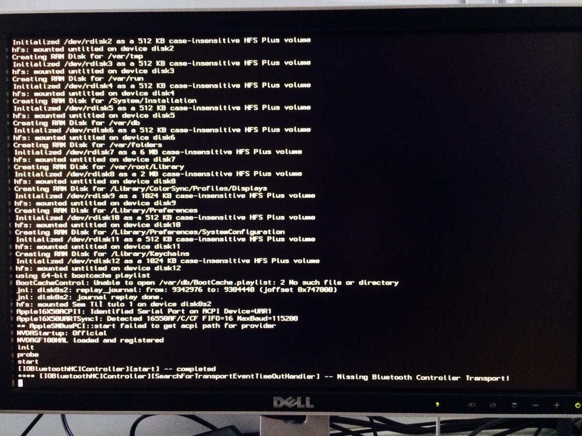

mutaba Posted May 28, 2014 Share Posted May 28, 2014 Hi.I've been trying to install Mavericks on my desktop but had no success at all. It always stop on a logo screen with spinning wheel, or then in a light grey screen followed by a dark grey screen.I used to run Leopard in this machine, when I had a GeForce 8800GS. This board died this week so I changed it to a GeForce GT 630, then it doesn't worked anymore. Same problem, I get stucked on a grey screen.Well, I already tried almost everything: Graphics Enabler=yes, and all other flags. The same problem happens with Chameleon and [url="http://www.insanelymac.com/forum/topic/279450-why-insanelymac-does-not-support-tonymacx86/"]#####[/url].I'm attaching the last screen with -v option right before the light grey screen.- Asus P5K Premium- Quad 6600- 4Gb RAM- GeForce GT 630 Thanks! Link to comment https://www.insanelymac.com/forum/topic/298286-asus-p5k-premium-stucked-on-grey-screen/ Share on other sites More sharing options...

mutaba Posted May 29, 2014 Author Share Posted May 29, 2014 Well, I did the installation with MultiB and it worked fine. But I could not boot after that. All I got was a black screen with a cursor blinking. So I came back to Chameleon installation. Using PCIRootUID=0 GraphicsEnabler=Yes flags, it freezes right before the screen that chooses the language, it's a gray screen with a color spining wheel (mouse pointer). Link to comment https://www.insanelymac.com/forum/topic/298286-asus-p5k-premium-stucked-on-grey-screen/#findComment-2023137 Share on other sites More sharing options...
Fabio1971 Posted May 29, 2014 Share Posted May 29, 2014 Bios settings? Try -v and post a photo Fabio Link to comment https://www.insanelymac.com/forum/topic/298286-asus-p5k-premium-stucked-on-grey-screen/#findComment-2023138 Share on other sites More sharing options...
mutaba Posted May 29, 2014 Author Share Posted May 29, 2014 Here it is, all my bios settings and a snapshot of the last screen on -v. It stops in this screen for about 3 minutes before goes to the gray screen with the spinning color ball. Maybe bigger is better Link to comment https://www.insanelymac.com/forum/topic/298286-asus-p5k-premium-stucked-on-grey-screen/#findComment-2023144 Share on other sites More sharing options...
Fabio1971 Posted May 30, 2014 Share Posted May 30, 2014 Bios : SUSPEND MODE [s3 ONLY] REPOST VIDEO ON S3 RESUME [YES] ACPI 2.0 SUPPORT [ENABLE] ACPI APIC SUPPORT [ENABLE] Try-v GraphicsEnabler = No Fabio Link to comment https://www.insanelymac.com/forum/topic/298286-asus-p5k-premium-stucked-on-grey-screen/#findComment-2023200 Share on other sites More sharing options...
