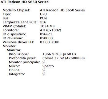

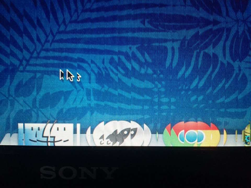

istopped Posted March 30, 2014 Share Posted March 30, 2014 I get clover installed on my laptop and full working, "System information" finally recognize my graphics card so I guess the kext get loaded thanks to this video guide (http://www.niresh12495.com/videos/view-8-how-to-get-ati-5650m-working-with-qeci-on-osx-mavericks/). Unfortunately I get a strange video glitch, can anyone point me out to resolve the situation? I though I was setting the wrong frame buffer but I'm using the same as the guide write. All images are in the attachments. 1 Link to comment https://www.insanelymac.com/forum/topic/297165-fixed-see-inside-for-infographics-glitchs-with-clover-and-graphic-injection/ Share on other sites More sharing options...
istopped Posted March 31, 2014 Author Share Posted March 31, 2014 Fixed! I just set the flag, using Clover configuration.app, "DualLink" to 0! 1 Link to comment https://www.insanelymac.com/forum/topic/297165-fixed-see-inside-for-infographics-glitchs-with-clover-and-graphic-injection/#findComment-2008844 Share on other sites More sharing options...
