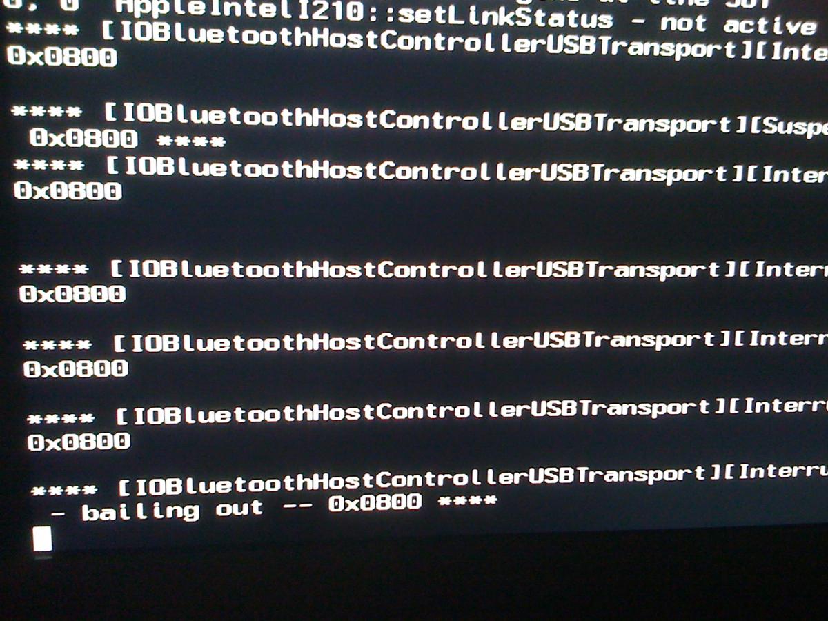

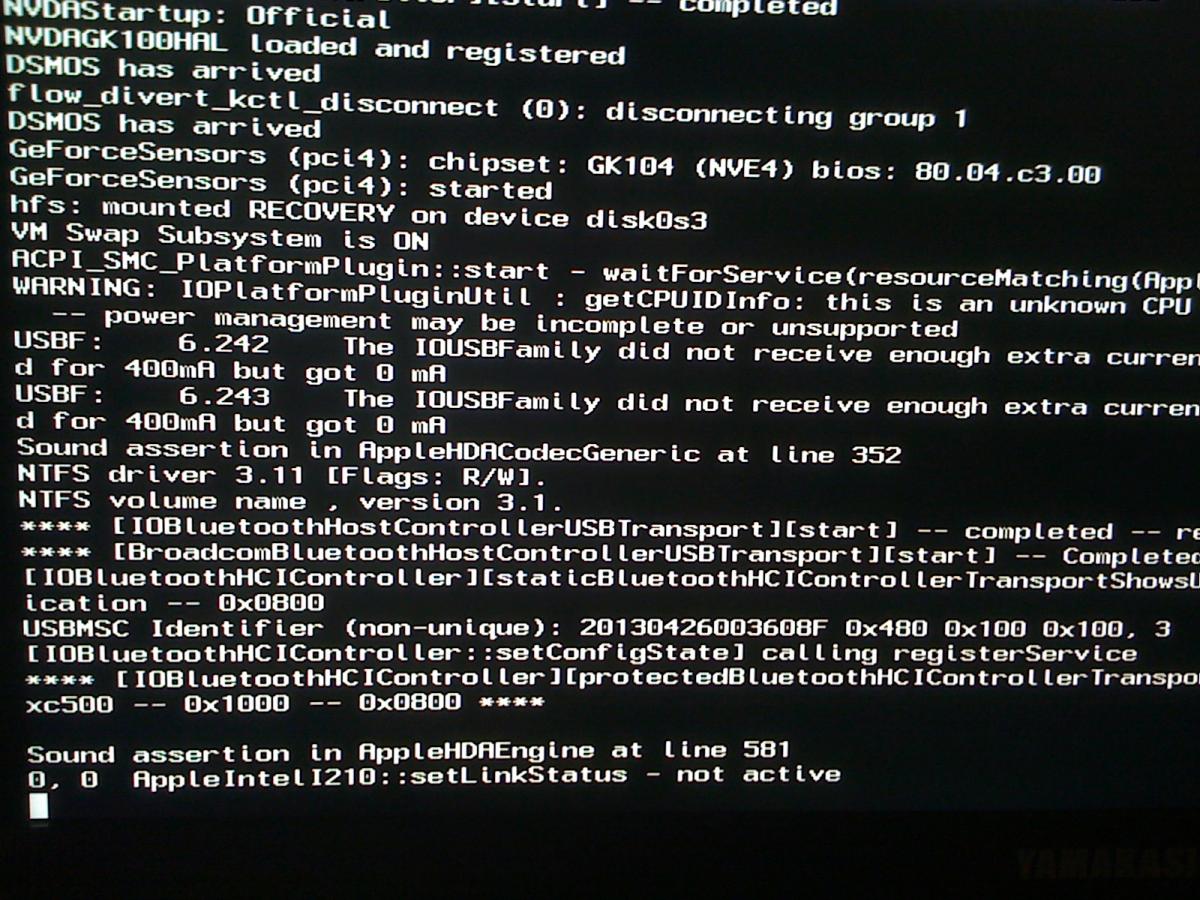

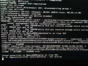

I have three issues that I'm seeing.
1) Occasionally I'll run into a boot issue where it freezes after the bluetooth IOcontroller transport. I believe this is a graphics related issue from the plethora of reading I've done. I spoke with Rampage, and he recommended loading the Nvidia retail drivers. I've installed those, which have updated and gives me the control panel option to select use apple or nvidia drivers. Trying to select the nvidia drivers after restart, it again freezes at the previously mentioned bluetooth iocontroller transport line. Rebooting with -x, rerunning MB, repairing permissions with disk utility, then restarting will allow it to restart without any bootflags. Then I run myHack myfix, and the computer runs properly again, but it is not actually using the nvidia driver (checked in console, as well as shown in the control panel) I've tried this with and without the .dylib file in modules that is recommended by Rampage's guide, no difference.

First what SMBIOS are you using?
Have you tried adding -xcpm as a boot argument?
Are you adding the option DropSSDT?
See this thread for more info regarding your Haswell CPU http://www.insanelymac.com/forum/topic/295587-power-management-for-sandyivy-bridgehaswell-cpus/
