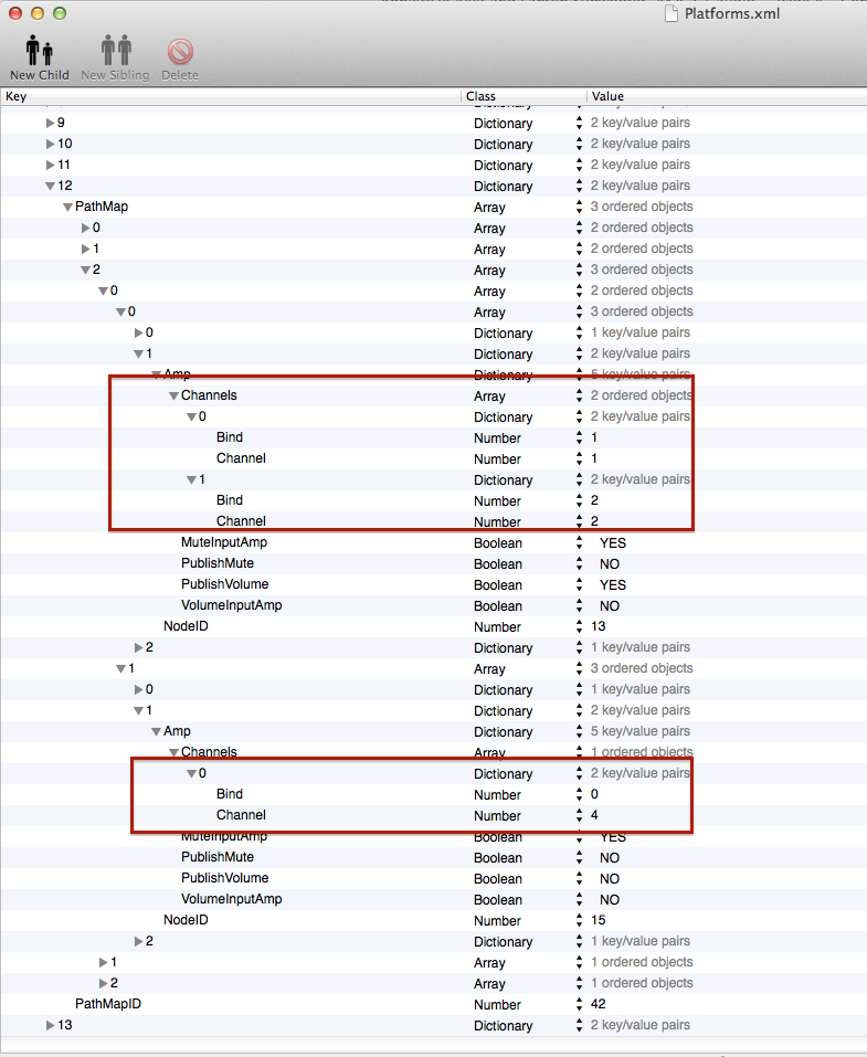

Rodion2010 Posted April 29, 2016 Share Posted April 29, 2016 AFAIK separate channel in OSX is impossible. Any audio player produces only 2 channel stream: left and right. I mean analog sound say nothing about digital. It is possible and it is used at real MacBook they use DSP functions from DSP Kernel Lib to produce additional channels from stereo Russian topic https://applelife.ru/threads/dsp-funkcii-v-applehda-i-osvkerndsplib-kext.1194341/ ioclasscount | grep DspFunc DspFunc = 3 DspFunc2To4Splitter = 2 DspFunc6ChOutput = 1 etc but still no idea how to use it and create working kext (( and here is the 6 channel output http://www.insanelymac.com/forum/files/file/176-experimental-6-channel-applehda-for-alc889/ Subwoofer in Platforms Path Map <key>Channels</key> <array> <dict> <key>Channel</key> <integer>4</integer> // 1 2 - are stereo or front , 4 - Sub! , 5 6 - Surround Channels if present ( 3 is Center channel in theory but never seen it in Apple's files) <key>Bind</key> <integer>0</integer> </dict> </array> more DSPs used for SubWoofer: DspFunc2Dot1Crossover DspFunc2Dot2Crossover DspFunc2To4Splitter DspFunc2To6Splitter DspFunc2WayCrossover DspFunc3ChOutput Link to comment Share on other sites More sharing options...

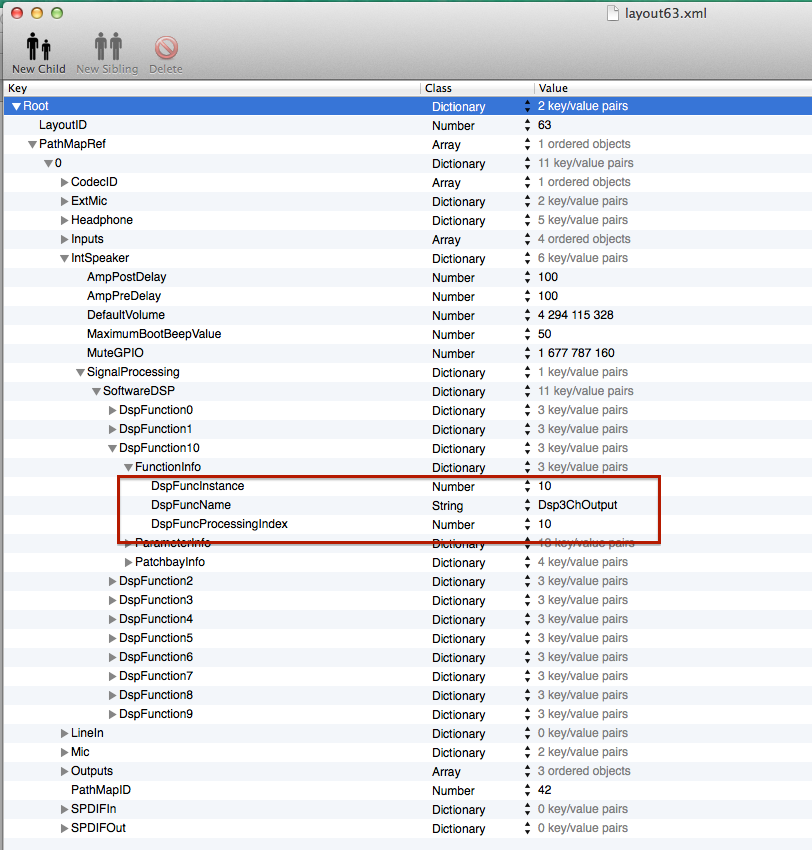

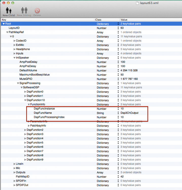

AGuyWhoIsBored Posted October 10, 2017 Share Posted October 10, 2017 Hello! I'm going to attempt to bring this thread back to life I'm trying to get the subwoofer in my Dell Inspiron 15 7567 working...Now I've tried to get it to work before, and I've put a fair amount of work into this. So far, I've successfully tested the subwoofer speaker node, and it works beautifully. Everything else on my AppleHDA also works (speakers, mic, etc.). My 2 channel speakers work, and my single channel "subwoofer speaker" works, but I'm not too sure how to put them together into 6/3 channel audio (since each one is working only by itself in a single dummy kext). Speaking of the 6/3 channel audio, I've found some references in the native AppleHDA layouts mentioning 3 channel audio "DspFunc3Channel" (or something like that) with 2.1 surround...Maybe we can get it working this way? The only part I need assistance with is how to bind / associate both of these nodes together to be able to have it be in one patched AppleHDA kext! I find it somewhat tricky because BOTH of the speakers only have a Pin Complex node and an output node (no mixer node), so I can't really "plug-and-chug" with the values that have worked with other users...(mainly AREOS) If anyone could help (@AREOS ) me to setup the PathMaps, that would be extremely appreciated! If I could get this working I would be willing to write a guide on how to do it for other people as well! Thank you! -Duncan Link to comment Share on other sites More sharing options...
Rodion2010 Posted May 2, 2018 Share Posted May 2, 2018 (edited) On 30 апреля 2016 г. at 12:16 PM, wern apfel said: I've also tried to make a 6 channel kext, but there is no discrete 6 channel only 2 channels on all outputs something like fake surround, you can control the volume from all channels but no discrete 6 channel. I've tried VLC and the Apple DVD player. It seems that this patch is only good for 2.1 Laptops or MP3 file at 5.1 systems The topic is not fake surround, it is 2.1 and Suvwoofer, and it works OK the most of MP3 are stereo files and do not require 5.1 output On 11 октября 2017 г. at 2:46 AM, AGuyWhoIsBored said: .Maybe we can get it working this way? The only part I need assistance with is how to bind / associate both of these nodes together to be able to have it be in one patched AppleHDA kext! Yes, it uses DSP3Channel Bind Channel 1 ------1 2-------2 for Stereo and 0-------4 for Sub look at real MacBook's Platform XML Edited May 2, 2018 by Rodion2010 Link to comment Share on other sites More sharing options...
