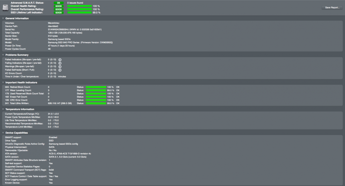

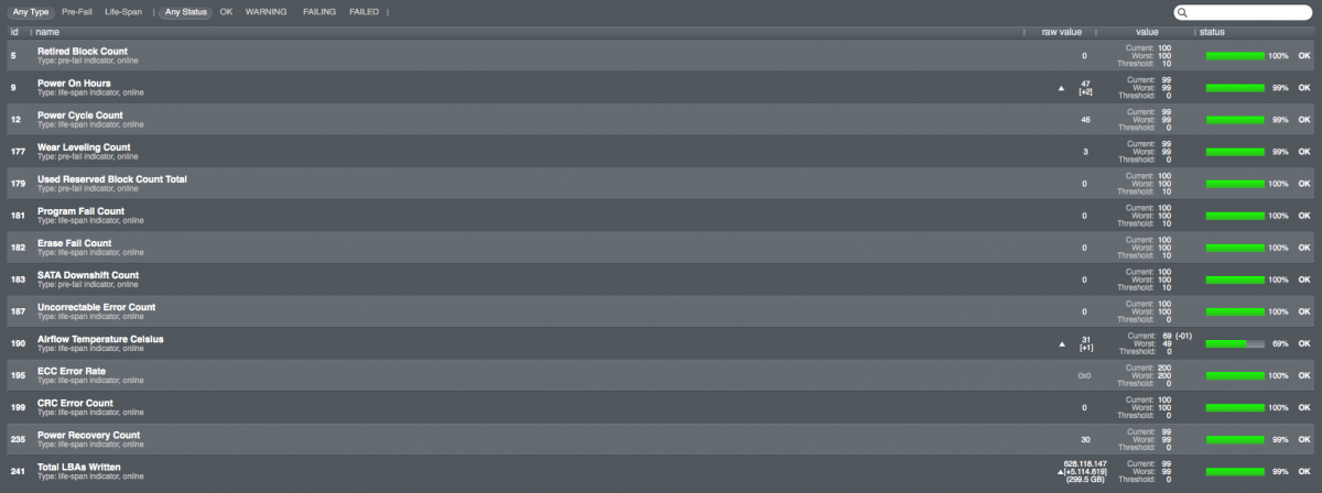

Kynyo Posted February 16, 2014 Share Posted February 16, 2014 I have a Samsung 840 Pro 128GB SSD. A look with DriveDX gives me 99.0% @ SSD Lifetime Indicator Now I'm wondering if that it's a bug or a really warning! Any help is appreciated. Thanks Link to comment https://www.insanelymac.com/forum/topic/296113-ssd-question/ Share on other sites More sharing options...
iFIRE Posted February 16, 2014 Share Posted February 16, 2014 like I understand, this indicate that you have utilized 1% of life time of your disk, then you have 99% again of life time 1 Link to comment https://www.insanelymac.com/forum/topic/296113-ssd-question/#findComment-1994624 Share on other sites More sharing options...

Kynyo Posted July 8, 2014 Author Share Posted July 8, 2014 After five months it drops from 99% to 98% lifetime.What can I do? If i Shrink disk (for OP) it will be OK? I guess it will be around 15GB just for OP. I wrote around 2.8TB till now. Link to comment https://www.insanelymac.com/forum/topic/296113-ssd-question/#findComment-2038090 Share on other sites More sharing options...
GokieKS Posted July 9, 2014 Share Posted July 9, 2014 NAND in SSDs are rated for a certain number of program/erase cycles, which basically means each block of NAND can only be written to so many times before they wear out. What you are seeing is normal wear on a SSD. The only way for you to not have that number drop is to not write to the SSD. The short story: don't worry about it. In almost all consumer usage models, the NAND in a SSD will last longer than the SSD will remain useful (due to size, performance, etc). Link to comment https://www.insanelymac.com/forum/topic/296113-ssd-question/#findComment-2038741 Share on other sites More sharing options...
