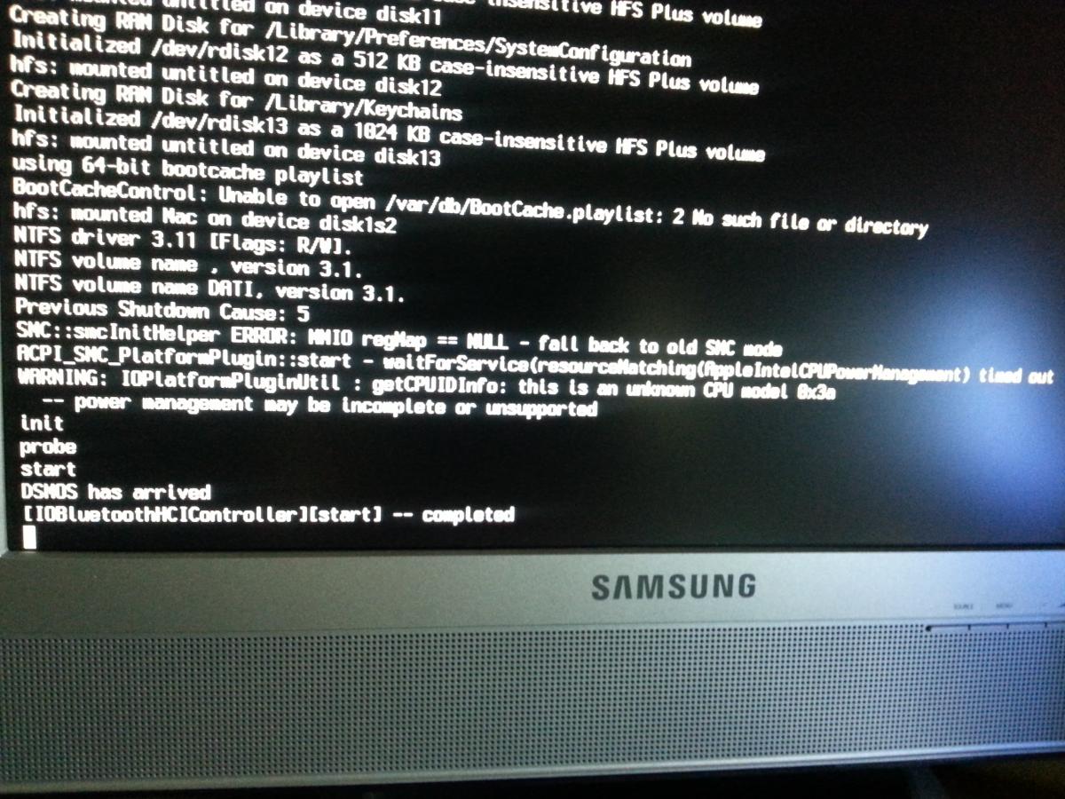

Biagio9104 Posted January 18, 2014 Share Posted January 18, 2014 Hi, I would like to install mavericks on a PC with the following characteristics: MotherCard: ASUS P8Z77 v-lk VideoCard: ASUS AMD RADEON HD7770 RAM: 8gb CPU: Intel I5 ivy Bridge 3.2 ghz I tried to run the installation by creating the pen drive to boot with my hack, starting this installation hangs about 19 minutes from the end of an error.The error that I am shown a screen with the verbose boot is as follows:ERROR: MMIO regMap == NULL - Fall back to old SMC mode I do not know how to solve it to complete the installation.Thank you in advance for your answers. Link to comment https://www.insanelymac.com/forum/topic/295395-installation-os-x-mavericks/ Share on other sites More sharing options...

Laberlohe Posted January 18, 2014 Share Posted January 18, 2014 'hoi! Hello, try without kext IOBluetoothFamily with nullpowermanagement When your airbag controll lights up, will you remove the bulp in order to hide the error? "Hanging" at the bluetooth kext while starting means that there is something wrong with the graphical subsystem. Bluetooth is the last routine before starting the gui. When gui isn't working there will always the last loaded kexts be shown - even when they were loaded correctly. Ivybridge or Haswell system will stop starting the gui when there is something wrong with the Intel integrated graphics, e.g. wrong framebuffer or wrong way of enabling graphics. Instead of deleting the graohics kexts you can try to boot with flags "-f -v GraphicsEnabler=Yes SkipNvidiaGfx=Yes SkipIntelGfx=Yes npci=0x2000", so Chameleon will only try to enable AMD-graphics. Good luck! Link to comment https://www.insanelymac.com/forum/topic/295395-installation-os-x-mavericks/#findComment-1986270 Share on other sites More sharing options...

Rampage Dev Posted January 18, 2014 Share Posted January 18, 2014 Hello, try without kext IOBluetoothFamily with nullpowermanagement first, delete all Graphics ATI, INTEL HD, NVDA, GeForce kexts from USBInstaller, change smbios to iMac13,2, then go to your bios and put IGPU in off boot with -f -v GraphicsEnabler=No npci=0x2000 Please stop. What install method are you using? Boot with the following: -v -x npci=0x2000 GraphicsEnabler=No Report back the results. What is happening is that your Graphics Card is hanging on the Framebuffer Mac OS X is trying to load. With your generation of AMD Graphics Cards safe mode (in most cases) will not load the Framebuffer to load. This is only a temporary solution until you use a DSDT/SSDT injection to correct this and or edit the AMD Graphics Drivers for your generation of Graphics Cards to support you Device ID fully. Link to comment https://www.insanelymac.com/forum/topic/295395-installation-os-x-mavericks/#findComment-1986331 Share on other sites More sharing options...
