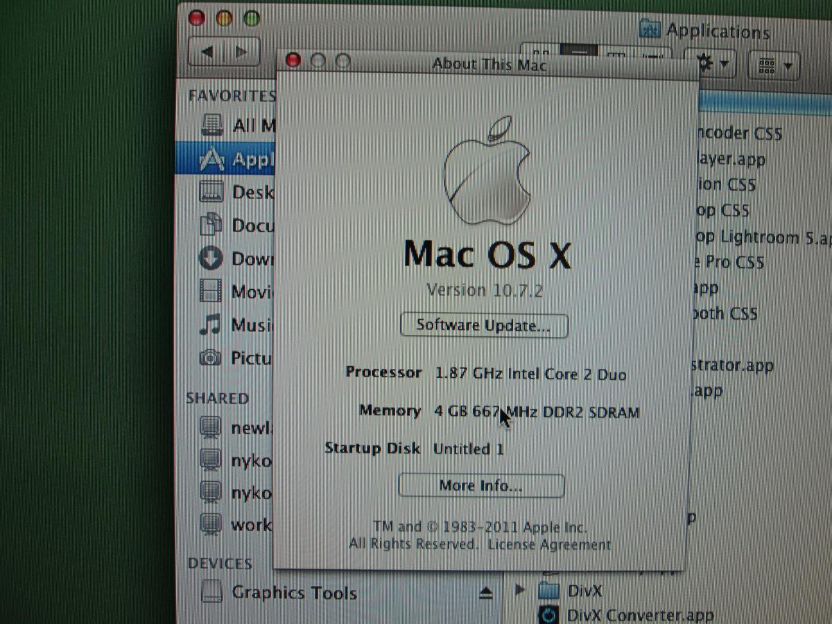

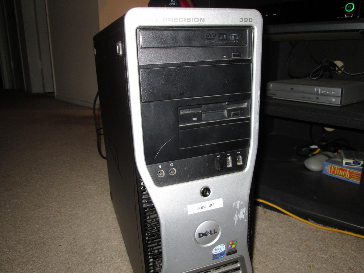

I successfuly installed OS X 10.7.2  by iAktos L2 onto a Dell Precision 390 with all hardware running in 64-bit mode. Installation method was DVD.
The Hardware:
Intel Xeon 3040 Dual Core 1.8 Ghz(Equivalent to a Core 2 Duo E6300)

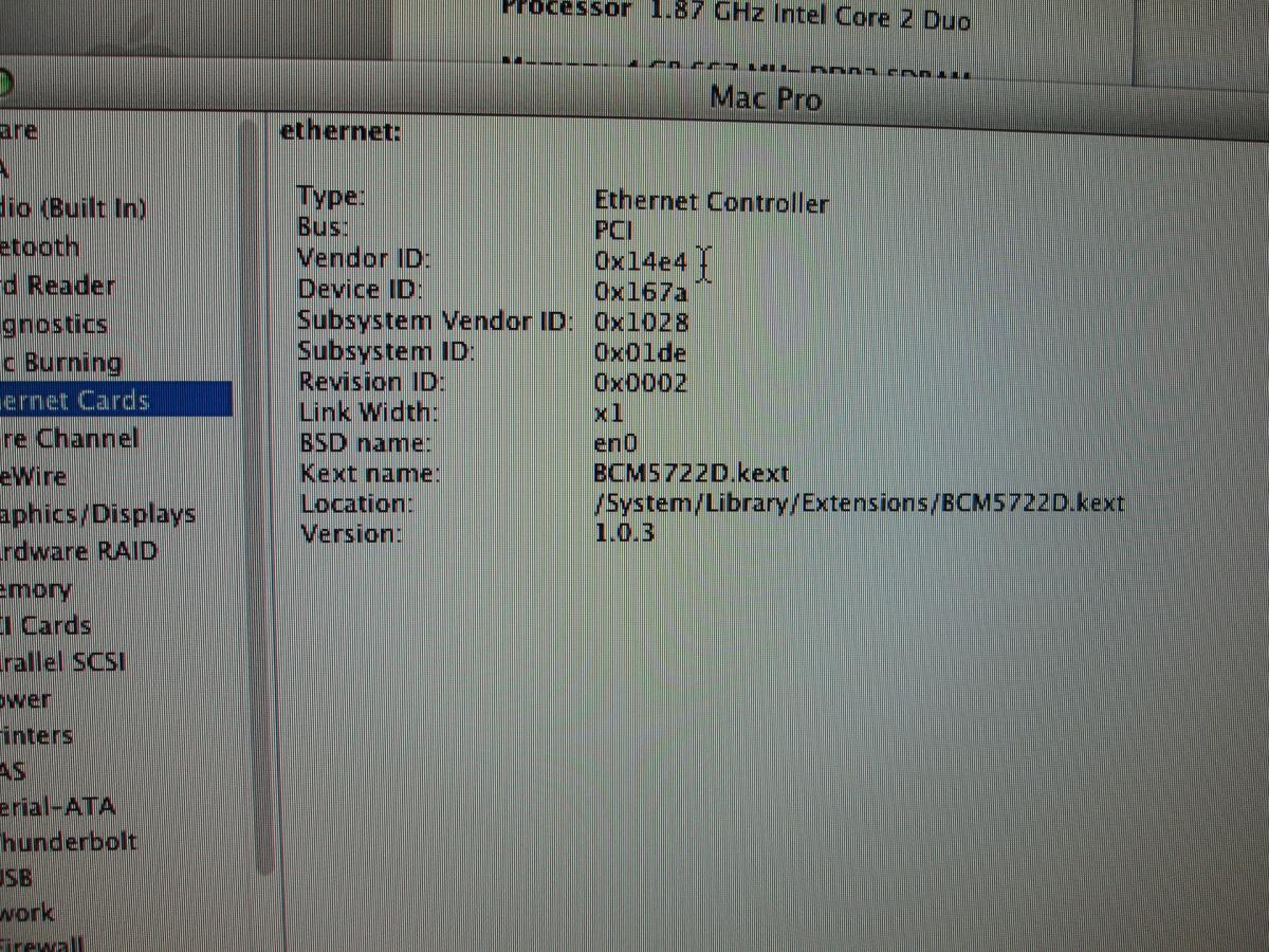

Broadcomm BCM 5754 Gigabit Network Card
 *Use driver from here http://www.osx86.net/files/file/1387-broadcom-5752-x86-64-i386/

Be sure to install the kext with champlist and rebuild permissions with the kext utility.
On installation of Lion I did not pick anything special from the default items already selected on installation except AHCI/SATA..I chose SATA/IDE instead because I kept getting kernel panic on AHCH/SATA choice. Did not chose the USB fix because all usb ports work out of box. On installation do not select any ethernet patch or audio patch. Install the kext listed above post install through champlist. Getting QE/CI from the video card and in 64-bit mode. All DVI connectors and the HDMI connector works perfectly. However I did not test the HDMI connector to see if sound is passed through the HDMI connection. I assume it does not work. Front audio and back audio ports work perfectly.

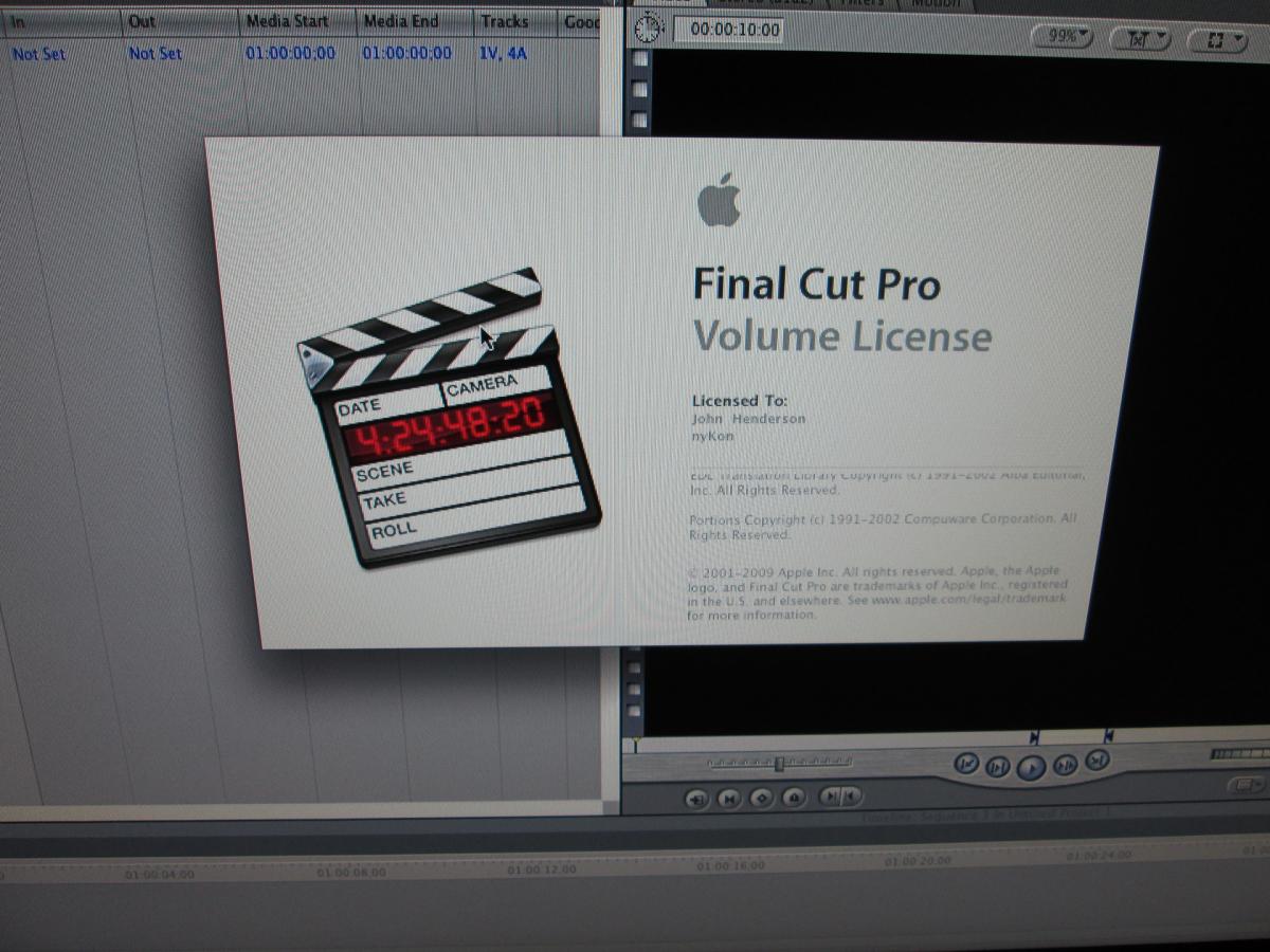

All software installed by default with Lion works fine with no crashes. See the list below of other software installed successfully and works with no crashes.
Apple Final Cut Pro 7
