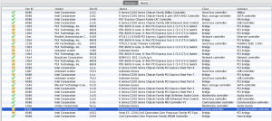

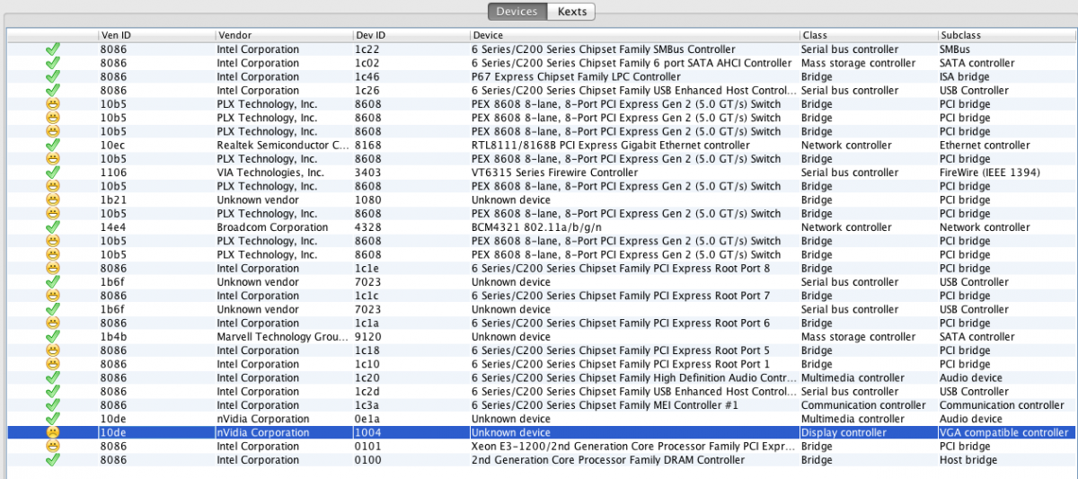

revert Posted January 2, 2014 Author Share Posted January 2, 2014 Some more digging, System info is showing GK110 Ven ID 10de Dev ID 1004 Unkown device Link to comment Share on other sites More sharing options...

revert Posted January 4, 2014 Author Share Posted January 4, 2014 It's a revision B chip, i've read about the opencl issues. The card worked out of the box ,no idea why it shows it's not compatible. I've attached a screenshot. Link to comment Share on other sites More sharing options...
Rampage Dev Posted January 4, 2014 Share Posted January 4, 2014 It's a revision B chip, i've read about the opencl issues. The card worked out of the box ,no idea why it shows it's not compatible. I've attached a screenshot. Your not understanding your hardware and the versions that you have... The B version of the 780 is only a 780 in name only. In reality it is a completely new core and GPU. Link to comment Share on other sites More sharing options...
