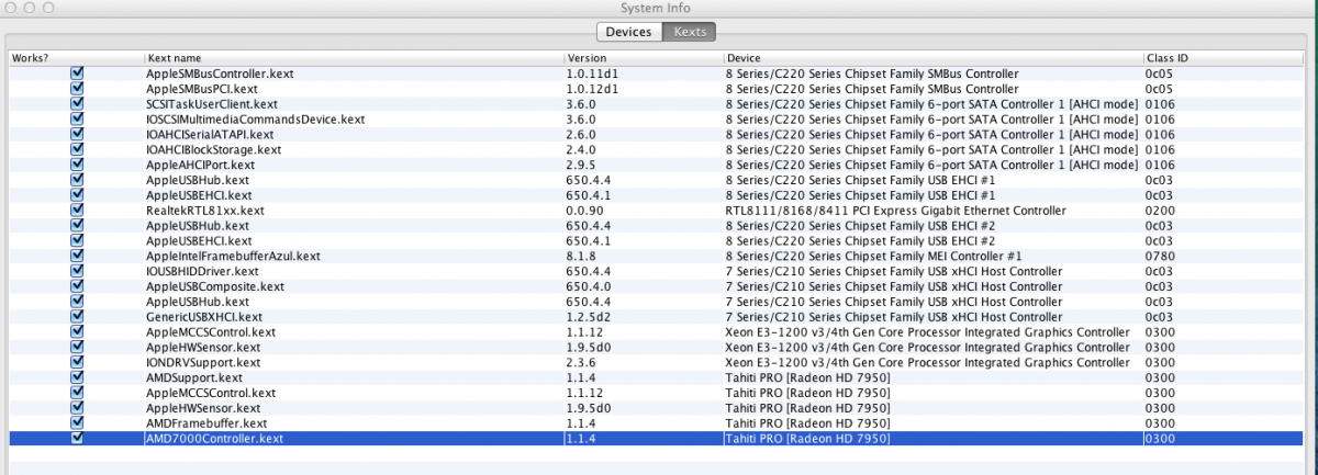

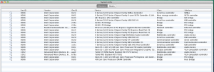

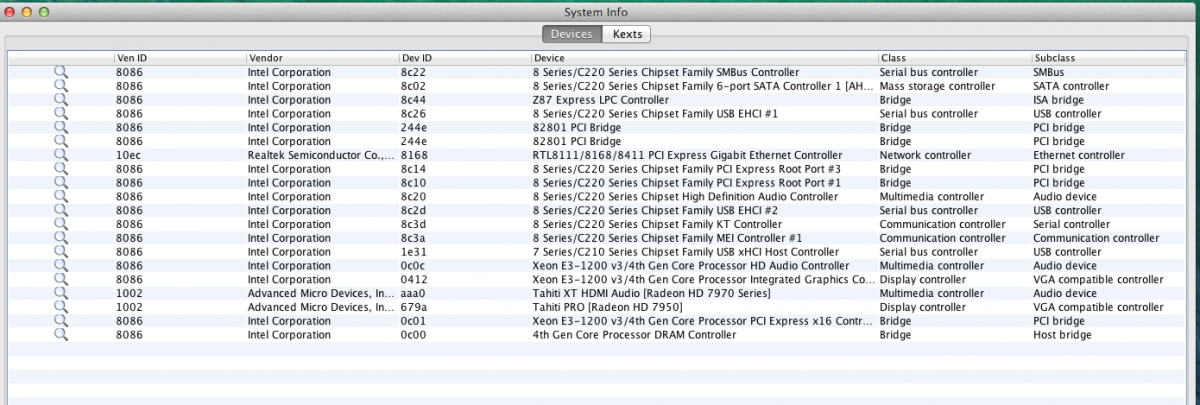

katanka99 Posted November 13, 2013 Author Share Posted November 13, 2013 Ho messo 2 screenshot dal programma System Info se possono essere utili Ho provato ad installare come bootloader Chameleon, ma non cambia nulla Link to comment https://www.insanelymac.com/forum/topic/293703-risolto-gigabyte-ga-h87-hd3-aiuto-audio-892/page/2/#findComment-1967487 Share on other sites More sharing options...
