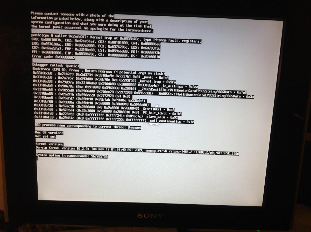

Raditude Posted September 30, 2013 Author Share Posted September 30, 2013 Ok, my computer can't boot by USB. I did have a few old custom OSX discs lying around. I have Hazard Snow Leopard, and iAtkos V7 Leopard. I was unable to get iAtkos V7 to completely install. Hazard installed correctly, but Chameleon didn't install. I was able to get Chameleon installed, with the iAtkos disc. Once I got to Chameleon, I chose the Mac partition, and it got a Kernel Panic while booting. Link to comment https://www.insanelymac.com/forum/topic/291854-2004-sony-vaio-pcv-rs620g/#findComment-1949685 Share on other sites More sharing options...

Raditude Posted October 1, 2013 Author Share Posted October 1, 2013 I've gotten the discs to boot, it appeared to install, chameleon installed, but when I tried to boot, I instantly got a kernel panic. I don't know what settings, kexts, and kernels to use, when I install. Link to comment https://www.insanelymac.com/forum/topic/291854-2004-sony-vaio-pcv-rs620g/#findComment-1949895 Share on other sites More sharing options...
3.14r2 Posted October 1, 2013 Share Posted October 1, 2013 As with any distro, select as less options as possible. The goal is to get a bootable OS X system, then solve other problems. The minimum amount (in your case) would be: patched kernel (anv legacy kernel for instance) patched AppleIntelPIIXATA.kext (or other chipset kext; needed for the system to recognise internal HDD(s)) Avoid installing any VGA/Audio/Network drivers during fresh install, as this can make troubleshooting more complicated. Link to comment https://www.insanelymac.com/forum/topic/291854-2004-sony-vaio-pcv-rs620g/#findComment-1950041 Share on other sites More sharing options...
