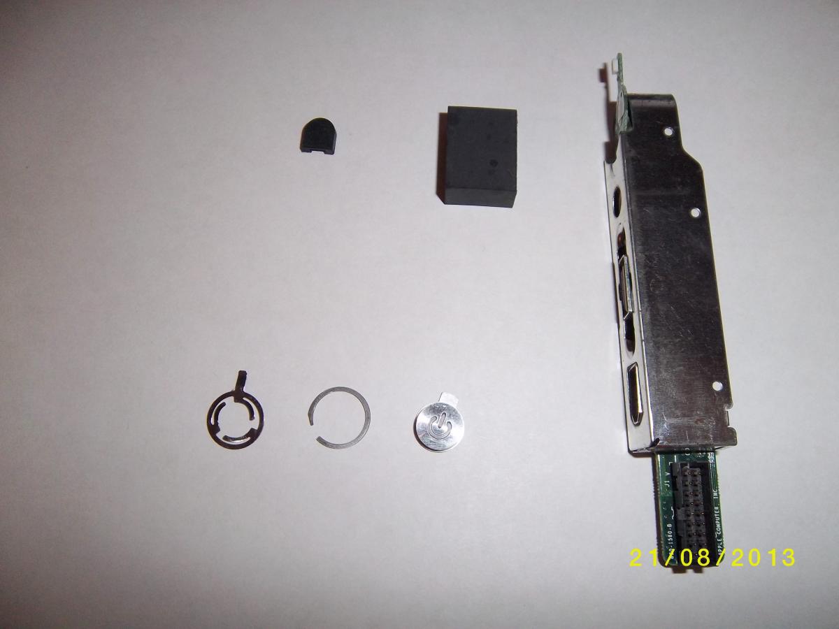

SWITCHBLADE Posted August 20, 2013 Share Posted August 20, 2013 Hi, wondering if any of you mac g5 experts can help me with the correct sequence for reassembling the front power button /panel..... in the image are the components, i know that the circlip holds the power button in the front recess but am unsure where the small round spring clip thing is situated. Please can someone help with the sequence or an exploded diagram. many thanks switchblade Link to comment https://www.insanelymac.com/forum/topic/291329-help-needed-for-g5-front-buttonpanel/ Share on other sites More sharing options...
Baudouin Posted August 21, 2013 Share Posted August 21, 2013 Check this http://www.insanelymac.com/forum/topic/287356-how-to-remove-the-g5macpro-case-power-button-assembly/ in the How-To sub-section . Hope can help. 1 Link to comment https://www.insanelymac.com/forum/topic/291329-help-needed-for-g5-front-buttonpanel/#findComment-1940233 Share on other sites More sharing options...
SWITCHBLADE Posted August 21, 2013 Author Share Posted August 21, 2013 Many thanks baudouin, that's very helpful, also I didn't realise that I could detach the button panel from the assembly to make reassembling easier, ah well I'm learning, I guess the spring clip thing has the little tab facing down, am I right? Switchblade Link to comment https://www.insanelymac.com/forum/topic/291329-help-needed-for-g5-front-buttonpanel/#findComment-1940240 Share on other sites More sharing options...
Baudouin Posted August 21, 2013 Share Posted August 21, 2013 You're welcome. And indeed, the spring clip has the little tab facing down like here; The left is down and the right side is up with the little light. Link to comment https://www.insanelymac.com/forum/topic/291329-help-needed-for-g5-front-buttonpanel/#findComment-1940255 Share on other sites More sharing options...
