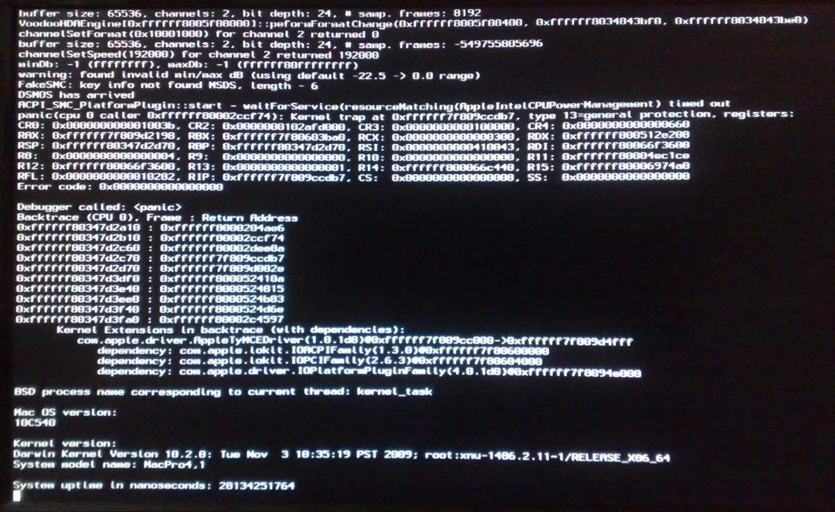

Aminul Islam Posted August 10, 2013 Share Posted August 10, 2013 Hello everyone, I'm a noob on osx86 and this is my first post, I was trying to install snow leopard from this distro, "Snow_Leopard_10.6.1-10.6.2_SSE2_SSE3_Intel_AMD_by_Hazard". My specs (I know I'm in no position to install osx with this hardware, but I just need to use keynote for my work, nothing else): Motherboard: GA-G41M-COMBO INTEL G41/ICH7/rev.1.3 Processor: Dual core 3.00 GHz Ram: 2 GB DDR3 Graphics: Onboard intel 4 series express chipset (No external Graphics Card) After installing and restarting the pc, the apple logo appears and a grey screen says that "You need to restart your computer...." I googled it and tried with "-x -v" on the chameleon bootloader and pc started normally after a long time. Then when I tried to boot normally, it froze again. I don't know much but from googling I guess it's a kernel panic I attached the screen when performed a "-v" on the chameleon bootloader: can anyone please suggest me what to do? Or if it's impossible to rum osx on this hardware? Thanks in advance Quote Link to comment https://www.insanelymac.com/forum/topic/291142-kernel-panic-with-hazards-disto-but-works-with-x-v-on-the-chameleon-bootloader/ Share on other sites More sharing options...
joe_black Posted August 10, 2013 Share Posted August 10, 2013 Do this: Boot with -s Type mount -uw / Hit enter. Type cd /System/Library/Extensions Hit enter. Type rm -rf AppleTyMCEDriver.kext Hit enter. Type reboot Hit enter. Now boot with -v *** Note: If you can't boot with -s you will need to run Terminal from your installation disc/USB and run the same commands as above. Quote Link to comment https://www.insanelymac.com/forum/topic/291142-kernel-panic-with-hazards-disto-but-works-with-x-v-on-the-chameleon-bootloader/#findComment-1938081 Share on other sites More sharing options...
Aminul Islam Posted August 11, 2013 Author Share Posted August 11, 2013 Thanks a lot, Man! Worked like a charm. Just one more thing, is there any driver for the on borard graphics? Quote Link to comment https://www.insanelymac.com/forum/topic/291142-kernel-panic-with-hazards-disto-but-works-with-x-v-on-the-chameleon-bootloader/#findComment-1938161 Share on other sites More sharing options...
