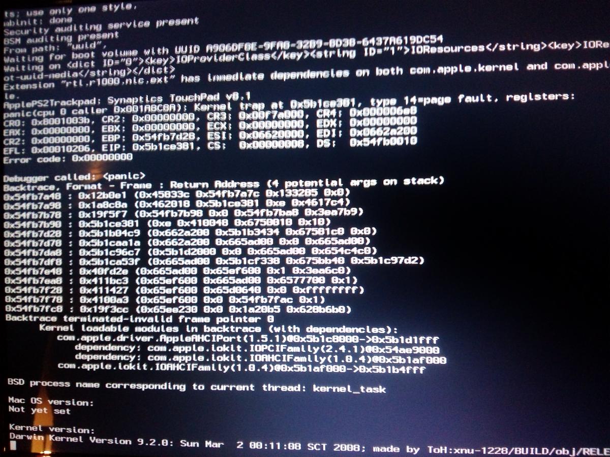

samuelBR Posted July 18, 2013 Share Posted July 18, 2013 hi, i have a problem to install osx on my notebook, i have tried some version of mac (ideneb,iatkosv3, l2,leo4all, ecc ecc) but with all i have kernel panic when start the installation, i have tried all flags to start but nothing the problem is always the same! i have already disabled uefi, but nothing. pls help me! my hardware is: cpu: Intel pentium 2020M 2.40Ghz dual core, socket 988b rpga, SSE 2 /3 /4.1 /4.2,EMT64,VT-x chipset: intel HM70 Express ivy bridge graphic: Intel HD graphic (i can't find more information) this is a screenshot of the kernel panic: thanks sorry fo my english Link to comment https://www.insanelymac.com/forum/topic/290633-kernel-panic-with-appleahciport-ioahcifamily/ Share on other sites More sharing options...

joe_black Posted July 22, 2013 Share Posted July 22, 2013 Problem is the ApplePS2Trackpad.kext, remove it from your installation media Located in /System/Library/Extensions (may be hidden) 1 Link to comment https://www.insanelymac.com/forum/topic/290633-kernel-panic-with-appleahciport-ioahcifamily/#findComment-1933835 Share on other sites More sharing options...

samuelBR Posted July 23, 2013 Author Share Posted July 23, 2013 Problem is the ApplePS2Trackpad.kext, remove it from your installation media Located in /System/Library/Extensions (may be hidden) not working the screen is the same but disappera the applePS2trackpad line Link to comment https://www.insanelymac.com/forum/topic/290633-kernel-panic-with-appleahciport-ioahcifamily/#findComment-1933939 Share on other sites More sharing options...
joe_black Posted July 23, 2013 Share Posted July 23, 2013 I'm sorry the PS2 isnt the issue, my apologies, it's the IOPCIFamily and IOAHCIFamily. Restore that trackpad kext and find patches for those 2 kexts. You are booting with BIOS set to AHCI mode right? Link to comment https://www.insanelymac.com/forum/topic/290633-kernel-panic-with-appleahciport-ioahcifamily/#findComment-1933948 Share on other sites More sharing options...
samuelBR Posted July 23, 2013 Author Share Posted July 23, 2013 I'm sorry the PS2 isnt the issue, my apologies, it's the IOPCIFamily and IOAHCIFamily. Restore that trackpad kext and find patches for those 2 kexts. You are booting with BIOS set to AHCI mode right? no because my kernel not have the settings for this, i have searched everywhere for a mod but nothing, now is in IDE mode, i don't know how to change isn't any method to install osx with IDE mode? thank you very much for your help Link to comment https://www.insanelymac.com/forum/topic/290633-kernel-panic-with-appleahciport-ioahcifamily/#findComment-1933957 Share on other sites More sharing options...
joe_black Posted July 23, 2013 Share Posted July 23, 2013 You can't boot with IDE mode. Don't give up yet though, what is the make and model of your laptop? Link to comment https://www.insanelymac.com/forum/topic/290633-kernel-panic-with-appleahciport-ioahcifamily/#findComment-1933960 Share on other sites More sharing options...
samuelBR Posted July 23, 2013 Author Share Posted July 23, 2013 You can't boot with IDE mode. Don't give up yet though, what is the make and model of your laptop? SONY Vaio model: sve1513b1ew Link to comment https://www.insanelymac.com/forum/topic/290633-kernel-panic-with-appleahciport-ioahcifamily/#findComment-1934031 Share on other sites More sharing options...
