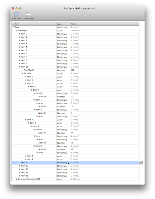

lahdekorpi Posted July 28, 2013 Author Share Posted July 28, 2013 (edited) Pinarek did not mention that he posted the ML Alpha AppleHDA.kext. For the current Realtek ALC892 AppleHDA.kext see Mountain Lion Realtek ALC AppleHDA Audio - OSx86 10.8 (Mountain Lion) - InsanelyMac Forum Platforms.xml/Pathmaps/Item 10/PathMapID: 892. What is different? Platforms.xml after the edits: A suggestion, credit the source of the kexts you attach. Post #7 illustrates the problem of replying to a kext support question when you don't know the answer. Thanks! Now I've got a proper Platforms.xml.zlib file. I tried patching from scratch with your instructions. Since the Mavericks version of AppleHDA couldn't be directly binary patched, I got a clean Mountain Lion one from my MacBook and patched that manually. All looked good until I tried to produce any sound, nothing comes out. I've seen this same problem before, where the whole sound card would stop working even after reboots or in Ubuntu. Pulling the power cord out worked on those cases, but not anymore. Well, I thought that maybe the patched file just didn't work and I restored the AppleHDA and HDAEnabler kexts that previously worked (I copied them before trying anything), fixed permissions, rebuild caches, rebooted and they have the same problem. Outputs are listed ok, headphones / internal switches automatically when plugged in (though, it takes for like 5 seconds in the preference pane to update. It just shows a lot of "Unknown" outputs for a second while switching). But no, none of those output any sound. Tried booting to Ubuntu, there everything works just fine. Am I missing something? I do keep getting these: 28.7.2013 23.09.33,000 kernel[0]: Sound assertion in AppleHDAController at line 6064 28.7.2013 23.09.33,000 kernel[0]: Sound assertion in AppleHDAController at line 6148 28.7.2013 23.09.33,000 kernel[0]: Sound assertion in IOHDAStream at line 401 Also codeaudiod crashes: Crashed Thread: 11 com.apple.audio.IOThread.server Exception Type: EXC_ARITHMETIC (SIGFPE) Exception Codes: EXC_I386_DIV (divide by zero) IOReg: Mac Pro.zip (584 KB) https://mega.co.nz/#!dIRH1bgY!NgRkoTACcGUO8gNb-h-WiBiu8-5ZaF38GYmXP6QIqlg Edited July 28, 2013 by lahdekorpi Link to comment https://www.insanelymac.com/forum/topic/290374-crackling-sound-with-alc-892-and-sse2/#findComment-1935228 Share on other sites More sharing options...

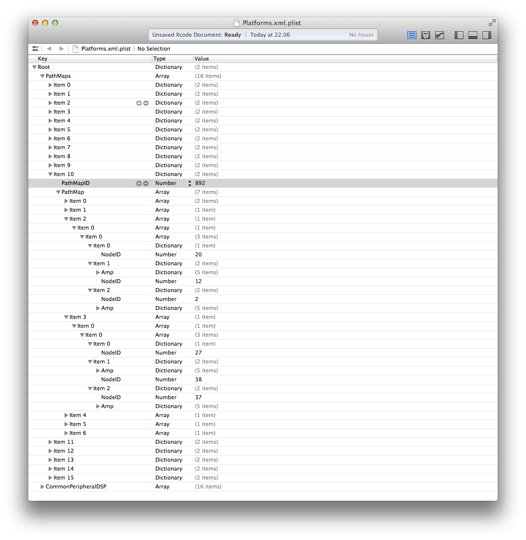

lahdekorpi Posted July 29, 2013 Author Share Posted July 29, 2013 (edited) If you need a native kext, install the combo update. Regarding the no sound problem, if the backup doesn't work any more, something else is broken. A backup restore or a fresh install is suggested. Reply with your edited Platforms.xml. I've saved the native kext of Mavericks DP4 and I have the clean one of Mountain Lion. Attached is the edited Platforms.xml. I was just wondering what else could I have broken since the only two files I have touched are the HDAEnabler1.kext and AppleHDA.kext, as well as used Kex Wizard to repair permissions. Any other conf files or caches I should remove? Edit: Tried removing both files and installing VoodooHDA, that works just fine. Tried going back to the original files pinarek posted and they don't. iTunes won't even start playing anything until I change the output to some other sound card or Air Play. I guess I'll have to wait and use VoodooHDA until someone figures out how to patch the AppleHDA in Mavericks for 892... Platforms.xml Edited July 29, 2013 by lahdekorpi Link to comment https://www.insanelymac.com/forum/topic/290374-crackling-sound-with-alc-892-and-sse2/#findComment-1935306 Share on other sites More sharing options...
toleda Posted July 29, 2013 Share Posted July 29, 2013 Tried going back to the original files pinarek posted and they don't. iTunes won't even start playing anything until I change the output to some other sound card or Air Play. AppleHDA.kext only allows 4 audio output devices. Since you added headphones, you have to delete one of the following (pdf updated).: Item 4: Orange Item 5: Black or Item 6: SPDIF out pdf updated. Edit Platforms. xml, save, install, restart. What did you do with/to HDAEnabler1.kext? This is not a Mavericks issue. 1 Link to comment https://www.insanelymac.com/forum/topic/290374-crackling-sound-with-alc-892-and-sse2/#findComment-1935356 Share on other sites More sharing options...

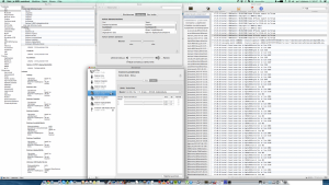

lahdekorpi Posted August 2, 2013 Author Share Posted August 2, 2013 (edited) AppleHDA.kext only allows 4 audio output devices. Since you added headphones, you have to delete one of the following (pdf updated).: Item 4: Orange Item 5: Black or Item 6: SPDIF out pdf updated. Edit Platforms. xml, save, install, restart. What did you do with/to HDAEnabler1.kext? This is not a Mavericks issue. Thanks, just forgot to remove one before... I did nothing to HDAEnabler1.kext, I just took the one from the pinarek's zip as is. Now that part works, the input is no longer changing automatically when plugging in. However, sound is still not working. Also, when changing volume via keyboard, there's a lot of delay. iTunes won't play at all. The only thing I did was: remove HDADisabler and VoodooHDA, reboot with -f, install both AppleHDA and HDAEnabler1.kext as is from the zip provided by pinarek, repair permissions and rebuild cache, reboot with -f This worked before, now it doesn't. Even restored from a backup (where VoodooHDA was installed) and am having the same problem. Weird... Are there any other caches or config files I could try removing? EDIT: Full size screenshot: http://pic.useful.fi/21ed425105cbf4c83c147d0fb01f090d.png Just for fun, tried installing the AppleHDA and HDAEnabler1 with MB 5.4.1. The result is the same, no sound and lots of: 2.8.2013 18.09.05,000 kernel[0]: Sound assertion in AppleHDAController at line 6064 2.8.2013 18.09.05,000 kernel[0]: Sound assertion in AppleHDAController at line 6148 2.8.2013 18.09.05,000 kernel[0]: Sound assertion in IOHDAStream at line 401 Edited August 2, 2013 by lahdekorpi Link to comment https://www.insanelymac.com/forum/topic/290374-crackling-sound-with-alc-892-and-sse2/#findComment-1936207 Share on other sites More sharing options...

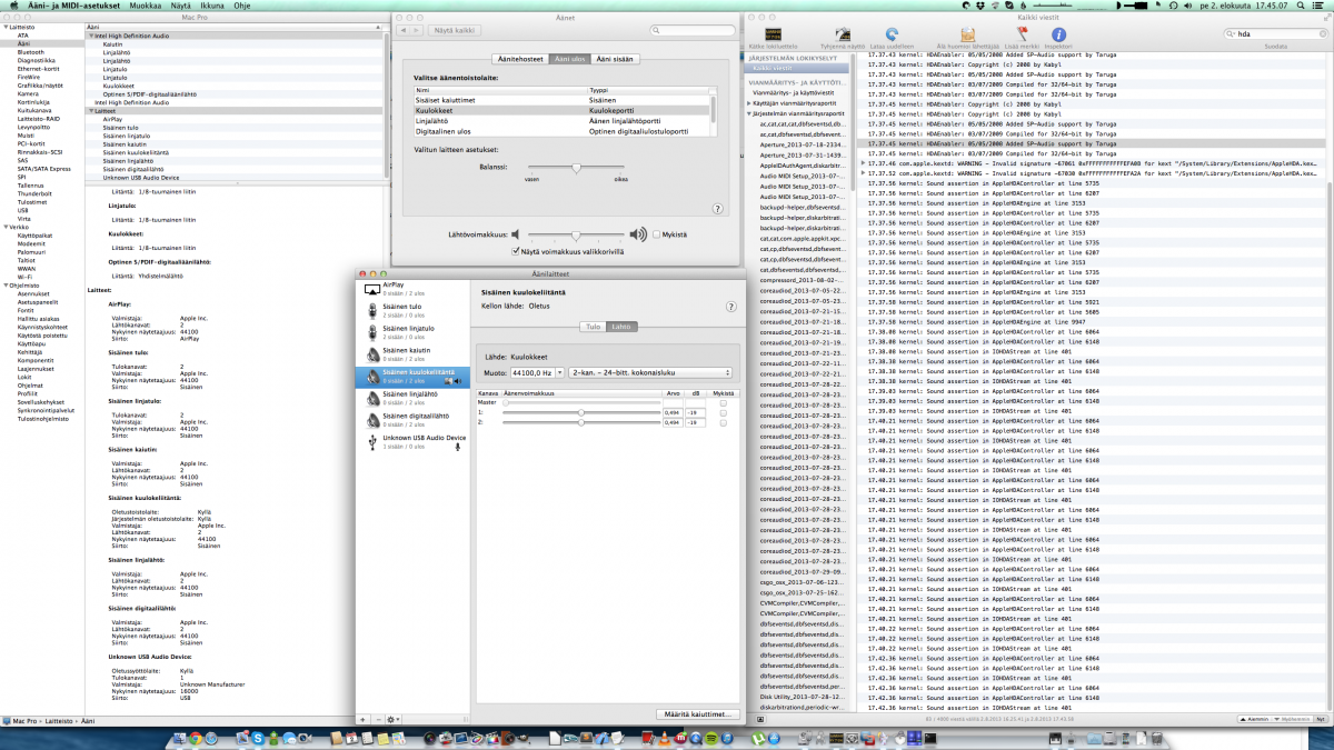

toleda Posted August 2, 2013 Share Posted August 2, 2013 This worked before, now it doesn't. Even restored from a backup (where VoodooHDA was installed) and am having the same problem. Weird... Are there any other caches or config files I could try removing? Just for fun, tried installing the AppleHDA and HDAEnabler1 with MB 5.4.1. The result is the same, no sound and lots of: 2.8.2013 18.09.05,000 kernel[0]: Sound assertion in AppleHDAController at line 6064 2.8.2013 18.09.05,000 kernel[0]: Sound assertion in AppleHDAController at line 6148 2.8.2013 18.09.05,000 kernel[0]: Sound assertion in IOHDAStream at line 401 Something is damaged or something is present that should not be. Suggest a clean install for audio testing. Get back to working audio with AppleHDA.kext. Attach your edited Platforms.xml before installing. Link to comment https://www.insanelymac.com/forum/topic/290374-crackling-sound-with-alc-892-and-sse2/#findComment-1936217 Share on other sites More sharing options...
