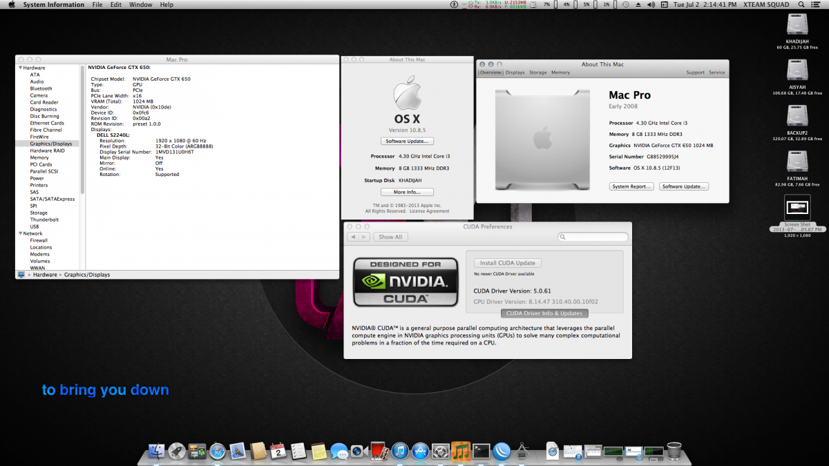

jamilitia Posted July 2, 2013 Share Posted July 2, 2013 Asrock h55m-le mountain lion 10.8.3 update to 10.8.4 and 10.8.5 hi all im from indonesia..and i want to share my experience instal hackintosh at Asrock H55M-LE. and this my 1st post ( sorry for my bad english ) my spec : ~ Asrock H55M-LE ~ Intel core i3 ~ Team memory 8GB ddr3 1600 ~ Hitachi Deskstar 250GB ~ Zotax Geforce Gtx 650 1GB ddr5 ~ Enermax naxn 500w ~ logitech usb mouse & keyboard tool: ~ myhack 3.2 beta 8 ~ Mountain lion 10.8.3 retail ~ adata flash drive 8GB Bios Setting: ~ in advance setup : CPU configuration set all as enable ~ ahci mode ~ 1st boot USB Flash drive bootflag with : ~ GraphicsEnabler=No ~ npci=0x3000 ~ PCIRootUID=0 instalation menu: ~format disk with Disk Utility ( use mac osx extended journal ) ~ instal ~ at installation progress my hack will show notice : i choose use generic delete kext, choose YES to all after success instal ~ bootflag with GraphicsEnabler=No npci=0x3000 and PCIRootUID=0 ~ after desktop show, open org.chameleon.boot.plist add string at kernel flags : GraphicsEnabler=No npci=0x3000 save ~ instal kext for Lan,audio (osx86.net) ~ run software update ( i download manual at apple web ) and instal ~ geforce gtx650 automatic detect at 10.8.3, and after update to 10.8.4 now update to 10.8.5 ~ i download manually ( serach on google ) 10.8.5 Beta Build 12F13 Combo Update and instal. after update to 10.8.5, i instal nvidia cuda driver. and now my PC running smooth osx 10.8.5 ( sleep don't work ) big thanks for insanelymac,osx86.net,myhack.sojugarden greeting from indonesia !!! ( sorry for tonysh1t86 i don't use your tool ) Link to comment https://www.insanelymac.com/forum/topic/290302-asrock-h55m-le-ml-1083-update-to-1084-and-1085/ Share on other sites More sharing options...
