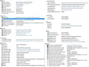

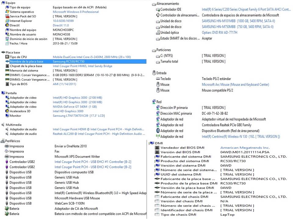

renenava Posted June 21, 2013 Share Posted June 21, 2013 Good afternoon. greetings. as I can install on my samsung mountain lion was testing with RC 730 for windows computers Niresh installed but when started the first time, It seems the white background with the apple, and then goes to a black screen.This is my System can help me Quote Link to comment https://www.insanelymac.com/forum/topic/290055-how-install-mountain-lion-in-my-lapto-samsung-rc-730/ Share on other sites More sharing options...

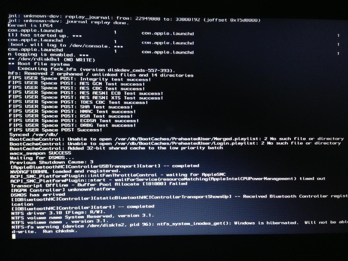

WaldMeister Posted June 21, 2013 Share Posted June 21, 2013 Hi, Boot with -v, take a photo of the output and upload it here please. Thank you. Quote Link to comment https://www.insanelymac.com/forum/topic/290055-how-install-mountain-lion-in-my-lapto-samsung-rc-730/#findComment-1926530 Share on other sites More sharing options...
renenava Posted June 21, 2013 Author Share Posted June 21, 2013 Hi, Boot with -v, take a photo of the output and upload it here please. Thank you. Here photo of my error. Quote Link to comment https://www.insanelymac.com/forum/topic/290055-how-install-mountain-lion-in-my-lapto-samsung-rc-730/#findComment-1926536 Share on other sites More sharing options...
WaldMeister Posted June 21, 2013 Share Posted June 21, 2013 Thanks.Boot with -s and type the following: mount -uw / rm -rf /System/Library/Extensions/NVDAStartup.kext rm -rf /System/Library/Extensions/GeForce.kext rm -rf /System/Library/Extensions/NVDAGF100Hal.kext shutdown -r now The dual graphics is a problem, the Nvidia card will not work, but the kexts are loaded. After you get to the desktop, create a DSDT and disable the card. Resources on how to do that are available on the forum. Quote Link to comment https://www.insanelymac.com/forum/topic/290055-how-install-mountain-lion-in-my-lapto-samsung-rc-730/#findComment-1926537 Share on other sites More sharing options...
renenava Posted June 21, 2013 Author Share Posted June 21, 2013 Thanks. Boot with -s and type the following: mount -uw / rm -rf /System/Library/Extensions/NVDAStartup.kext rm -rf /System/Library/Extensions/GeForce.kext rm -rf /System/Library/Extensions/NVDAGF100Hal.kext shutdown -r now The dual graphics is a problem, the Nvidia card will not work, but the kexts are loaded. After you get to the desktop, create a DSDT and disable the card. Resources on how to do that are available on the forum. I can not get to the desktop after leaving the white background with the apple gets a black screen and there does not advance. what should I do? Quote Link to comment https://www.insanelymac.com/forum/topic/290055-how-install-mountain-lion-in-my-lapto-samsung-rc-730/#findComment-1926552 Share on other sites More sharing options...
WaldMeister Posted June 21, 2013 Share Posted June 21, 2013 Boot with -f -v. Quote Link to comment https://www.insanelymac.com/forum/topic/290055-how-install-mountain-lion-in-my-lapto-samsung-rc-730/#findComment-1926559 Share on other sites More sharing options...
