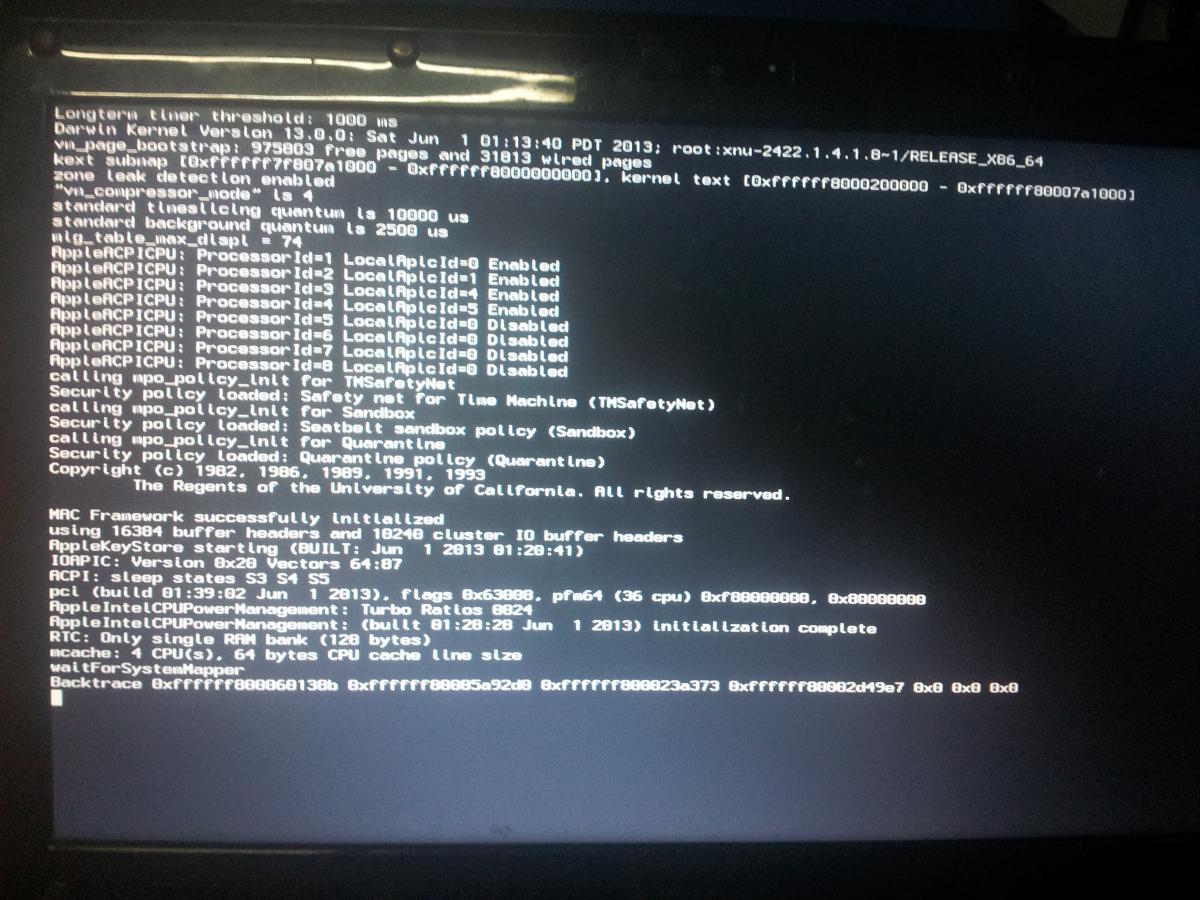

Sanky18 Posted June 21, 2013 Share Posted June 21, 2013 Hi all, I installed 10.9 successfully on my laptop Lenovo G460 (system configuration is in my signature). But i can only boot in safe mode. When i boot in normal verbose mode i get stuck (image attached below). I have FakeSMC installed. Any help would be appreciated. Link to comment Share on other sites More sharing options...
Maniac10 Posted June 21, 2013 Share Posted June 21, 2013 There's not much to see in that screen cap, but first of all we need more info to help you. DSDT, SSDT, bootloader config, smbios, extra kexts, bdmesg (Chameleon) or boot.log (Clover). A Darwin Dumper zip would be perfect. Link to comment Share on other sites More sharing options...

Maniac10 Posted June 26, 2013 Share Posted June 26, 2013 - By 2252> he means the Chameleon revision. - Update to the latest FakeSMC - Regarding the DSDT, you seem to inject the LPC, USB, SATA, WIFI and graphics with it, so that may need an update. Also, I'm no expert in this topic (or any other ) but the HDAU device is inside the GFX0 and I believe it shouldn't be. It should be like this: -->PEGP -------> GFX0 -------> HDAU - The DarwinDump doesn't have the LSPCI data (because it's booting in safe mode I guess) so could you do one from a working system? Link to comment Share on other sites More sharing options...
Sanky18 Posted June 26, 2013 Author Share Posted June 26, 2013 Funny thing......I did a rollback to 10.7.4 AppleACPIPlatform kext and i can boot normally......lol Link to comment Share on other sites More sharing options...
Maniac10 Posted June 26, 2013 Share Posted June 26, 2013 I'm glad you could solve it, now flag this topic as solved (no idea how). Still I would recommend you to check your DSDT for errors (besides compilation, like the one on the audio I posted). Or even better, redo it from scratch with the minimum edits necessary. Have fun! Link to comment Share on other sites More sharing options...
