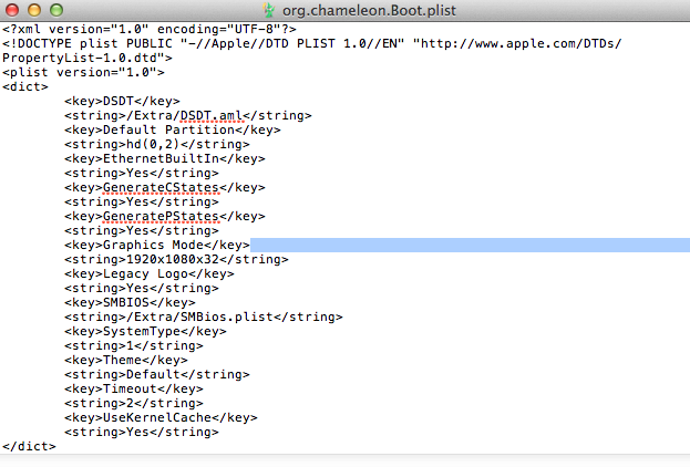

yusz Posted June 15, 2013 Share Posted June 15, 2013 My Hackintosh runs great on the following hardwares; Gigabyte GA-Z77P-D3 Version 1.1 i7-3770 8MB RAM Gigabyte GTX650 WD Blue 1TB HDD - OSX 10.9 Samsung 1TB HDD - Win 7 Installed following the guide from 10.9 Mavericks Simple Vanilla Hackintosh Install Guide Copy FakeSMC.kext and NullCPUPowerManagement.kext from the Essential DP1.zip to S/L/E of the Mavericks HDD (using Mountain Lion on separate HDD) Install audio driver using [url="http://www.insanelymac.com/forum/topic/279450-why-insanelymac-does-not-support-tonymacx86/"]#####[/url] 5.3.1 (ALC 887) With DSDT (DSDT was generated with MaciASL.app) Install boot loader using chameleon r2247 and fine-tune using Chameleon Wizard.app with the resulting org.Chameleon.Boot.plist as per attached image. Used Chameleon Wizard.app to generate SMBios.plist with iMac 13,2 All functioning well with sleep also working. Link to comment https://www.insanelymac.com/forum/topic/289867-success-gigagbyte-z77p-d3-ver-11/ Share on other sites More sharing options...
