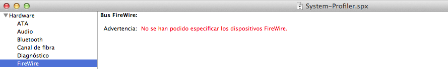

iFIRE Posted June 11, 2013 Share Posted June 11, 2013 this can be your problem: FireWire (OHCI) VendorID 1106 ID 3403 built-in: no valid selfIDs for more than 3 minutes after bus reset. FireWire (OHCI) VendorID 1106 ID 3403 built-in: no valid selfIDs for more than 3 minutes after bus reset. FireWire (OHCI) VendorID 1106 ID 3403 built-in: no valid selfIDs for more than 3 minutes after bus reset. CODE SIGNING: cs_invalid_page(0x1000): p=277[ksadmin] clearing CS_VALID CODE SIGNING: cs_invalid_page(0x1000): p=279[ksadmin] clearing CS_VALID FireWire (OHCI) VendorID 1106 ID 3403 built-in: no valid selfIDs for more than 3 minutes after bus reset. FireWire (OHCI) VendorID 1106 ID 3403 built-in: no valid selfIDs for more than 3 minutes after bus reset. CODE SIGNING: cs_invalid_page(0x1000): p=313[ksadmin] clearing CS_VALID CODE SIGNING: cs_invalid_page(0x1000): p=324[ksadmin] clearing CS_VALID FireWire (OHCI) VendorID 1106 ID 3403 built-in: no valid selfIDs for more than 3 minutes after bus reset. CODE SIGNING: cs_invalid_page(0x1000): p=354[ksadmin] clearing CS_VALID CODE SIGNING: cs_invalid_page(0x1000): p=365[ksadmin] clearing CS_VALID FireWire (OHCI) VendorID 1106 ID 3403 built-in: no valid selfIDs for more than 3 minutes after bus reset. FireWire (OHCI) VendorID 1106 ID 3403 built-in: no valid selfIDs for more than 3 minutes after bus reset. CODE SIGNING: cs_invalid_page(0x1000): p=386[ksadmin] clearing CS_VALID CODE SIGNING: cs_invalid_page(0x1000): p=398[ksadmin] clearing CS_VALID FireWire (OHCI) VendorID 1106 ID 3403 built-in: no valid selfIDs for more than 3 minutes after bus reset. FireWire (OHCI) VendorID 1106 ID 3403 built-in: no valid selfIDs for more than 3 minutes after bus reset. SAM Multimedia: READ or WRITE failed, SENSE_KEY = 0x03, ASC = 0x11, ASCQ = 0x05 SAM Multimedia: READ or WRITE failed, SENSE_KEY = 0x03, ASC = 0x11, ASCQ = 0x05 disk3: I/O error. FireWire (OHCI) VendorID 1106 ID 3403 built-in: no valid selfIDs for more than 3 minutes after bus reset. FireWire (OHCI) VendorID 1106 ID 3403 built-in: no valid selfIDs for more than 3 minutes after bus reset. Sandbox: sandboxd(512) deny mach-lookup com.apple.coresymbolicationd USBMSC Identifier (non-unique): 0000000224C702E 0x411 0x19b 0x110 FireWire (OHCI) VendorID 1106 ID 3403 built-in: no valid selfIDs for more than 3 minutes after bus reset. CODE SIGNING: cs_invalid_page(0x1000): p=558[ksadmin] clearing CS_VALID CODE SIGNING: cs_invalid_page(0x1000): p=570[ksadmin] clearing CS_VALID CODE SIGNING: cs_invalid_page(0x1000): p=578[ksadmin] clearing CS_VALID CODE SIGNING: cs_invalid_page(0x1000): p=590[ksadmin] clearing CS_VALID Sandbox: sandboxd(611) deny mach-lookup com.apple.coresymbolicationd FireWire (OHCI) VendorID 1106 ID 3403 built-in: no valid selfIDs for more than 3 minutes after bus reset. Link to comment https://www.insanelymac.com/forum/topic/289065-hackintosh-wont-wake-from-sleep/#findComment-1921582 Share on other sites More sharing options...
rev4turbomonster Posted June 11, 2013 Author Share Posted June 11, 2013 Thanks for looking into this for me ifire any idea what I need to change to correct this error. At this stage of things I get very lost Link to comment https://www.insanelymac.com/forum/topic/289065-hackintosh-wont-wake-from-sleep/#findComment-1921591 Share on other sites More sharing options...
