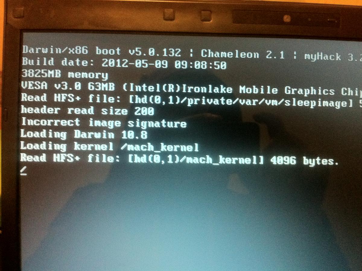

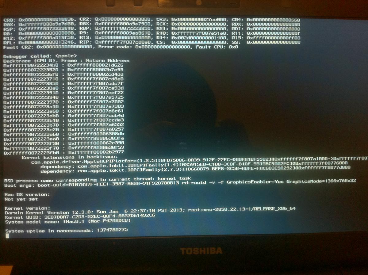

real_didi Posted May 19, 2013 Author Share Posted May 19, 2013 Thank you very much for your time iFIRE. I've dropped that file to /Extra and got kernel panic. First at chameleon starts i got this: (Header size 200 and Incorrect image signature) Boot ends at this: First time i've booted with -v -f flags only. Then tryed npci=0x2000. Link to comment https://www.insanelymac.com/forum/topic/288633-dsdt-for-tohiba-r705/#findComment-1916298 Share on other sites More sharing options...
iFIRE Posted May 19, 2013 Share Posted May 19, 2013 why you use iMac 8,1 smbios? if you have a Laptop, post your Extra folder and a full report with darwin dumper, use this flag for remove your DSDST., flags= DSDT.aml=\aaaaa Link to comment https://www.insanelymac.com/forum/topic/288633-dsdt-for-tohiba-r705/#findComment-1916336 Share on other sites More sharing options...
real_didi Posted May 20, 2013 Author Share Posted May 20, 2013 Recently I installed Chameleon over Clover so I forgot to use old Extra folder from Chameleon. it booted ok without Extra folder at all. The pictures I sent was from boot empty extra folder + dsdt.aml. Now I tried to boot with old extra folder from myHack - same result - kp. Tried to change AppleACPIPlatform.kext from 1.3.5 to 1.7 - same result - kp. SMBIOS now MBP8.1 - same result - kp. With DSDT=\aaaaa all boots ok. The reason i trying to make dsdt is my internal lcd has empty edid and i think thats why i cant use patched kexts for 1st gen intel hd graphics. But after i saw comile errors from extracted dsdt i think maybe not only empty edid is the problem. I've attached extra and DarwinDumper report. Thank you for your help iFIRE Extra.zip DarwinDumper_2.6.5_Chameleon_2.1_ML_root.zip Link to comment https://www.insanelymac.com/forum/topic/288633-dsdt-for-tohiba-r705/#findComment-1916415 Share on other sites More sharing options...

real_didi Posted May 20, 2013 Author Share Posted May 20, 2013 My internal hard drive is out of work now nad IDE mode is for recovery software. I run my ML system from external usb HDD. I'm sorry if i waste your time for that ide mode kext Ok. I tried new dsdt. Same situation. Tried cpus=1; npci=0x2000 or 0x3000; tried change AppleACPIPlatform.kext to 1.3.5 from my hack and for original 1.7. Same kp. With cpus=1 it turned off after that message. I didn't know if i need to use attached kext since i dont use my internal hdd so i botted in ahci mode without kext. Link to comment https://www.insanelymac.com/forum/topic/288633-dsdt-for-tohiba-r705/#findComment-1916431 Share on other sites More sharing options...
