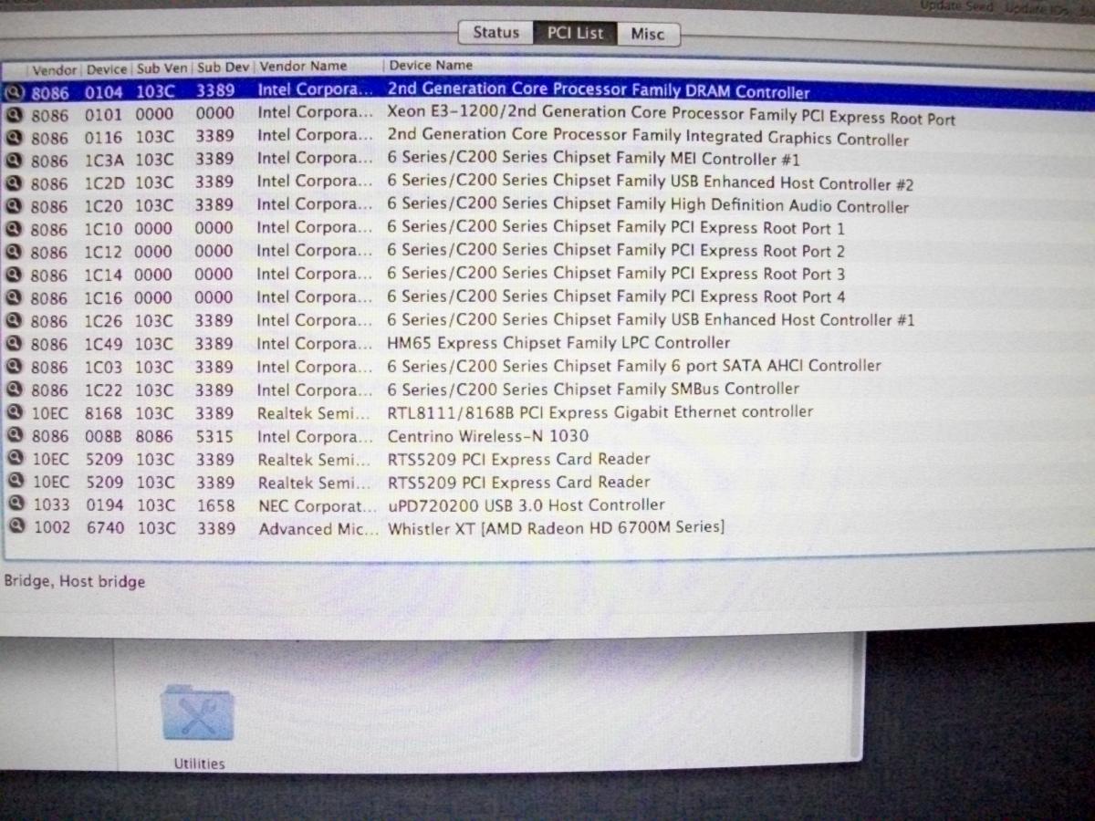

rtlarson Posted May 16, 2013 Share Posted May 16, 2013 Hi everyone. First thank you to everyone who helps make all of this possible. I have been working for months (off and on) to get OS X on my laptop HP DV7-6b75nr and could get it to install fine but never boot! I've finally gotten it to boot after installing using iATKOS ML2 and the right set of options. And i did buy mountain lion so please dont ban me. So now here's my biggest problem. The trackpad and usb worked during installation but not after. I can get it to work if i boot in to safe mode but thats it.. USBBusFix and EHCIhard do not fix it. Neither does -f, -F, pciroot=1 I got to this point this morning, then totally hosed everything when I tried to fix it using chameleon wizard (i think, i dont remember honestly, I'm doing this on my desktop also at the same time), and had to spend all day just to get back to this point again, so now that its working, i dont want to go further alone. Specs on the laptop HP DV7-6B75NR i7-2670QM (only showing 1 core) HD3000 (working) RADEON 6770M (detected but not working, later issue) 16GB RAM USB 3.0 Fingerprint scanner WIFI intel centrino N 1030 + bluetooth & WiDi (none of it working obviously) card reader VGA+HDMI DVD-RW/Blu-Ray player (CD-RW portion works at least, i successfully burnt a disc) installed to a dedicated drive (tri booting off ssd & hdd my goal) ..I know most of that will never work other issues that might help figure this out: Laptop display does not show anything after boot.. It works during install and boot but not once you get to the desktop. HDMI works. It can sense the display because at first, it'll be in extended mode till I close the laptop and it switches the desktop to HDMI only. It crashes after about 10 mins of running.. The fan is working. When you go to shutdown the laptop actually powers off (unlike my desktop) no sound The attached ZIP has the bootloader log file and an exported dsdt. the screenshots are of devices and their IDs I'm guessing i need some kext's or to edit them.. I know where they're at on the system and how to edit them, if someone can tell me exactly what to change. Please help me out. Thanks immensely in advance bootlog.zip Link to comment https://www.insanelymac.com/forum/topic/288570-no-trackpadkeyboardusb-after-install/ Share on other sites More sharing options...

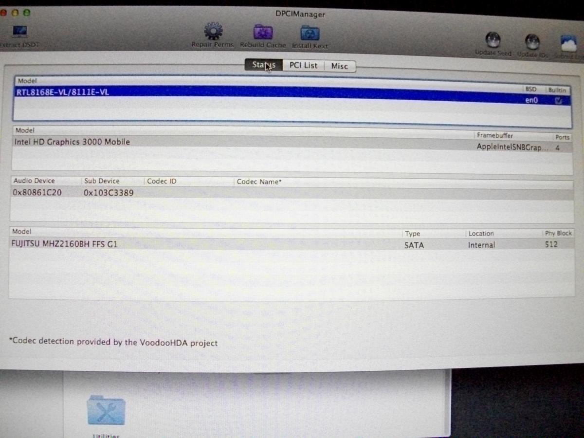

rtlarson Posted May 17, 2013 Author Share Posted May 17, 2013 Hi guys thanks for the help. I have learned a lot over the last 24 hours. Sorry I had forgotten to post that I resolved most of my issues with the right kexts, pulling my DSDT using the editor, then patching it with a file that closest resembles my laptop and putting it in the right location. Currently working: Internal screen keyboard trackpad usb 2.0 hd3000 graphics battery I ordered the TP-LINK TL-WN725N Nano Wireless wifi adapter since the centrino will never work.. or so i read I still can't get the sound working.. I've put in the voodoohda.kext, removed applehda.kext, put in the right device and vendor id, but nothing.. but at least it's not giving me a kernel panic :-) @ifire thank you for the explanation of the boot flags. I was able to boot with -x and get usb working again, but not trackpad/keyboard @minus_13 you were right, it wasn't in the right location. Actually there was no DSDT.aml file, the one I had attached was one I pulled using one of the utilities when i was still having to boot in safe mode. And thank both of you for being the only ones who responded on four different fourms :-) Link to comment https://www.insanelymac.com/forum/topic/288570-no-trackpadkeyboardusb-after-install/#findComment-1915892 Share on other sites More sharing options...
