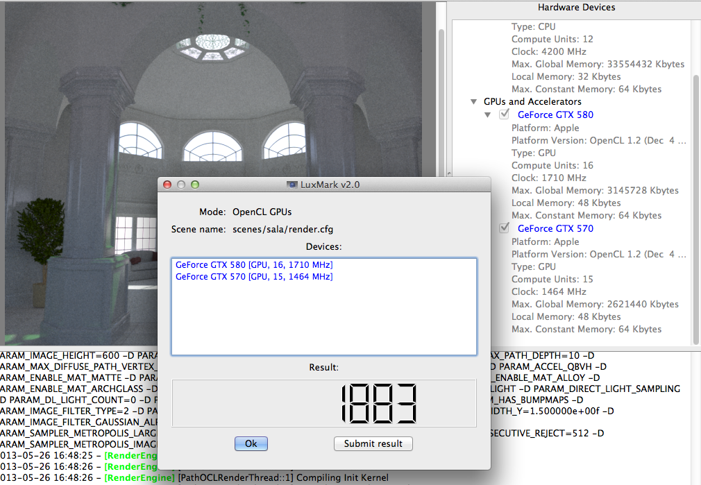

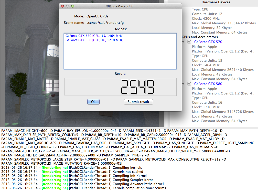

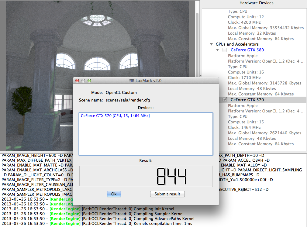

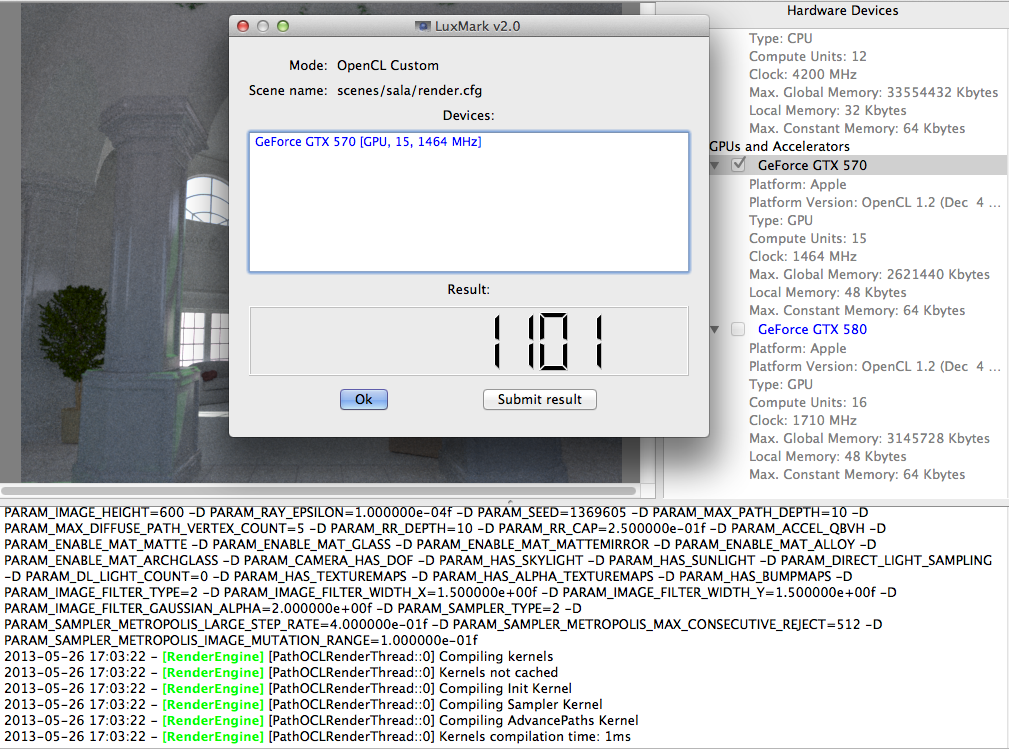

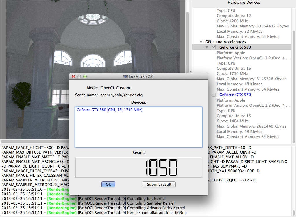

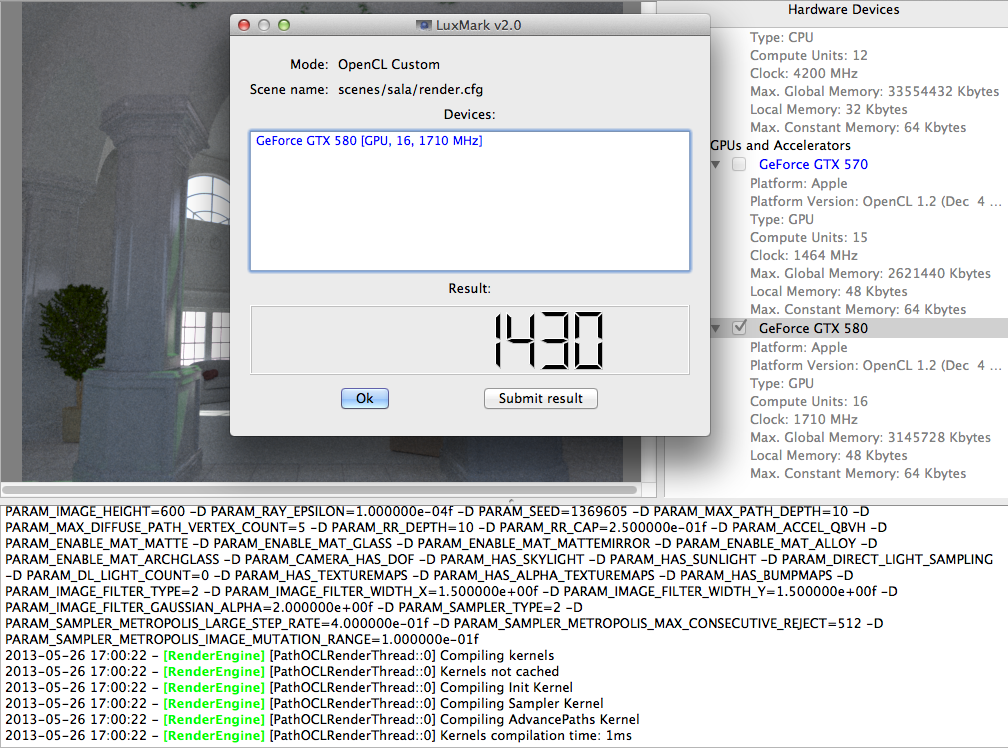

shilohhh Posted May 26, 2013 Share Posted May 26, 2013 These web drivers totally SUCK for my GTX 5xx Firmi cards. They drop Luxmark 2.0 OpenCL performance by a whopping 35%!!!!!! GTX 580 Classified 3GB drops from 1430 to 1050. GTX 570 HD 2.5GB drops from 1101 to 844. I switched back immediately. I wonder if 6xx Kelper users are seeing a performance increase or decrease? I also wonder if this is nVidia trying to cripple/throttle the 5xx cards to sell new ones. I guess the next update will give more insight about that. It was the "OpenCL reporting error". Luxmark shows 16 & 15 compute units with the web driver and 60 & 64 compute units with the stock driver. Thanks to Rampage Dev for reminding me of that bug. Link to comment https://www.insanelymac.com/forum/topic/288558-new-nvidia-driver-3130101f03-and-cuda-5059/page/2/#findComment-1918205 Share on other sites More sharing options...
