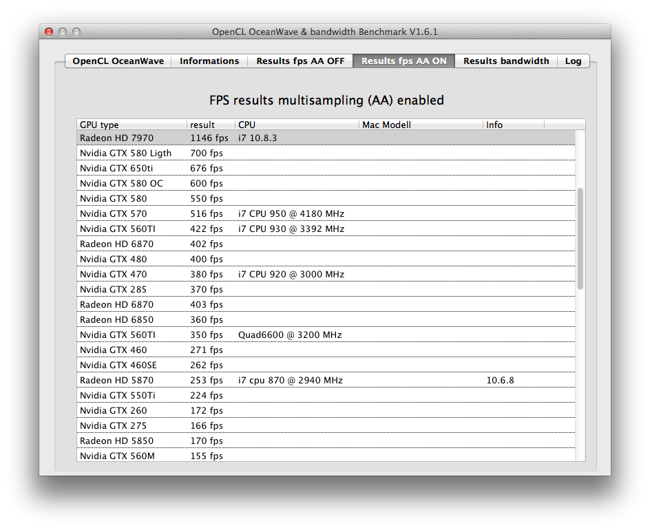

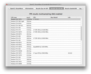

badaxe2 Posted May 12, 2013 Author Share Posted May 12, 2013 Opencl is working fine, Screen shot in a moment, I stated this on 1st post -- opencl benchmark multi-sampling on and off - Link to comment https://www.insanelymac.com/forum/topic/288486-7950-success-almost/page/2/#findComment-1914542 Share on other sites More sharing options...

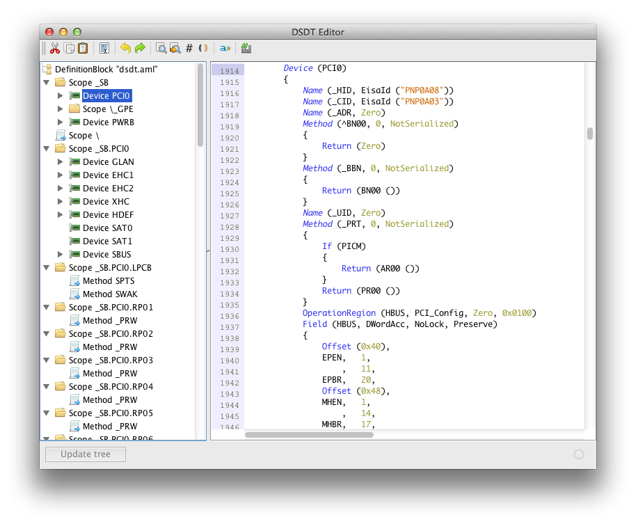

badaxe2 Posted May 12, 2013 Author Share Posted May 12, 2013 Ok Rampage dev, going to do it your way as dsdt seems the best way to go... I am looking for pci0 in my dsdt, cant find it lol... any ideas ? dsdt.aml.zip Link to comment https://www.insanelymac.com/forum/topic/288486-7950-success-almost/page/2/#findComment-1914545 Share on other sites More sharing options...
Rampage Dev Posted May 12, 2013 Share Posted May 12, 2013 Ok Rampage dev, going to do it your way as dsdt seems the best way to go... I am looking for pci0 in my dsdt, cant find it lol... any ideas ? Also your openCL is almost half of what the base score for you card should be. Link to comment https://www.insanelymac.com/forum/topic/288486-7950-success-almost/page/2/#findComment-1914547 Share on other sites More sharing options...
badaxe2 Posted May 12, 2013 Author Share Posted May 12, 2013 actually looks like my card is in PEG0 which is in pci0 Ok Lesson 1, dont use small case letters in dsdt editor, lol Please ignore above post Link to comment https://www.insanelymac.com/forum/topic/288486-7950-success-almost/page/2/#findComment-1914548 Share on other sites More sharing options...
Rampage Dev Posted May 12, 2013 Share Posted May 12, 2013 Yep, so just expand the list and look down until you see it or just search for it within the app. Command F Link to comment https://www.insanelymac.com/forum/topic/288486-7950-success-almost/page/2/#findComment-1914551 Share on other sites More sharing options...

k3nny Posted May 12, 2013 Share Posted May 12, 2013 (edited) Rampage Dev, it would be kind of you to stop shifting the topic. I am stating different facts that you seem to simply ignore. The OpenCL score is perfectly fine if you look at the different benchmarks in the according thread. A 7970 reaches a score of ~700. A score of ~660 is good for a 7950. Let's assume no framebuffer is loaded. The fact is that everything works right now, regardless of the custom framebuffer injection. Until now, badaxe2 did not report any single issue worth mentioning except the anti aliasing bug which is not related to the framebuffer in any way. What I want to see, is some actual proof that injecting a framebuffer will give an advantage in this case. EDIT: The highest OpenCL score is a fake. It was discussed in the according thread. Look at the scores of other cards with a similar performance, it is simply not maintainable! EDIT2: Also there are big fluctuations when running this benchmark. Try it for yourself and run it several times in row. You will get a difference of 20 points for sure, maybe even 40 in the worst case. EDIT3: OpenGL4 won't work as Apple does not fully support it. Edited May 12, 2013 by k3nny Link to comment https://www.insanelymac.com/forum/topic/288486-7950-success-almost/page/2/#findComment-1914556 Share on other sites More sharing options...

Rampage Dev Posted May 12, 2013 Share Posted May 12, 2013 @rampage I get a compile problem when pasting in your code, ?? without your code i get no errors Your pasting over extra code. Rampage Dev, it would be kind of you to stop shifting the topic. I am stating different facts that you seem to simply ignore. The OpenCL score is perfectly fine if you look at the different benchmarks in the according thread. A 7970 reaches a score of ~700. A score of ~660 is good for a 7950. Let's assume no framebuffer is loaded. The fact is that everything works right now, regardless of the custom framebuffer injection. Until now, badaxe2 did not report any single issue worth mentioning except the anti aliasing bug which is not related to the framebuffer in any way. What I want to see, is some actual proof that injecting a framebuffer will give an advantage in this case. EDIT: The highest OpenCL score is a fake. It was discussed in the according thread. Look at the scores of other cards with a similar performance, it is simply not maintainable! EDIT2: Also there are big fluctuations when running this benchmark. Try it for yourself and run it several times in row. You will get a difference of 20 points for sure, maybe even 40 in the worst case. EDIT3: OpenGL4 won't work as Apple does not fully support it. I am not ignoring anything. You just do not understand what a framebuffer does... Also what does luxmark give you? Link to comment https://www.insanelymac.com/forum/topic/288486-7950-success-almost/page/2/#findComment-1914562 Share on other sites More sharing options...

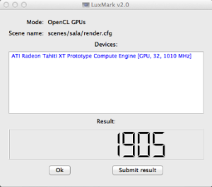

fau7i Posted May 12, 2013 Share Posted May 12, 2013 Okay, here is Luxmark score with generic framebuffer. Clover might plays its role, but to boot back with that framebuffer I have to use GraphicsInjector=No. Link to comment https://www.insanelymac.com/forum/topic/288486-7950-success-almost/page/2/#findComment-1914574 Share on other sites More sharing options...
