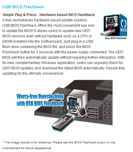

1708 is not the latest BIOS for that board, and don't follow the instructions on the ASUS forum, it's an outdated post from 2007.
Don't you have the manual for your motherboard? Look:
http://event.asus.co..._Features.htm#c
Rule number one: know your hardware.
Get the modified 1805 BIOS from here:
http://biosrepo.word...s.com/asus/z77/
Ok but I really don't understand that link I'm sorry
So you have the file on a usb formatted as FAT32 or FAT. you plug it in and reboot your computer, go into bios and first press F5 to load default settings. Restart again and go into bios press F3 and select easy flash. Wait 20sec and the usb should appear now select the .cap file and it will flash the bios, don't touch the computer or if it's taking long don't power off! When done unplug usb and restart. in bios. Then you need to reset the chipset with C.P.R (have to search around in the bios on that one). load defaults again with F5 and set AHCI and others settings that you need back,
EDIT: Use the way of Gringo Vermelho much more easy.
http://event.asus.co..._Features.htm#c <- all Asus P8Z77 boards have this.
The DSDT that will enable sleep for him is made for bios 1708 that's why.
