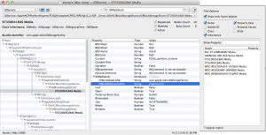

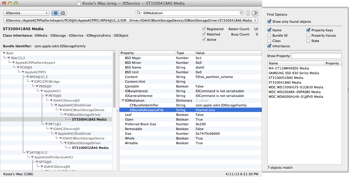

k3nny Posted April 11, 2013 Share Posted April 11, 2013 No, you already supply a custom SSDT file for your boot loader. Have you really overclocked your CPU to 4,8GHz? If not I believe you use a wrong state table. Use this script to generate one for your CPU. According to your new ioreg all drives are marked as internal. Are you sure you still got the wrong icons? Link to comment https://www.insanelymac.com/forum/topic/287799-how-to-go-about-patching-dsdt-for-asus-p8z77-v-pro/page/2/#findComment-1905966 Share on other sites More sharing options...
Kosta88 Posted April 11, 2013 Author Share Posted April 11, 2013 No, you already supply a custom SSDT file for your boot loader. Have you really overclocked your CPU to 4,8GHz? If not I believe you use a wrong state table. Use this script to generate one for your CPU. According to your new ioreg all drives are marked as internal. Are you sure you still got the wrong icons? Hehe, yeah really running 4.8 and the ssdt is created through that script. Funny what you say about the drives... Can you tell me how do you read that out exactly? Link to comment https://www.insanelymac.com/forum/topic/287799-how-to-go-about-patching-dsdt-for-asus-p8z77-v-pro/page/2/#findComment-1905985 Share on other sites More sharing options...
k3nny Posted April 11, 2013 Share Posted April 11, 2013 Take a look at the IORegistryExplorer. Open device path PCI0-RP04-PXSX. That's your ASMedia SATA controller with 2 ports PRT0 and PRT1. Expand both until you can see the hard drive product name and click it. On the right side you will see a property named IOMediaIcon which will either point to an "Internal.icns" or an "External.icns" icon file. The Intel SATA ports are at PCI0-SAT0 and range from SPT0 to SPT5. The first ioreg dump you sent me showed external icons for the ASMedia chipset but the last one shows that internal icons are used. Link to comment https://www.insanelymac.com/forum/topic/287799-how-to-go-about-patching-dsdt-for-asus-p8z77-v-pro/page/2/#findComment-1905991 Share on other sites More sharing options...
Kosta88 Posted April 11, 2013 Author Share Posted April 11, 2013 Well, I don't know really any more. I was test-installing today, the thing you helped me with, I was in a fresh install of OSX. However, I might have in the middle of testing installed the AHCI 3rd party drivers from MB, which actually solve the issue, making drives internal. Hot-swapping is killed however, and this is what I was trying to avoid. I am now back in my "old" install, I just used Acronis boot USB to switch back, I do that a lot ;-) Takes all about 20min... I just checked in my "old" install, the icons are internal when drivers kext is installed, they go external when I remove it. Also when I install the olarila patch into dsdt, one drive gets a normal icon, but the other two are still orange. All in all, very weird. I might just as well do a full normal install soon, now that I'm almost done with all the tests. Link to comment https://www.insanelymac.com/forum/topic/287799-how-to-go-about-patching-dsdt-for-asus-p8z77-v-pro/page/2/#findComment-1906023 Share on other sites More sharing options...
