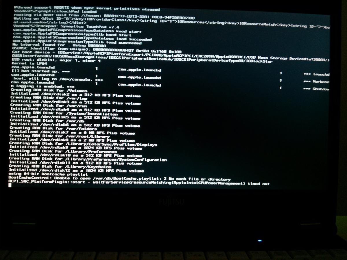

Bierfreund Posted April 10, 2013 Share Posted April 10, 2013 I created a bootable USB Stick of Mountain Lion 10.8.3 with ##### (where i checked "Laptop Support" during the creation process). Stick should be OK, i already did this one day before for my PC Installation (on a Gigabyte GA-Z77-DS3H with UEFI). The sticks boots, I select the USB Stick at Chimera Boot Menu and then the boot hangs at the screen with the apple logo and the spinning wheel... Of course I tried booting with -x -v and PCIRootUID=1. I also disabled all devices in BIOS that are not needed (disabled LAN, WLAN, Bluetooth, UMTS). No difference, installation hangs with the devices enabled and disabled. I took a photo of the last output i get, when trying to boot with -v (in the photo all devices that could be disabled are disabled, if the are enabled i get a additional line about the LAN adapter "E1000.... MAC-address..." but no error. I can make antoher photo if it helps. Also i get CMOS checksum error after every boot from the Mountain Lion Stick. Hardware of my Laptop: CPU: Intel® Core i5-540M Chipset: Intel® QM57 Video: Intel Graphics Media Accelerator HD (Intel HD Graphics) Audio: Realtek ALC269 LAN: Intel 82577LM WLAN: Atheros AR9287 UMTS: Sierra Wireless Gobi 2000 Data Sheet: http://docs.ts.fujitsu.com/dl.aspx?id=7aaa9e20-d5e7-4ef1-8907-f8ce45392295 Should i use additional paramaters in the boot screen? Do i have to add files/kexts to the stick? Link to comment https://www.insanelymac.com/forum/topic/287786-ml-install-boot-hangs-on-fujitsu-lifebook-s760-notebook/ Share on other sites More sharing options...
Rogiervd Posted April 10, 2013 Share Posted April 10, 2013 You have FakeSMC and AppleIntelCPUPowerManagement? Link to comment https://www.insanelymac.com/forum/topic/287786-ml-install-boot-hangs-on-fujitsu-lifebook-s760-notebook/#findComment-1905481 Share on other sites More sharing options...
Bierfreund Posted April 10, 2013 Author Share Posted April 10, 2013 I added nothing manually, don't know at the moment if ##### does add this automatically during the USB-Stick creation process. (Created the stick according to the guides linked here: http://wiki.osx86project.org/wiki/index.php/Installation_Guides#10.8.2_Guides) As far as i know FakeSMC and AppleIntelCPUPowerManagement are installed by ##### after the initial Mountain Lion setup. How can I add this manually to the installation stick, or check if it is already included? Link to comment https://www.insanelymac.com/forum/topic/287786-ml-install-boot-hangs-on-fujitsu-lifebook-s760-notebook/#findComment-1905483 Share on other sites More sharing options...
Rogiervd Posted April 10, 2013 Share Posted April 10, 2013 I don't think it installs them automatically. But here are the files you can try put onto your USB/HDD: http://www.4shared.com/zip/lNWvWI63/AppleIntelCPUPowerManagementke.html? and http://www.4shared.com/zip/sUods2vW/FakeSMCkext.html? If that doesn't work try creating your USB with Pandora from Insanelymac download section, it works much better in my opinion. Link to comment https://www.insanelymac.com/forum/topic/287786-ml-install-boot-hangs-on-fujitsu-lifebook-s760-notebook/#findComment-1905495 Share on other sites More sharing options...

Tikifg Posted April 11, 2013 Share Posted April 11, 2013 Had the same problem when installing. pulled out the USB-thumb drive and reinserted it and it continued installing. If that does not help, try booting with -f -v GraphicsEnabler=No KernelCache=No Link to comment https://www.insanelymac.com/forum/topic/287786-ml-install-boot-hangs-on-fujitsu-lifebook-s760-notebook/#findComment-1905834 Share on other sites More sharing options...
