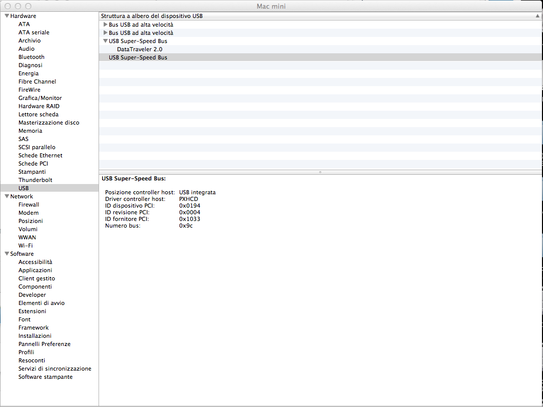

Perdu Posted March 27, 2013 Author Share Posted March 27, 2013 salve Carbo178 adesso collego qualsiasi cosa e mi vede tutto, ti allego uno screen, controlli se è corretto secondo te Grazie Perdu Link to comment https://www.insanelymac.com/forum/topic/287400-risolto-problema-con-necrenesas-usb-30/#findComment-1901365 Share on other sites More sharing options...
carbo178 Posted March 27, 2013 Share Posted March 27, 2013 Beh, direi che va bene... Se non sorgono inconvenienti metti [Risolto] al titolo Link to comment https://www.insanelymac.com/forum/topic/287400-risolto-problema-con-necrenesas-usb-30/#findComment-1901388 Share on other sites More sharing options...
