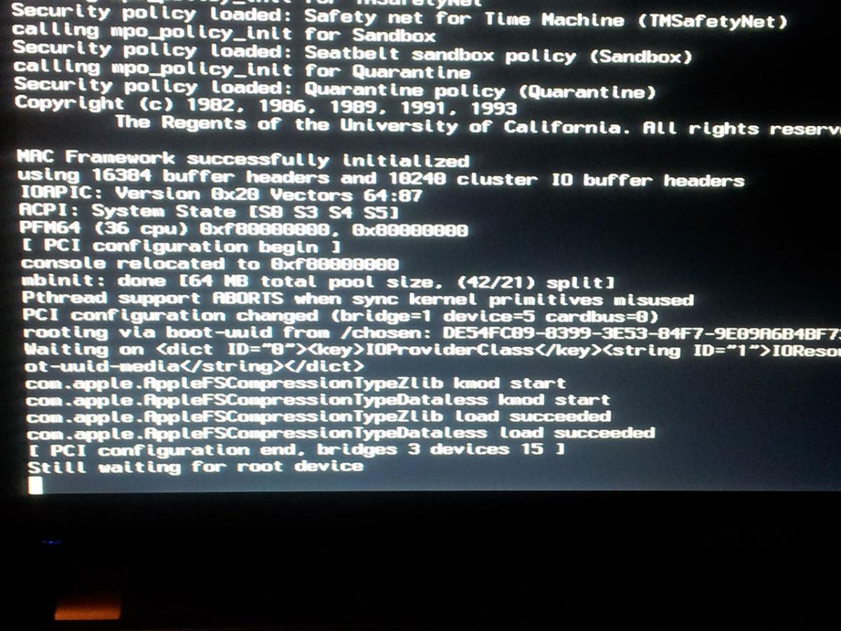

nomad83 Posted February 20, 2013 Share Posted February 20, 2013 Hi, I try to install Mountain Lion 10.8.2 on my laptop Acer Aspire V3-571G. Here's the specs, even if they are in my sig : CPU : Intel i7 3610QM 2.3GHz with Turbo Boost up to 3.3GHz GPU : HD4000 integrated / Nvidia GT 640M working both with Optimus Technology3 Memory : 8Gb DDR3 Ram Network : Broadcom BCM43228 Audio : Realtek ALC269 Wifi : Broadcom BCM43228 Hard Drive : 750Gb SATA II (or III ?) Partition Sheme : Windows 8 EFI NTFS Primary Windows 8 NTFS Primary OSX FAT32 Primary Active Data NTFS Logical Not many options in BIOS, only switch for GPU (Switchable/Integrated) and AHCI/IDE. Actually they are set to Integrated and AHCI. What I do Well, I do so many things I can remember exactly what. I try to expose the problem clearly. Early install with Tony tools was successfull, only problems with chameleon at boot... Tired of the tools I decided to make it work myself, with insanelymac support off course. The laptop had already boot some Mac OS X Mountain Lion before this, it can handle it. I follow your installation guide twice. I follow this guide on Mac OS X Mountain Lion VMware Workstation. I attach the ready USB Key to my laptop, booting up and select the key with -v flag and got Kernel Panic related to AppleCPUPowerManagement.kext. Isn't weird ? I have NullPowerManagement.kext installed. So, no problem, I delete AppleCPUPowerManagement.kext but now facing another error I see already : PCI Configuration begin .... Still Waiting for root device... I think about AHCIPortInjector.kext but I really don't know if it's the good solution. I put AHCI_Extended_Injector.kext System/Library/Extentions but same error... I also have a weird error since my first install of OS X on this laptop : "Error Encountered While Starting Up... Pausing5 Seconds..." Here I am, i'm sick and this is my only occupation at the moment. Hope you can see what's wrong. Thanks for your help. Best regards. Jeremy. Edit 20/02/2013 : I tried this flags : -v npci=0x2000 GraphicsEnabler=No Darkwake=0 busratio=23 PCIRootUID=1 Stil waiting for root device ... Really frustrating. Link to comment https://www.insanelymac.com/forum/topic/286520-acer-aspire-v3-571g-still-waiting-for-root-device/ Share on other sites More sharing options...

nomad83 Posted February 20, 2013 Author Share Posted February 20, 2013 Welcome on my boat mate. Just tried Myhack on another USB key, Still waiting for root device ... Same screen again ... Link to comment https://www.insanelymac.com/forum/topic/286520-acer-aspire-v3-571g-still-waiting-for-root-device/#findComment-1890643 Share on other sites More sharing options...

nomad83 Posted February 20, 2013 Author Share Posted February 20, 2013 Thanks for your help. Just tried UseKernelCache=No same error again and again ... Just like the picture I posted on 1st post. Thanks anyway. Link to comment https://www.insanelymac.com/forum/topic/286520-acer-aspire-v3-571g-still-waiting-for-root-device/#findComment-1890675 Share on other sites More sharing options...

nomad83 Posted February 20, 2013 Author Share Posted February 20, 2013 Tried again with "Tony Tools" and it's working... SO, there's one or more kext missing imho , maybe related to USB or AHCI ? But how can I be sure. In Extra folder created by "the one we can't tell the name" I can find some AHCI, related kexts, IOUSBFamily, etc... So maybe try to add theses kexts to the Extra folder of my clean USB drive ? Thanks for your help. Cheers. EDIT : Ok, as I think, simply put the TT Extra folder on my clean USB drive build with Insanelymac and it's booting. So there's a kext inside this folder I need to boot. Can I show you the list of the Kexts inside this folder ? EDIT 2 : After installation back to Stil waiting for root Device ... Just after [PCI configuration end, bridges 3 devices 12] Booting fine with -f -v UseKernelCache=no Link to comment https://www.insanelymac.com/forum/topic/286520-acer-aspire-v3-571g-still-waiting-for-root-device/#findComment-1890690 Share on other sites More sharing options...
