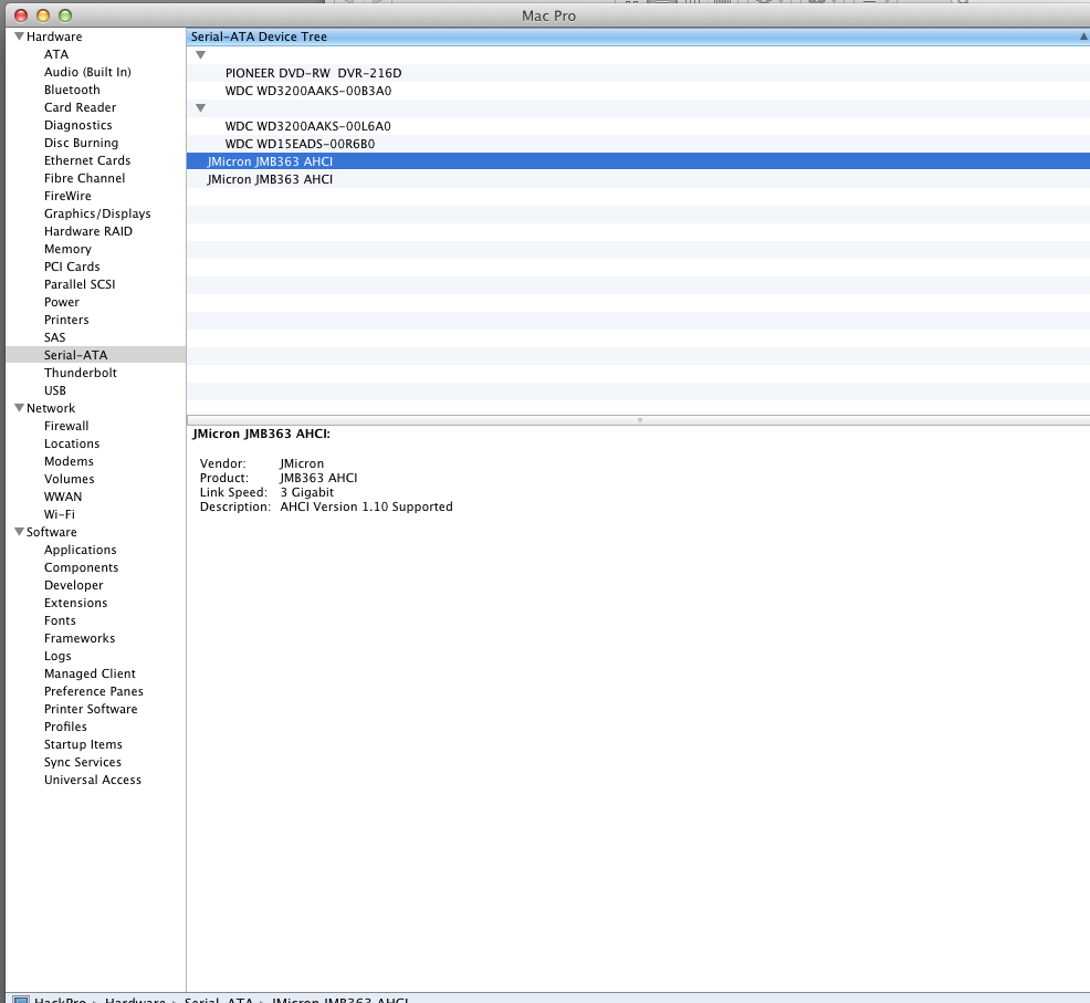

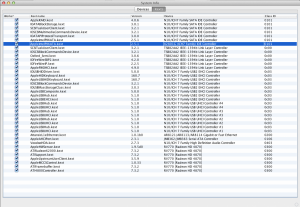

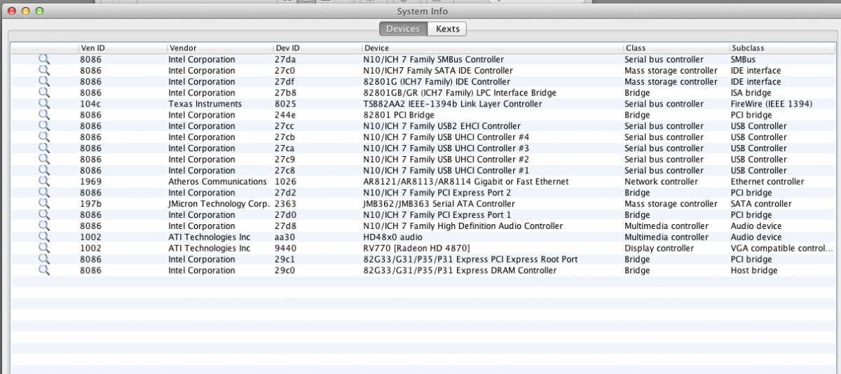

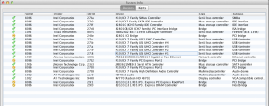

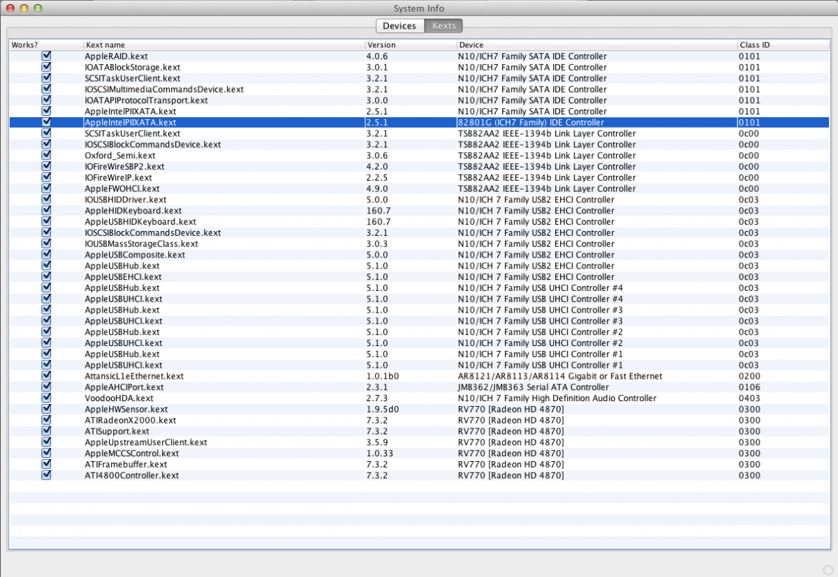

grug Posted February 15, 2013 Share Posted February 15, 2013 I'm running Lion 10.7.5 now on my machine. most of the stuff works except the Vanctec 4+1 pci-e sata internal and external ports. I've read most of the threads yet i'm still unsure if it's just i have the wrong kexts installed... I already have 3 hard drives and my dvd burner on the sata ports of the board. But I would love to solve this issue because I want to add anothe 1tb drive to do another raid 0 set and a SSD later on, and also use the external drives that use e-sata. I dont plan tu use the raid card functions so far... I currently have HDD1 and HDD 2 320 G Raid set HDD3 a 1.5 T. The PCI-E is model is a UGT1s100R I've put screen shots here that may help you help me Mobo is a Asuz p5kpl-cm https://Screen Shot 2013-02-15 at 4.21.14 PM.png HackPro.txt Link to comment https://www.insanelymac.com/forum/topic/286406-hi-guys-a-little-pci-e-stat-help/ Share on other sites More sharing options...
eep357 Posted February 16, 2013 Share Posted February 16, 2013 make sure all controllers are set to AHCI mode in bios (right now looks like in IDE mode) then use this. AHCI_Extended_Injector.kext 4.zip 1 Link to comment https://www.insanelymac.com/forum/topic/286406-hi-guys-a-little-pci-e-stat-help/#findComment-1889356 Share on other sites More sharing options...
grug Posted February 16, 2013 Author Share Posted February 16, 2013 Thanks man, I've flashed the bios to the latest version for the mobo, hoping I would have ahci commands in there before I upgraded from 10.5.8 to Lion, but as far as I know there are none in it...but I see JMicron jmb 363 AHCI in Sys Report pane . No pci card recognized...well you saw the screen shot. Somwhere on the Asus site I read you can add AHci drivers can under windows...but I have no windows partition installed anywhere? There must be a work around? In the bios the IDE configuration is set to enhanced with enhanced mode support on s-ata.... Anf for this next do i install it in extra or s/l/e. I'm on software raid...in case this means I can't add kext from the Raid OSX Lion bootable Array or I have to insatll it on the separate raid partitions.... Link to comment https://www.insanelymac.com/forum/topic/286406-hi-guys-a-little-pci-e-stat-help/#findComment-1889492 Share on other sites More sharing options...
grug Posted February 16, 2013 Author Share Posted February 16, 2013 Tried your kext from the bootable unified Raid array, no luck...does not seem like it changed anything...do i have to intall this new next by booting from a usb drive, going into raid 1 partition from there, install with next wizard, repair permissions reboot and do that again on the raid 2 partition for this to work... Link to comment https://www.insanelymac.com/forum/topic/286406-hi-guys-a-little-pci-e-stat-help/#findComment-1889558 Share on other sites More sharing options...
