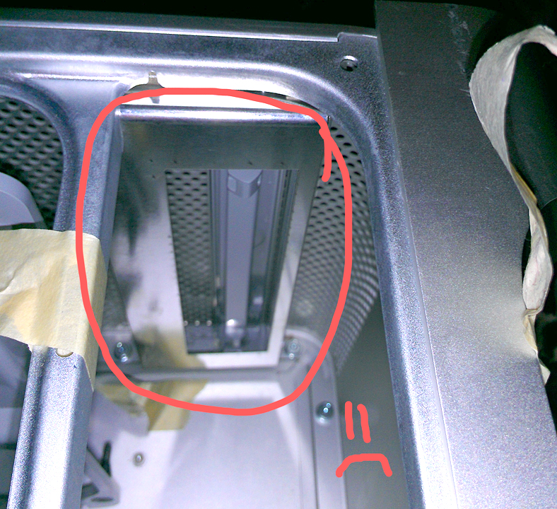

Ira Aduro Posted February 15, 2013 Share Posted February 15, 2013 (edited) This tutorial has been moved to the [HOW-TO]s subforum above. This thread is for the discussion of the above tutorial. If you have any comments to add to the tutorial, please do so here. THANK YOU! Anyone know how in the world to remove the aluminum shielding that goes around the pop down dvd bay? I can see the aluminum shielding has two clips on the bottom that pop out but I can't seem to get it out and don't want to bend it. Photo attached of what I'm talking about. Thanks. Edited March 16, 2013 by Mr.D. Tutorial Promoted! Link to comment https://www.insanelymac.com/forum/topic/286402-discussion-of-how-to-remove-dvd-bezel-on-g5-powermac/ Share on other sites More sharing options...
Baudouin Posted February 15, 2013 Share Posted February 15, 2013 At the top of the shielding, there are also two little clips that must be freed from the top case. You must move the shielding from the left to right after freeing it from the bottom and finally freeing from the top. Link to comment https://www.insanelymac.com/forum/topic/286402-discussion-of-how-to-remove-dvd-bezel-on-g5-powermac/#findComment-1889228 Share on other sites More sharing options...

Ira Aduro Posted February 16, 2013 Author Share Posted February 16, 2013 Thank you! I'll prob not get to try this till tomorrow but thanks for showing me how. Link to comment https://www.insanelymac.com/forum/topic/286402-discussion-of-how-to-remove-dvd-bezel-on-g5-powermac/#findComment-1889330 Share on other sites More sharing options...
Baudouin Posted February 16, 2013 Share Posted February 16, 2013 No problemo. In fact at the bottom of the shielding there are two pins, but at the top, there are two small holes. 1 Link to comment https://www.insanelymac.com/forum/topic/286402-discussion-of-how-to-remove-dvd-bezel-on-g5-powermac/#findComment-1889400 Share on other sites More sharing options...
Ira Aduro Posted February 16, 2013 Author Share Posted February 16, 2013 Just wanted to say I got it out, and I took some photos highlighting the pins and such. WhattheTech is going to post a guide on his site so others can do this. 2 Link to comment https://www.insanelymac.com/forum/topic/286402-discussion-of-how-to-remove-dvd-bezel-on-g5-powermac/#findComment-1889421 Share on other sites More sharing options...
