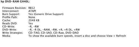

Shaneee Posted January 14, 2013 Share Posted January 14, 2013 I am having problems with my DVD Burner. It is detected and will read discs but it won't burn anything to disc. I always get a message about loosing communication or something like that. I have a NForce Chipset which I use AppleNForceATA for it to work. Thanks Link to comment https://www.insanelymac.com/forum/topic/285669-dvd-burner-wont-burn-discs/ Share on other sites More sharing options...
