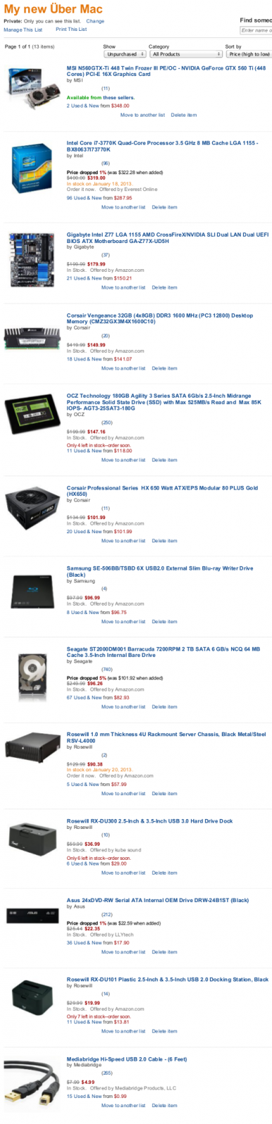

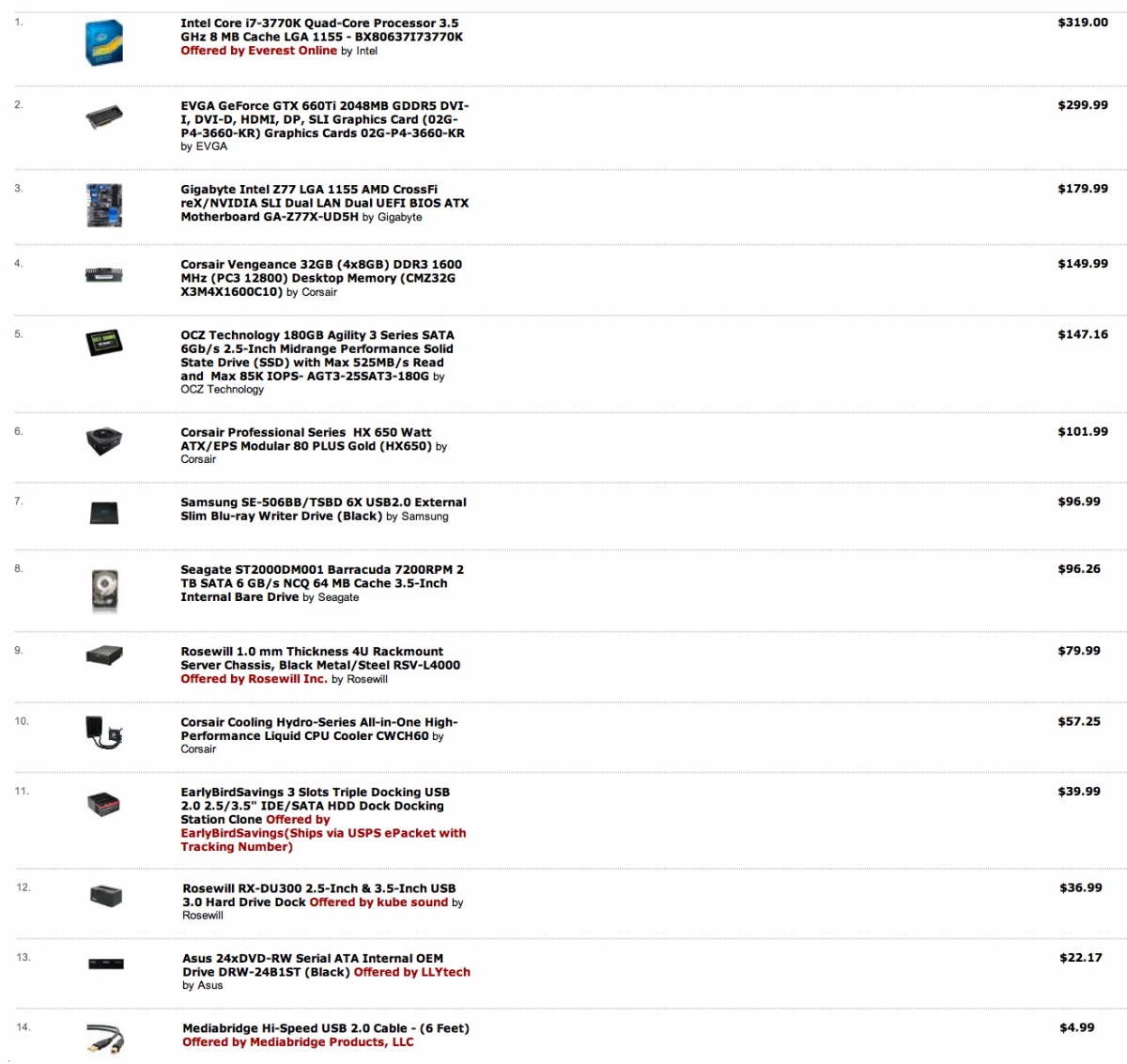

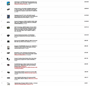

Dee_Ann Posted January 15, 2013 Author Share Posted January 15, 2013 This is what I'm looking at getting.. MSI N560GTX-Ti 448 Twin Frozer III PE/OC - NVIDIA GeForce GTX 560 Ti (448 Cores) PCI-E 16X Graphics Card by MSI Computer Corp. $348 Intel Core i7-3770K Quad-Core Processor 3.5 GHz 8 MB Cache LGA 1155 - BX80637I73770K Offered by Everest Online by Intel $319.00 Gigabyte Intel Z77 LGA 1155 AMD CrossFireX/NVIDIA SLI Dual LAN Dual UEFI BIOS ATX Motherboard GA-Z77X-UD5H by Gigabyte $179.99 Corsair Vengeance 32GB (4x8GB) DDR3 1600 MHz (PC3 12800) Desktop Memory (CMZ32GX3M4X1600C10) by Corsair $149.99 OCZ Technology 180GB Agility 3 Series SATA 6Gb/s 2.5-Inch Midrange Performance Solid State Drive $147.16 Corsair Professional Series HX 650 Watt ATX/EPS Modular 80 PLUS Gold (HX650) by Corsair $101.99 Samsung SE-506BB/TSBD 6X USB2.0 External Slim Blu-ray Writer Drive (Black) by Samsung $96.99 Seagate ST2000DM001 Barracuda 7200RPM 2 TB SATA 6 GB/s NCQ 64 MB Cache 3.5-Inch Internal Bare Drive by Seagate $96.26 Rosewill 1.0 mm Thickness 4U Rackmount Server Chassis, Black Metal/Steel RSV-L4000 by Rosewill $90.38 Rosewill RX-DU300 2.5-Inch & 3.5-Inch USB 3.0 Hard Drive Dock Offered by kube sound by Rosewill $36.99 Asus 24xDVD-RW Serial ATA Internal OEM Drive DRW-24B1ST (Black) Offered by LLYtech by Asus $22.35 Rosewill RX-DU101 Plastic 2.5-Inch & 3.5-Inch USB 2.0 Docking Station, Black by Rosewill $19.99 Mediabridge Hi-Speed USB 2.0 Cable - (6 Feet) Offered by Mediabridge Products, LLC So far it looks like I'm around the $1,600 mark, more or less. The mobo comes with sata cables but it doesn't say if they are sata III or II. I'm hoping at least one of them will be sata III.. I assume so because I saw that two of them are light blue in color and two are black. The Rosewill docks comes with cables so that's good. The blu-ray writer doesn't so I went ahead and planed on a new one for it, just to be sure. I have cables here but they are old and scattered all over the place. Good luck finding them.. As for all my old drives, I have plenty of sata cables for them and eventually I plan to clean them up and I'll end up with spare drives and cables.. I don't think I've overlooked anything. But if you see any glaring omissions please speak up.. Thanks! edit: I almost forgot. I have a genuine Apple wireless keyboard and trackpad, they are pretty new, I ordered them directly from Apple in mid 2012, I guess it was around August. I also have a genuine Apple mouse, it's a USB model, #A1152 that I often have to resort to when the battery in the trackpad dies. Once it would die it would not reconnect to the trackpad without cycling power on the machine. The bluetooth dongle is an iogear GBU421. Is there a better one? Link to comment https://www.insanelymac.com/forum/topic/285667-building-a-new-machine-looking-for-advice/#findComment-1880926 Share on other sites More sharing options...
Mr.D. Posted January 15, 2013 Share Posted January 15, 2013 Why external BluRay? Do you just wanting that closer to your workspace? I used to do that with a DVD drive and a FireWire enclosure that sat under my monitor so I didnt have to access my machine. I went to Roswell's website and saw that it supports 3 5.25" bays. I wouldn't assume those cables are SATA 3.0 cables. My motherboard and the tester case I bought both came with cables, but never specified. I have bought about 20 cables thus far, trying to get the right length, color, and left vs. right angle - but all were SATA 3.0 and all were less that $3 each. With as much pounding as you do to your machine, sounds like you could definitely use an SSD. I saw the photo editing, but didn't know about the video, and yeah - that's gonna eat up your RAM real quick-like. Only way to get more than 32GB is go the x79 route (using the core extreme processor which is just a Xeon). I know the boards are expensive, but the procs are also quite spendy as well. Guess its a matter of price vs performance at that point, and you're getting as much bang for your buck as you can with the z77 and the unlocked i7. With regards to mentioning 'he who shall not be named' and his products - its not that you cant mention him, its just that we dont support him or his methods. Mentioning TonyMacx86 as a reference for a system that didn't work would never be an issue. Good luck with the build - I wish I could build your system. It should be a sweet ride. As always, ask way when/if you run into any snags. Welcome! अभिनंदन 1 Link to comment https://www.insanelymac.com/forum/topic/285667-building-a-new-machine-looking-for-advice/#findComment-1880956 Share on other sites More sharing options...
Dee_Ann Posted January 15, 2013 Author Share Posted January 15, 2013 I did a little tweaking to my list and selected a different video card, eliminated some redundant items and added a few things. As for the Blu-ray, I was thinking that it would be best to have it external so I can move it to other machines if I need to. BUT, having an internal sata burner would probably be more reliable and faster. I have a few hours to think it over, I'm ordering about 10am.. Also, I think I will order a few sata III cables just to be safe.. Thanks! Link to comment https://www.insanelymac.com/forum/topic/285667-building-a-new-machine-looking-for-advice/#findComment-1880958 Share on other sites More sharing options...
Mr.D. Posted January 15, 2013 Share Posted January 15, 2013 GPU with more than 2GB of RAM, go here. Its just a laptop drive - I don't think that reliability will be an issue. As long as you aren't planning on abusing it, normal wear and tear should be fine. I have always liked the idea of having an external drive that's easier to get to. My drive in my G5 case is a PITA to get to. 1 Link to comment https://www.insanelymac.com/forum/topic/285667-building-a-new-machine-looking-for-advice/#findComment-1880963 Share on other sites More sharing options...
Dee_Ann Posted January 15, 2013 Author Share Posted January 15, 2013 GPU with more than 2GB of RAM, go here. Its just a laptop drive - I don't think that reliability will be an issue. As long as you aren't planning on abusing it, normal wear and tear should be fine. I have always liked the idea of having an external drive that's easier to get to. My drive in my G5 case is a PITA to get to. Ooooooh.... I see the graphics card will be a challenge... Ouchy.... I'll be needing some help to set this all up, thank you for the heads up! I'm not much on programming, hardware I can deal with. Software frustrates me. I was a hardware tech once upon a time, many moons ago. I was never a programmer. My frustration level is low. That's why I don't work for anyone anymore. Actually, the more I think about it, the more I'm thinking that an internal BD burner would be a better option. I like the idea of being able to move it to other machines but I really don't think I would be doing that very often. And it would be less clutter and less junk plugged into an AC outlet.. Going with an internal BD burner saves me $30 and an AC outlet. One of the many great things about the rack mount case I'm getting is that the optical drives mount horizontally. In my old case I had them vertically and they were trouble. Not to mention I couldn't put those mini-CD's in them. Even using normal discs was a problem and like 8/10 times even when the drive was empty it wouldn't eject. That was annoying. A few times a disc fell out of the tray into the drive and I had HELL fishing the disc out. With the new case and horizontal drives this problem will be history.. I'm liking this already! Link to comment https://www.insanelymac.com/forum/topic/285667-building-a-new-machine-looking-for-advice/#findComment-1880967 Share on other sites More sharing options...

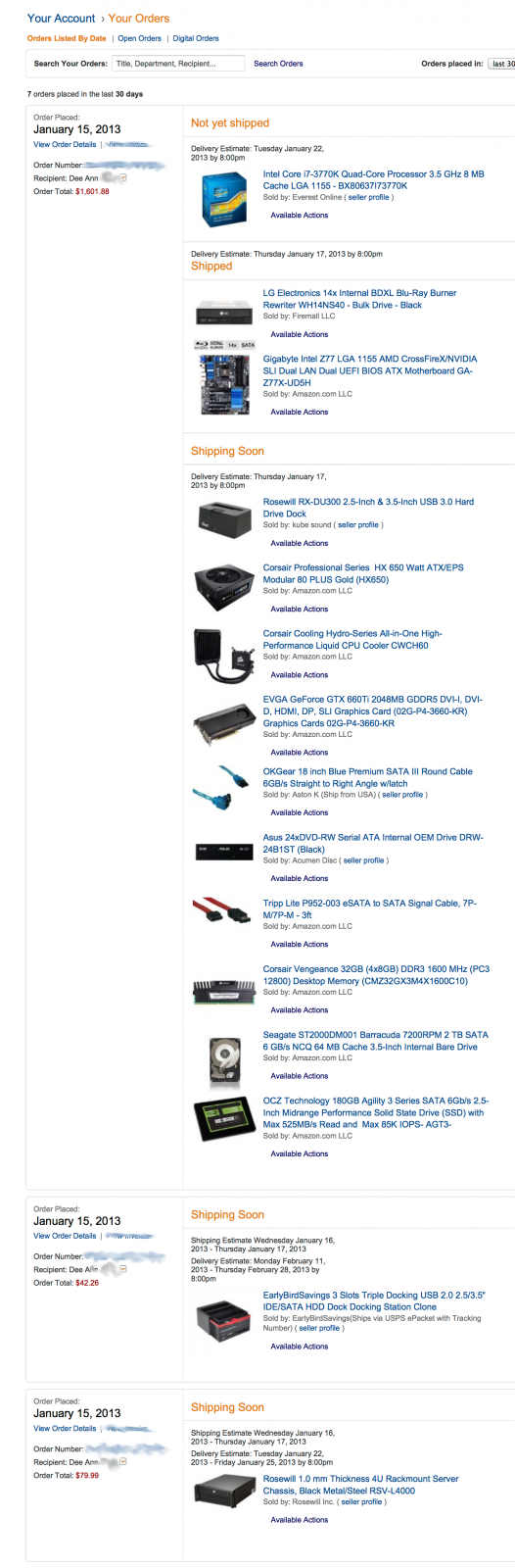

Dee_Ann Posted January 16, 2013 Author Share Posted January 16, 2013 Got my stuff ordered today! Woo hoo !! ------------------------------------------------------ 1 of: Intel Core i7-3770K Quad-Core Processor 3.5 GHz 8 MB Cache LGA 1155 - BX80637I73770K $320.00 1 of: Gigabyte Intel Z77 LGA 1155 AMD CrossFireX/NVIDIA SLI Dual LAN Dual UEFI BIOS ATX Motherboard GA-Z77X-UD5H $180.98 1 of: Rosewill 1.0 mm Thickness 4U Rackmount Server Chassis, Black Metal/Steel RSV-L4000 $79.99 1 of: Rosewill RX-DU300 2.5-Inch & 3.5-Inch USB 3.0 Hard Drive Dock $36.99 1 of: Corsair Professional Series HX 650 Watt ATX/EPS Modular 80 PLUS Gold (HX650) $101.99 1 of: Corsair Cooling Hydro-Series All-in-One High-Performance Liquid CPU Cooler CWCH60 $60.25 1 of: EVGA GeForce GTX 660Ti 2048MB GDDR5 DVI-I, DVI-D, HDMI, DP, SLI Graphics Card (02G-P4-3660-KR) Graphics Cards 02G-P4-3660-KR $299.99 2 of: OKGear 18 inch Blue Premium SATA III Round Cable 6GB/s Straight to Right Angle w/latch $9.18 1 of: Asus 24xDVD-RW Serial ATA Internal OEM Drive DRW-24B1ST (Black) $22.39 4 of: Tripp Lite P952-003 eSATA to SATA Signal Cable, 7P-M/7P-M - 3ft $19.84 1 of: Corsair Vengeance 32GB (4x8GB) DDR3 1600 MHz (PC3 12800) Desktop Memory (CMZ32GX3M4X1600C10) $163.79 1 of: Seagate ST2000DM001 Barracuda 7200RPM 2 TB SATA 6 GB/s NCQ 64 MB Cache 3.5-Inch Internal Bare Drive $96.05 1 of: OCZ Technology 180GB Agility 3 Series SATA 6Gb/s 2.5-Inch Midrange Performance Solid State Drive (SSD) with Max 525MB/s Read and Max 85K IOPS- AGT3- $147.16 1 of: LG Electronics 14x Internal BDXL Blu-Ray Burner Rewriter WH14NS40 - Bulk Drive - Black $75.70 1 of: EarlyBirdSavings 3 Slots Triple Docking USB 2.0 2.5/3.5" IDE/SATA HDD Dock Docking Station Clone $39.99 Unfortunately, according to Amazon, things will be trickling in all week and it will very likely be late next week before I can start to assemble it. The case which I absolutely MUST HAVE, won't ship until the middle of next week. Without it there's nothing at all I can do. Same with the CPU. It won't be here until late next week.. But, at least the ball is rolling now.. So, when all the goodies are in I'll be looking to you guys for help setting it up.. Link to comment https://www.insanelymac.com/forum/topic/285667-building-a-new-machine-looking-for-advice/#findComment-1881194 Share on other sites More sharing options...
