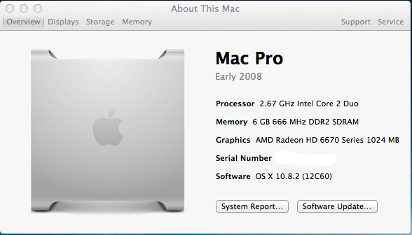

Frankwolfe Posted January 19, 2013 Share Posted January 19, 2013 Hello, I have this same problem, in a way. For ages I just left it as the default GraphicsEnabler=No (in both Lion and ML) because everytime I'd try to fix the whole 6xxx in info it'd do the Black screen bit. The way i fixed it was to do all above (set the driver kext, Bulrushes, Ati ports=3 and GraphicsE=yes after this It booted into the normal black screen. I figured i'd try different wires.. cause you know, who knows if it's actually going to go out through HDMI or VGA. Nothing worked. What ended up working was hooking both DVI and HDMI up at the same time and have them both go to my monitor. Unplug one they both go out, So that's my fix. after that i set the screen to mirror. in case it woke up on the opposite connection. until i get another monitor. Link to comment https://www.insanelymac.com/forum/topic/285634-amd-radeon-6670-blackscreens-after-booting/#findComment-1882163 Share on other sites More sharing options...
