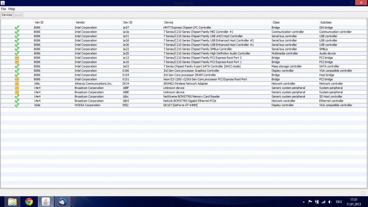

stefunny92 Posted January 11, 2013 Share Posted January 11, 2013 Hardware-Info: http://www.acer.de/ac/de/DE/content/model-datasheet/NX.RZNEG.010 Hi, my problem is that my Aspire 571G V3 shall supports only insufficient. I have looking for all the time and can't find a solution about my problem. Unfortunately without success. I would be grateful if you could help me. Even Aunt Google could not help me. I would be happy if someone would have a DSDT or a solution. I thank your for help. Link to comment Share on other sites More sharing options...
iFIRE Posted January 11, 2013 Share Posted January 11, 2013 Welcome to Insanelymac Forun stefunny92 !!!!!! but you need post more info, " my Aspire 571G V3 shall supports only insufficient??? "first , please put your hardware in your signature, then we can help you, for example: what version the system you have installed? what method you use?etc... Link to comment Share on other sites More sharing options...
stefunny92 Posted January 12, 2013 Author Share Posted January 12, 2013 I have changed my signature and you can see all the information about my pc. I use the lion version 10.7.4. I would like to use the DSDT for this, but it not exist a DSDT for my pc. That's why I used the standard DSDT from Chameleon-2.1-r2069. Link to comment Share on other sites More sharing options...

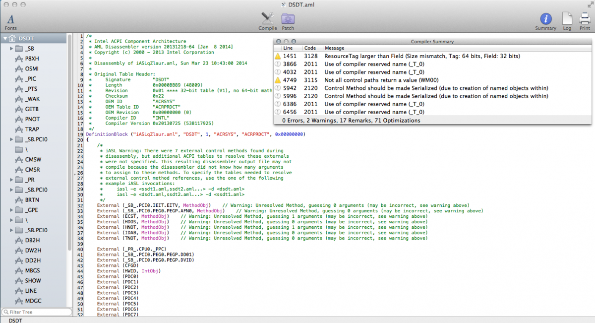

BashOrg Posted March 19, 2014 Share Posted March 19, 2014 Hi there! I've got the same machine and run into same trouble. I've got freshly dumped DSDT from AIDA64 and here is it: https://dl.dropboxusercontent.com/u/15547165/ACER%20V3-571G%20DSDT.aml.zip I cannot patch it with DSDTFixer v1.2.3 because of the error: Intel ACPI Component Architecture ASL Optimizing Compiler version 20110211-32 [Feb 12 2011] Copyright (c) 2000 - 2011 Intel Corporation /Applications/DSDTFixer.app/Contents/Resources/files/dsdt.dsl 2180: Name (_HID, "1025075") Error 4124 - Non-hex letters must be upper case ^ (1025075) /Applications/DSDTFixer.app/Contents/Resources/files/dsdt.dsl 4628: Method (WM00, 3, NotSerialized) Warning 1088 - Not all control paths return a value ^ (WM00) ASL Input: - 12436 lines, 438430 bytes, 4722 keywords Compilation complete. 1 Errors, 1 Warnings, 0 Remarks, 38 Optimizations and I already sent report. By the way, I am writing this post running OS X 10.8.5 on my machine after successful hackintosh installation using Tonies Tools with NullCpuPowerManagement and all the starter things to get it running and I hope to improve the installation using right DSDT. But the problem is this is my first hackintosh experience and I know nothing about patching DSDT by hands so any help would be greatly appreciated. Now the thing I need most is truly disabling my Nvidia Graphics Card (it should not appear in system information) because now I simply removed the nvidia kexts and despite the fact that OS X is running normally, Nvidia card is still draining the battery. Thanks! Link to comment Share on other sites More sharing options...

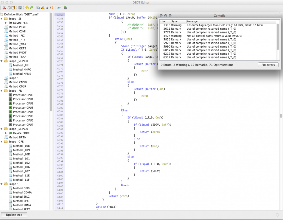

iFIRE Posted March 19, 2014 Share Posted March 19, 2014 ok, no errors now, only warnings, but it not important, I not applied any pach, only solve the error no Errors.zip Link to comment Share on other sites More sharing options...
BashOrg Posted March 23, 2014 Share Posted March 23, 2014 ok, no errors now, only warnings, but it not important, I not applied any pach, only solve the error The same error with your version. Exactly the same output. Size of original file: 40,030 bytes Size of noErrors file: 40,009 bytes Error: Intel ACPI Component Architecture ASL Optimizing Compiler version 20110211-32 [Feb 12 2011] Copyright (c) 2000 - 2011 Intel Corporation /Applications/DSDTFixer.app/Contents/Resources/files/dsdt.dsl 2180: Name (_HID, "1025075") Error 4124 - Non-hex letters must be upper case ^ (1025075) /Applications/DSDTFixer.app/Contents/Resources/files/dsdt.dsl 4628: Method (WM00, 3, NotSerialized) Warning 1088 - Not all control paths return a value ^ (WM00) ASL Input: - 12435 lines, 438358 bytes, 4721 keywords Compilation complete. 1 Errors, 1 Warnings, 0 Remarks, 36 Optimizations Link to comment Share on other sites More sharing options...
iFIRE Posted March 23, 2014 Share Posted March 23, 2014 no errors here, with MacIasl and DSDT Editor, update your editor. Link to comment Share on other sites More sharing options...
