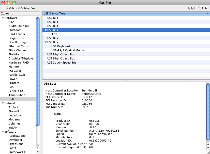

Tona102 Posted January 9, 2013 Share Posted January 9, 2013 Ok, i don't have time toexplain much, the system is running about two years now with no problems! But i obviously need help with USB and iLOK2, i need it because of some apps that run only there! The thing is, USB's all work ok, only with iLOK2 i have to wait for about 10 minutes for plugin to initialise (in Logic), also have MacBook, with older Lion 10.5.8 i think, there it works fast as it should! Also have dualboot in win 7, where it also works fast! But all my important projects are on this build, and i really don't want to start moving files to another systems! So far i tried to install/uninstall several kexts, but all i got was one time key and mouse not working, and the other unresponsive USB's! All fixed now, except damn iLok2 and waiting times! This is how it looks in profiler: And i really need this fixed fast, so please anyone! Even if i have to go DSDT! Link to comment https://www.insanelymac.com/forum/topic/285546-asus-p6x58d-premium-hackintosh-usb-confusion/ Share on other sites More sharing options...
Tona102 Posted January 11, 2013 Author Share Posted January 11, 2013 Ok, here's a portion of UHC from my DSDT: Device (UHC1) { Name (_ADR, 0x001D0000) Name (_PRW, Package (0x02) { 0x03, 0x04 }) Name (_S3D, 0x02) OperationRegion (BAR0, PCI_Config, 0xC4, One) Field (BAR0, ByteAcc, NoLock, Preserve) { USBW, 2, Offset (0x01) } Method (_PSW, 1, NotSerialized) { Multiply (0x03, Arg0, USBW) } Method (_DSM, 4, NotSerialized) { Store (Package (0x0F) { "device-id", Buffer (0x04) { 0x34, 0x3A, 0x00, 0x00 }, "AAPL,clock-id", Buffer (One) { 0x0A }, "built-in", Buffer (One) { 0x00 }, "device_type", Buffer (0x05) { "UHC1" }, "AAPL,current-available", 0x04B0, "AAPL,current-extra", 0x02BC, "AAPL,current-in-sleep", 0x03E8, Buffer (One) { 0x00 } }, Local0) DTGP (Arg0, Arg1, Arg2, Arg3, RefOf (Local0)) Return (Local0) } } ...and so forth. What is missing/wrong here? Link to comment https://www.insanelymac.com/forum/topic/285546-asus-p6x58d-premium-hackintosh-usb-confusion/#findComment-1879728 Share on other sites More sharing options...
