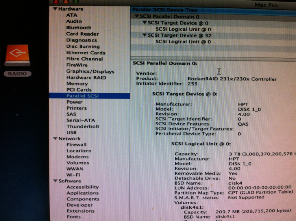

djfremen Posted October 5, 2012 Author Share Posted October 5, 2012 Ended up using an old 64 bit driver. Now it sees it as parallel SCSI. (See Attached) 1 Link to comment https://www.insanelymac.com/forum/topic/283376-solved-rocketraid-2300-not-working-in-mountain-lion/#findComment-1858278 Share on other sites More sharing options...
