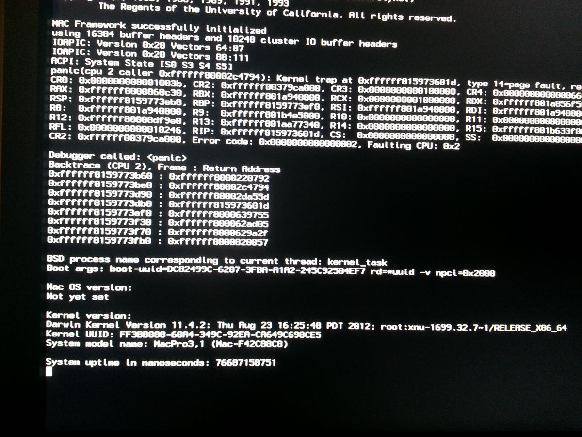

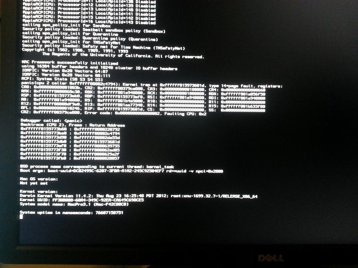

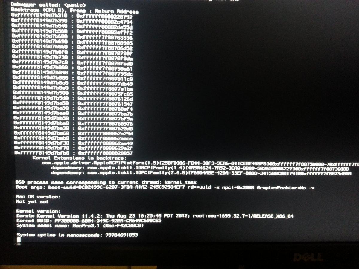

aspin Posted September 29, 2012 Share Posted September 29, 2012 I'm having a hard time understanding the cause of the kernel panic. Even with npci=0x2000 GraphicsEnabler=No flags in place, the kernel panic still occurs. The last action I took was unchecking "Update to 10.7.5" and then running the rest of the updates before issuing a reboot. My fears are that after a long day of writing code, perhaps my brain was too slow to realize that I did indeed initiate a 10.7.5 update? If the system wasn't updated, then I'm at a complete loss as to what could have triggered this. Here's another shot, slightly less blurry.. An attempt to boot into safe mode produced a slightly different error message: PS: I was running 10.7.4 prior to this "possible" update Link to comment https://www.insanelymac.com/forum/topic/283223-need-help-identifying-cause-of-kernal-panic-pic/ Share on other sites More sharing options...
rockinron_1 Posted September 29, 2012 Share Posted September 29, 2012 I'd try rolling back appleacpiplatform given that that is the kext causing the panic inn your last sceenshot See here if you don't know how it. http://forum.osxlatitude.com/index.php?/topic/1533-guide-getting-1074-and-1075-to-work-on-supported-models/ Link to comment https://www.insanelymac.com/forum/topic/283223-need-help-identifying-cause-of-kernal-panic-pic/#findComment-1856766 Share on other sites More sharing options...
